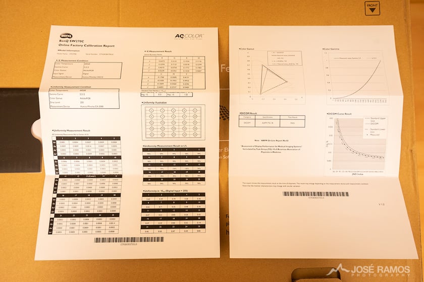

Just like with the SW2700PT and the SW240, BenQ includes a specific calibration report for each unit, showing proof that it meets the advertised standards for color uniformity and color space coverage—it’s a nice touch.

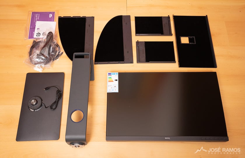

The package included all of the items needed to use the monitor, including the fully adjustable stand, user manual, cables, power cord, the monitor (duh!) and a monitor hood. I was afraid the new SW270C would not include a monitor hood, as it was present in the SW2700PT but absent in the 24-inch SW240.

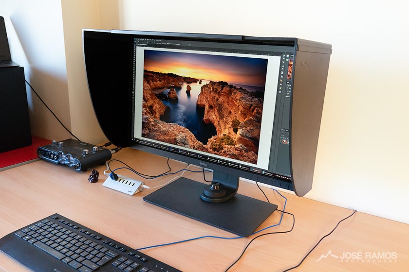

After setting everything up, it was time to put the screen in my desk. At a first glance, the plastic material looks different from the SW2700PT, with more of a dark gray tone like the SW240 as opposed to the solid black used in the SW2700PT.

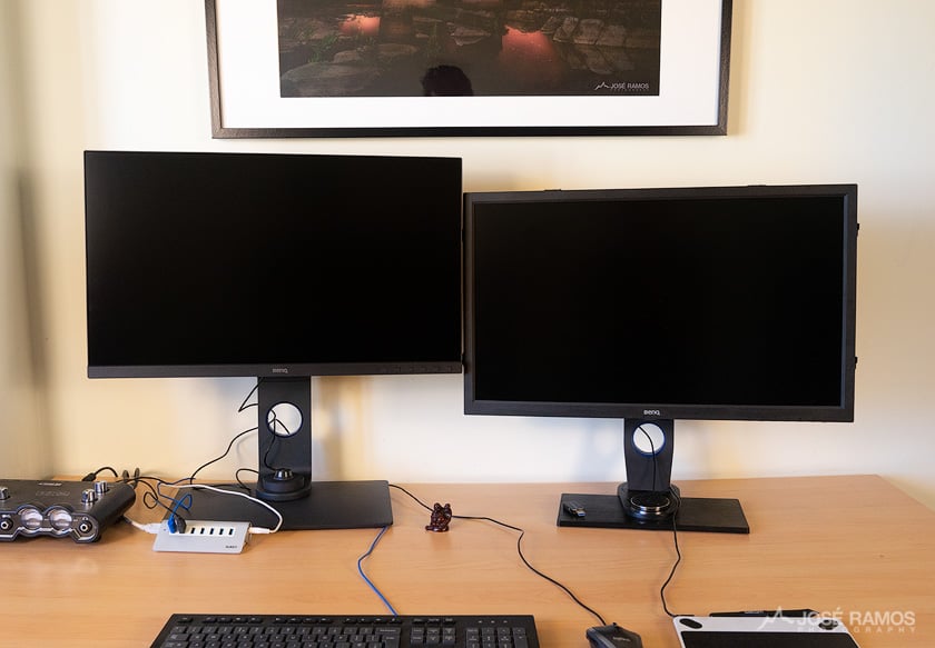

Even though BenQ mentions that the stand has an improved design, being more minimalistic, I found the footprint of the old SW2700PT stand to be much smaller, occupying less space on the desk without sacrificing stability.
BenQ SW270C on the left and SW2700PT on the right
On the other hand, the new SW270C is almost borderless, which is great when putting it right next to another SW270C, creating the illusion of a continuous workspace.

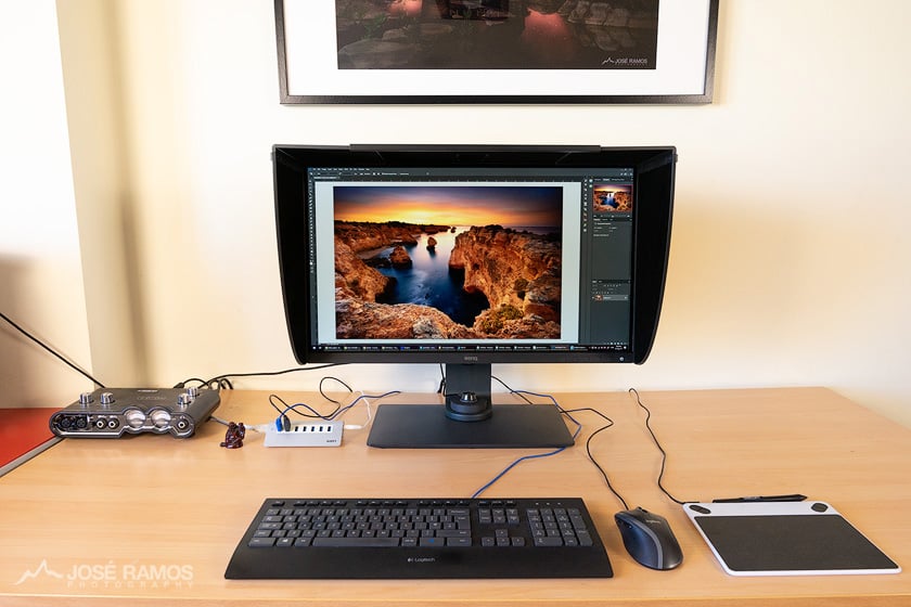

Just like with the previous model, the SW270C stand is fully adjustable, with just one difference: the screen can be placed considerably higher than was possible with the SW2700PT, but it will not descend as low.
Considering my two workspaces—my room and my living room—and considering the large size of these screens—where your eyes should ideally be pointing slightly downwards when looking all areas of the monitor—I prefer the range of adjustment of the previous model, as I usually set it quite low, which is not possible with the new SW270C.
BenQ SW270C and SW2700PT maximum height

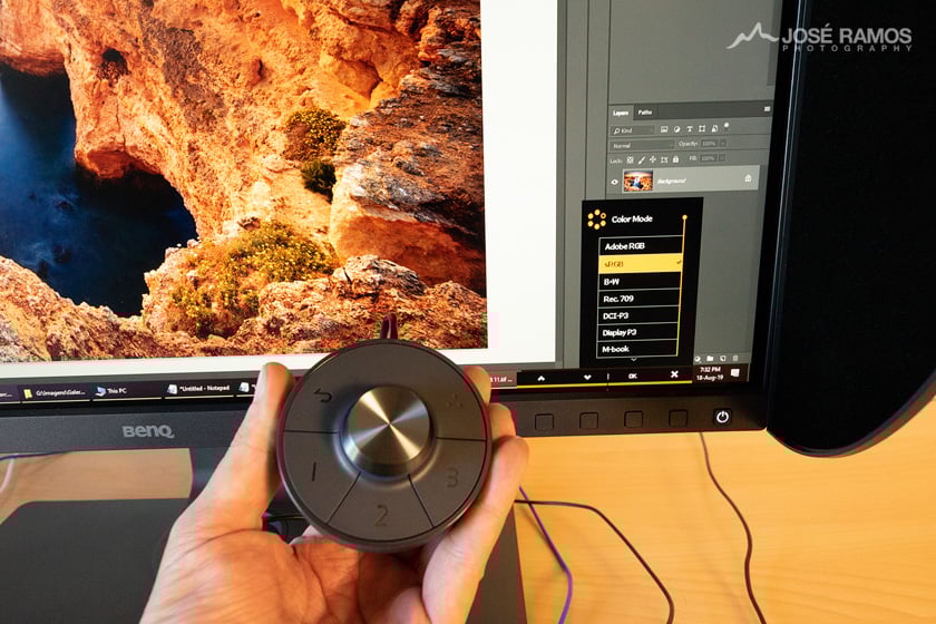

Just like with the previous model, you can adjust your working color space on the fly, with several different options to choose from according to your needs. The monitor also has a huge amount of other options to customize, which will satisfy even the most picky of users. Additionally, the HotKey Puck has been greatly improved, making it a very convenient solution to change monitor options in a more intuitive way.
BenQ SW270C color space modes
BenQ SW270C new hotkey puck

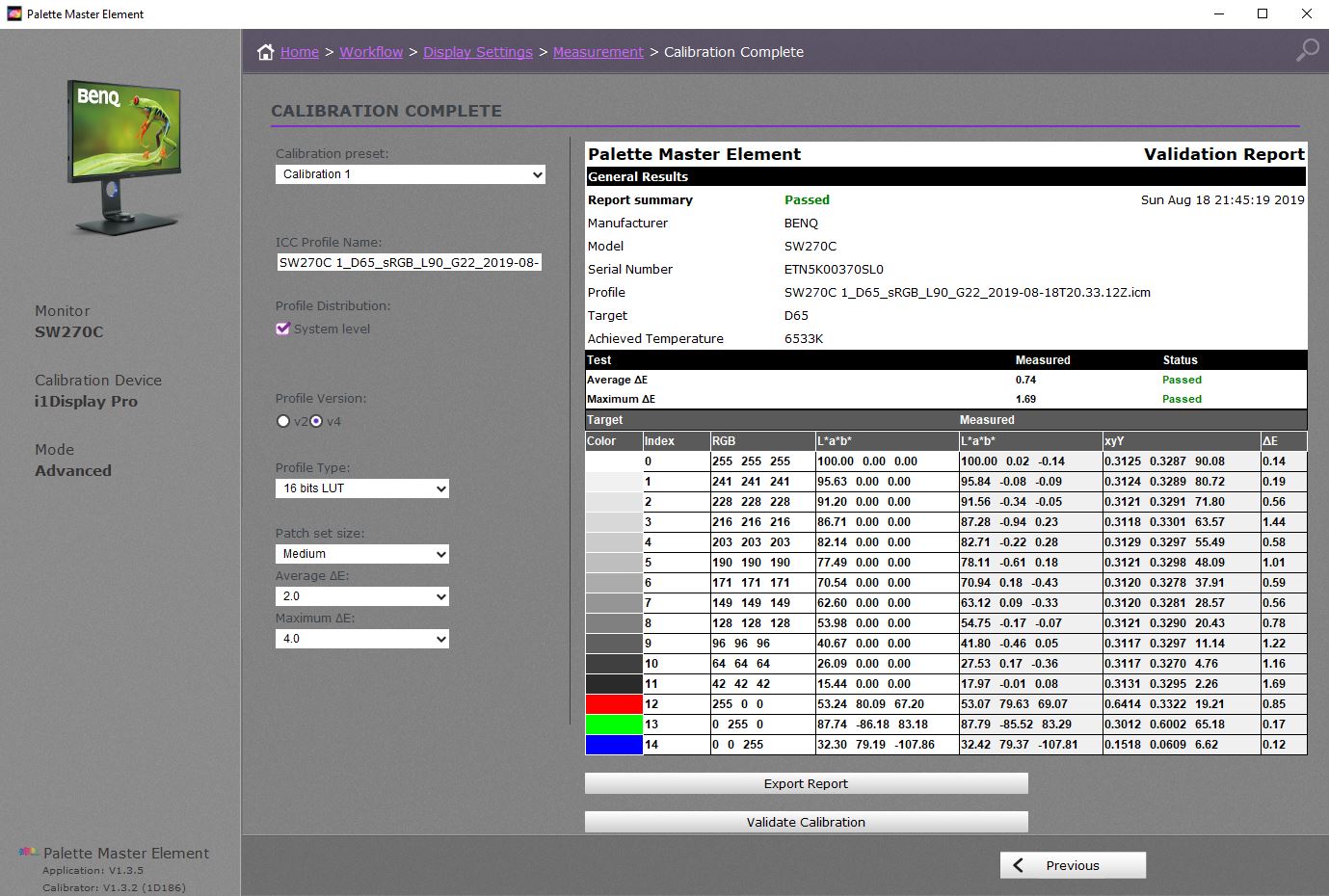

Even though the screen comes calibrated from the factory, which is great for those who do not have a hardware calibration device, I always calibrate my monitors with my X-Rite i1 Display Pro. So, after setting up the monitor and connecting the X-Rite to the BenQ, it was time for the most important part of this test: hardware calibration and calibration validation and testing.
After running all the tests at different color spaces and levels of luminosity, I’m very happy to report that the SW270C passed with flying colors (no pun intended). Not only did it demonstrate great luminance and color uniformity in all areas of the screen, but it also boasts low Delta-E values for color reproduction!

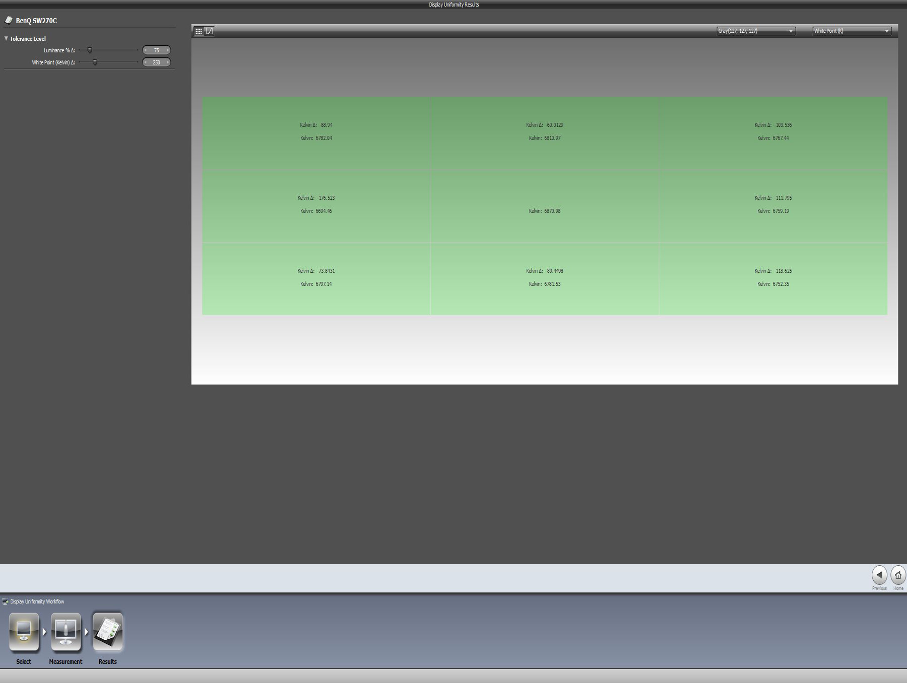

Sometimes we wonder if the advertised features are just marketing, but I tend to believe that the new BenQ Uniformity Technology is really making a difference here, being an improvement over the previous unit, and I hope the results will stand the test of time as more and more photographers start using this monitor.
Calibration Validation – Palette Master Element Software
Uniformity Validation – X-Rite Software
BenQ SW270C Uniformity Luminance (White)
BenQ SW270C Uniformity Luminance (Gray)
BenQ SW270C Uniformity Luminance (Dark Gray)
BenQ SW270C Uniformity White Point – Color Temperature (White)
BenQ SW270C Uniformity White Point – Color Temperature (Gray)
BenQ SW270C Uniformity White Point – Color Temperature (Dark Gray)

There is also one important piece of this monitor kit, which was so simple to install and remove that I almost forgot to mention it: the new Monitor Hood.
Working with a monitor hood is important to avoid unnecessary light contamination coming from outside sources, affecting the way you perceive your images. If you are one of those people who every now and then change your monitor to a new place, transport it to remote destinations, or want to simply put it side by side with another SW270C, then the monitor hood should be as easy to mount as it is to remove.
Unfortunately, removing the Monitor Hood on the previous SW2700PT made me absolutely nuts, as it was not only difficult to mount, but was also almost impossible to remove. Thankfully, this has been extremely improved on the new SW270C—you can now mount the hood in 60 seconds, and remove it in the same amount of time.
