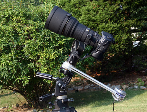

Astro Tracer with the built in GPS and sensor shift
The K1 comes with a built in GPS and together with the sensor shift shake reduction system, Pentax has added plenty of cool tricks to it.
It comes with an Astro tracer feature which allows shooting of celestial bodies for longer periods than what is usually possible and at better settings.
This is up to 5mins, which is typically enough for most uses.
Considering that it does it without adding any large tracking mount like a conventional system, its actually quite a big deal.
