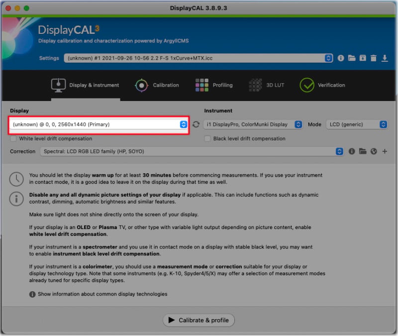

Calibration Issues
The most obvious issue you’ve probably already run into when using an M1 Mac with a color-accurate monitor is calibration. Up until the end of April, it was basically impossible to calibrate a monitor while it was hooked up to an M1 Mac, no matter what software you used. Based on our research, the issue has to do with some required security drivers that basically made it impossible for profiling software like XRite’s iProfiler and DataColor’s SpyderX to detect a connected display.
How to Fix Monitor Calibration Problems on M1 Macs
Fortunately, this problem has been largely fixed by the big guys: XRite released an M1 compatible version of iProfiler in April, and DataColor followed suit in mid-June with updated versions of the SpyderX Elite and SpyderX Pro software.
Unfortunately, the issue hasn’t been totally resolved by everybody. This change to Apple Silicon has made it even harder for monitor makers to release Mac-compatible versions of hardware calibration software. Even when there is a Mac version available, it probably hasn’t been updated to work with M1. This is what happened to PetaPixel reviewer David Crewe last month when he tried using ASUS’ ProArt Calibration software to hardware calibrate a new display he purchased for personal use:
If hardware calibration is a must for your workflow, do your research and make sure the manufacturer’s software is compatible with M1. BenQ, for example, has released an updated version of its Palette Master Element software that should work, but they’re the exception, not the rule. Most monitor makers either don’t have a Mac version at all, or they haven’t released one that’s compatible with both Intel and Apple Silicon.
