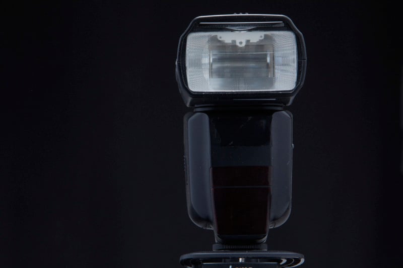

The first flash most photographers buy is a speedlight. It’s a no-brainer for beginners: with its compact size and considerably larger light output than built-in flashes, it seems like the next step in being more “pro.”
A speedlight is always battery-powered, small, portable. Due to the size and battery power, it produces a fairly low light output when compared to studio strobes. Don’t expect to be able to light up a large scene using one speedlight. An average speedlight might have 70W of power, while a studio strobe can have 500W or more.
Speedlights (and some studio strobes) have TTL, which is Through The Lens metering. It allows setting light power automatically, which saves time in some cases. Another feature is zoom — almost all speedlights have a zoomable head. This can be handy when you’re using a telephoto lens and need to cover a small area at 180mm rather than wide at 18mm
A great niche feature of the speedlight is its extremely short flash duration at low (1/4 or less) output. Still-life photographers may tape four or even six of them together to be able to freeze motion. What is less welcome is wild output and color inconsistency shot to shot. Interfaces can be confusing too.
Due to its small size and low output, it often doesn’t make sense to use speedlights with light shaping tools. Small softboxes, bounce cards, or gels are among the only options you may have. More commonly photographers will bounce their speedlights against a wall, ceiling, or other large surfaces.

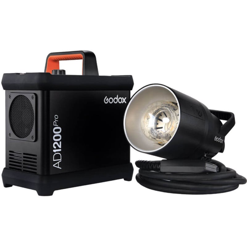

Battery-Powered Pack-and-Head
A battery-powered pack-and-head system is one of the best on-location choices if you want to have decent power and no heavy lights up in the air. Some great options are Broncolor’s Move pack that has 1200W of power.
Because the head is lighter than a speedlight, it isn’t a problem to hold for long periods of time. Moreover, compared to a similar monolight system, the pack-and-head will recycle a lot faster.
A drawback would be a lack of range. If you’re using multiple lights from one pack, the cable length will restrict how far you can have them. Batteries tend to be very heavy for these too, but if you are shooting at half the power (600W), you get an impressive amount of flashes compared to a similar monolight system.
Another drawback is that adding lights eats up power. For example, if a pack is rated at 1200W and has two sockets, it will distribute that power over the number of lights connected. One light at full power can output 1200W, but add a second one, and that 1200W is cut into a ratio you pick. Suddenly maximum power from each socket is reduced.
