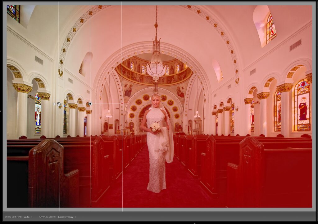

I want to darken each side of the church to the left and right of the bride, When I dragged this linear gradient out on the it masked way too much – the mask goes right over the bride, so she’ll be darkened when I lower the Exposure amount.

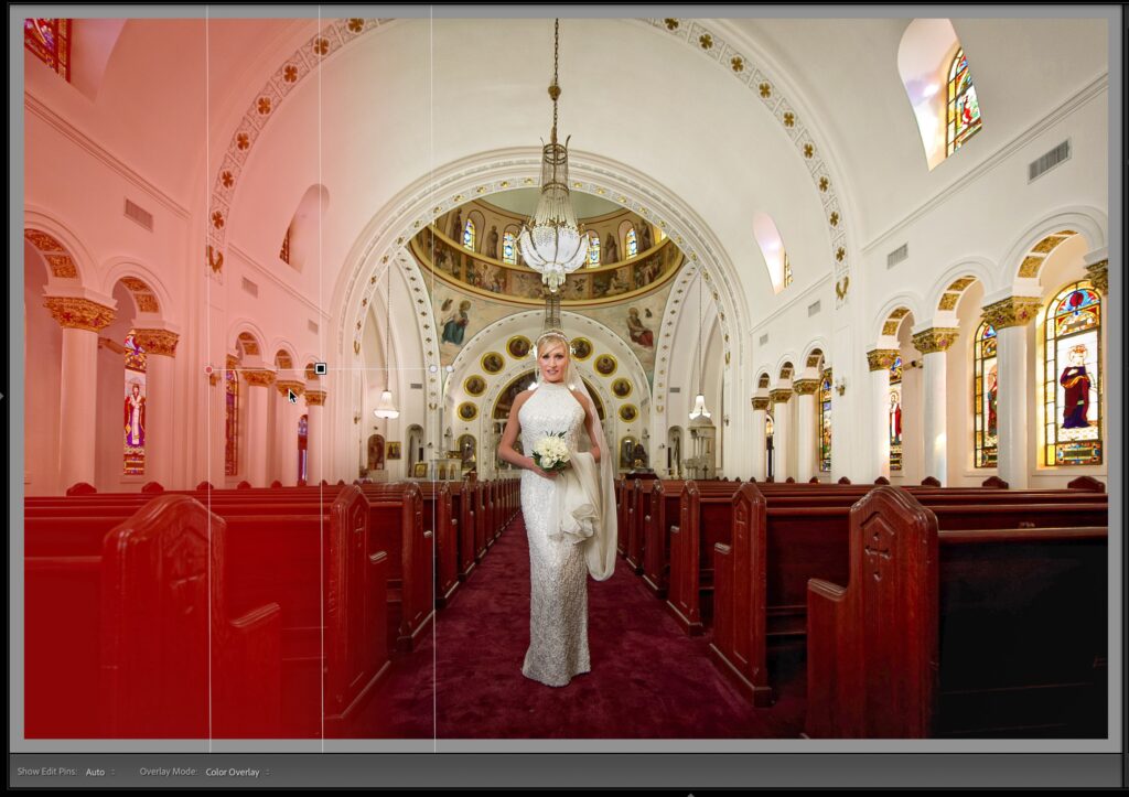

The tip is: just press the apostrophe key on your keyboard (to the left of the Return key), and it flips the gradient for you, like you see below.
![Grad2-1024x723.jpg](/proxy.php?image=https%3A%2F%2Flightroomkillertips.com%2Fwp-content%2Fuploads%2F2024%2F02%2FGrad2-1024x723.jpg&hash=62fa7ad01f8b440d0ed858dd9a7f261c)
Ahhhh, that’s more like it. Now, when I lower the exposure, it is just the left side of the church that gets darkened, and it graduates to transparent where the bride is in the center aisle (see below, where I did both sides).
