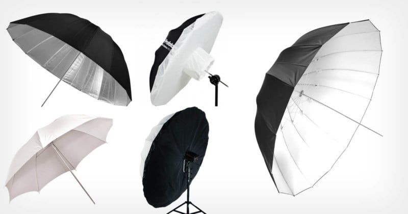

Common Types of Photography Umbrellas

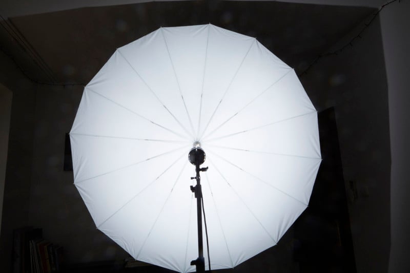

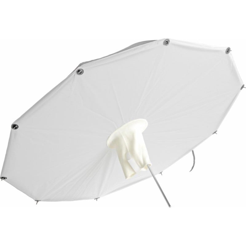

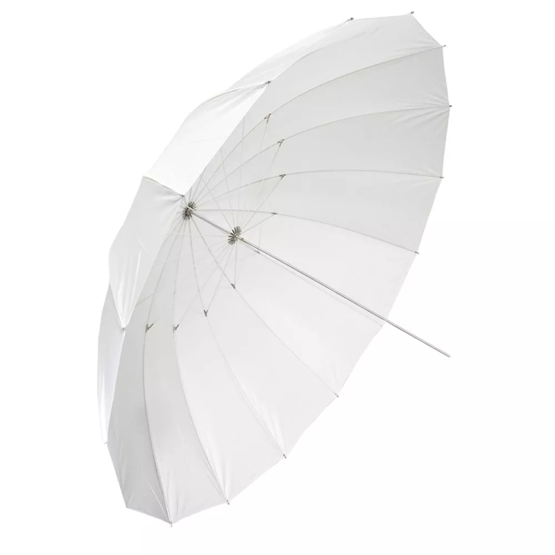

Shoot-Through Umbrellas
These are the first umbrellas to ever exist. They are made out of translucent diffusion fabric that will diffuse the shadow edges, and depending on the size a shoot-through umbrella will produce light of different softness. The smaller the umbrella the harder the light. A shoot-though umbrella will create a hotspot in the middle as the light source is aimed directly at the subject.

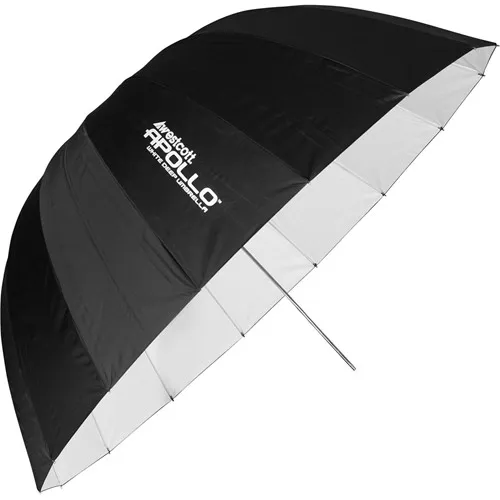

White Umbrellas
A white umbrella will be indirect and will require the light to first hit the umbrella, bounce in the modifier, and exit on the same side. As such, this light source creates an indirect bounced and diffused light. Depending on the size, your light can also be quite soft. The light spread of white umbrellas will be quite large when compared to silver ones. These are a common choice among portrait and fashion photographers for the light they produce.

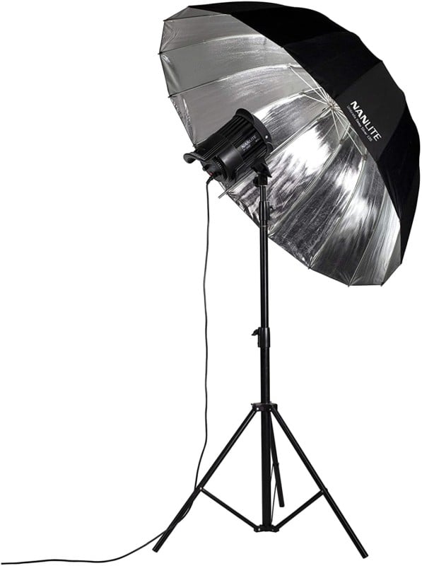

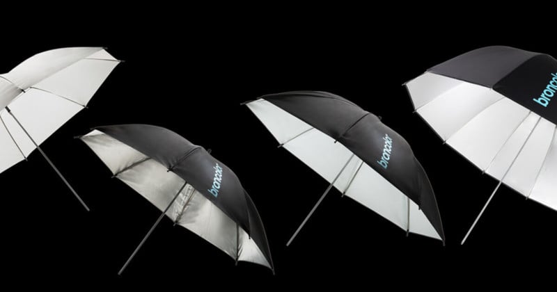

Silver Umbrellas
These reflect light and have a smaller light spread which creates light with more direction. Because they reflect instead of bouncing a silver umbrella will be more efficient. That is why on-location a silver umbrella is more preferred than a white one. In small sets, it will appear to produce harder light, which is why a silver umbrella is best used will a fill light in smaller studios.

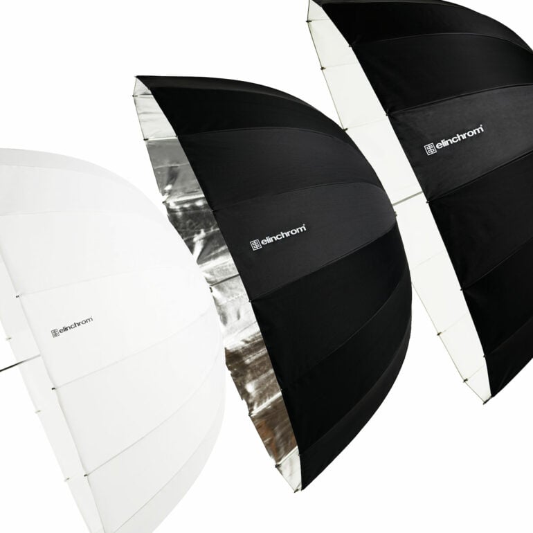

Deep vs. Shallow
Nowadays there are two common shapes for umbrellas: deep and shallow. Shallow umbrellas will create a much wider light spread, which is useful when lighting large groups, backgrounds, or even portraits. Deep umbrellas on the other hand will have more direction to them which will result in somewhat increased contrast.

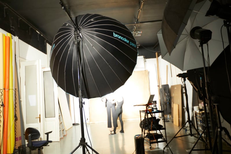

Deep umbrellas have the ability to be focused to some degree. But don’t be misguided when a company claims to have parabolic umbrellas. Those are impossible to create if they are truly parabolic. A deep-looking modifier isn’t parabolic, if anything it’s false advertising.

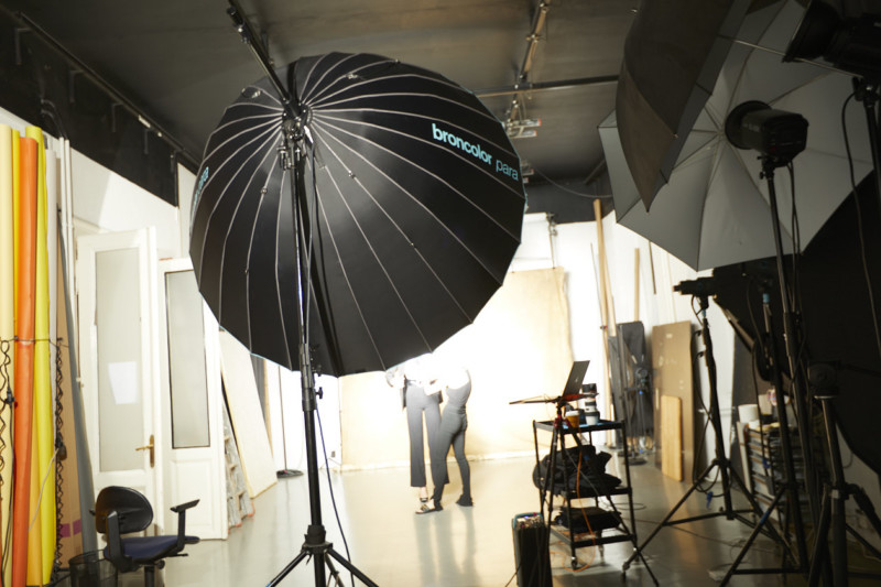

I personally use both deep and shallow umbrellas, almost interchangeably. Shallow ones tend to be cheaper. If you want to experience true parabolic modifiers, rent a Broncolor Para or Briese.

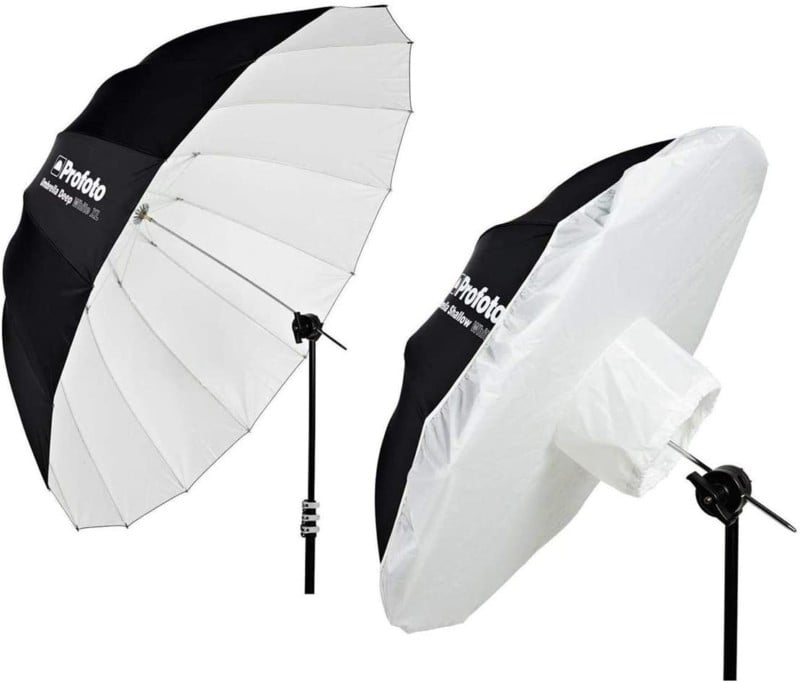

Diffusion Fabrics
Contrary to popular belief these won’t make the light softer, they will however diffuse the light — the difference between soft and diffused being a topic for a separate article. A diffuser is great in combination with a silver umbrella as it increases the light spread. Another way to use a diffuser is with a white umbrella if you want to create incredibly soft and diffused light that has a wide spread, and is flattering to the face. Annie Leibovitz has been known to use this very frequently on her portrait shoots.

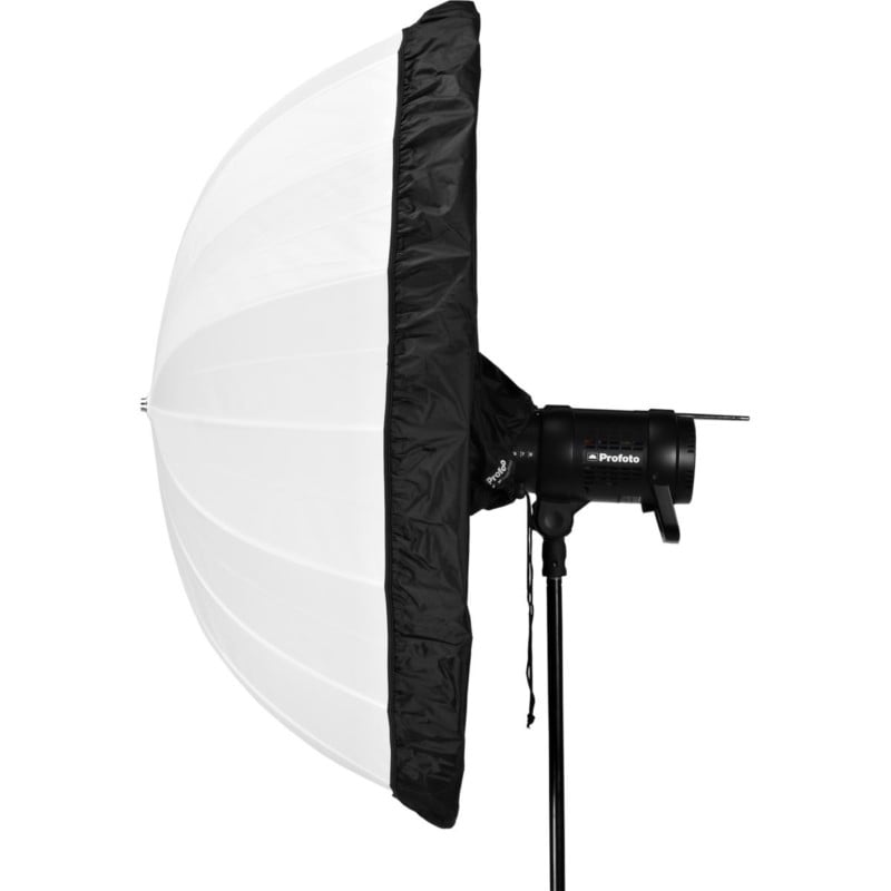

Backpanel
Translucent umbrellas don’t only pass light through but also bounce some back. This is undesirable as it creates an unnecessary light loss. Therefore, a back panel can be added to a translucent umbrella that will contain and reflect the light going in the wrong direction.
