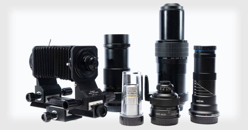

For a long time, there weren’t many options for high magnification macro photography without resorting to solutions like lens coupling and reversals. The only lens on most photographer’s radar was the Canon MP-E 65mm f/2.8 1x-5x Macro. There were also other options, however, so let’s take a look at how the MP-E 65 compares to more modern and vintage lenses to put to 5:1 magnification and beyond – using a butterfly wing.
There are six lenses in this test:

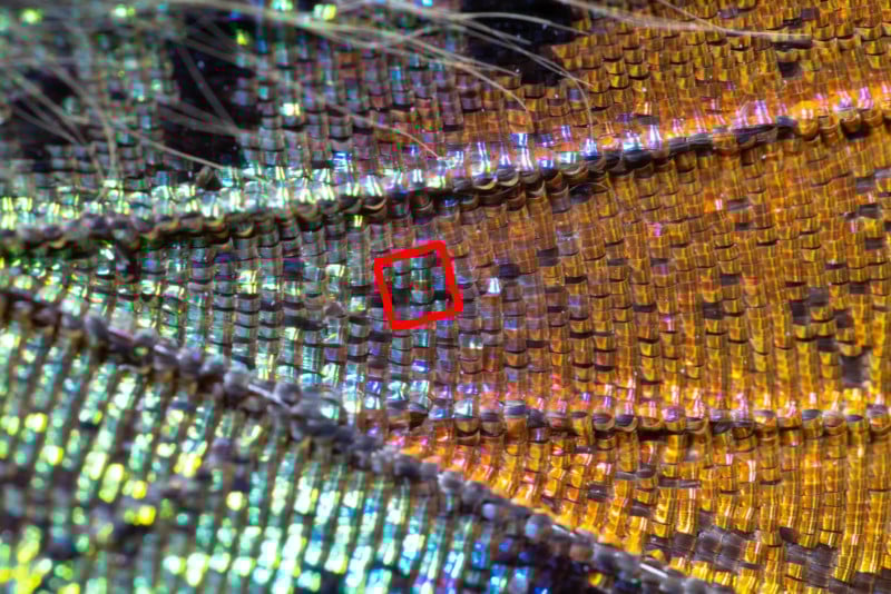

This test involves a portion of the wing from a Chrysiridia rhipheus, the Madagascan Sunset Moth. Chosen for this experiment because it has color scales that transition quickly and vibrantly from one hue to another in a specific area of the wing. The scales also have small lines running down their length, making for a very good test of optical resolution.
In order to test resolution, each lens is shot both wide open and stopped down to f/5.6. All lenses capable of shooting at 5x were set to that, and others were scaled to that size for a more direct comparison.

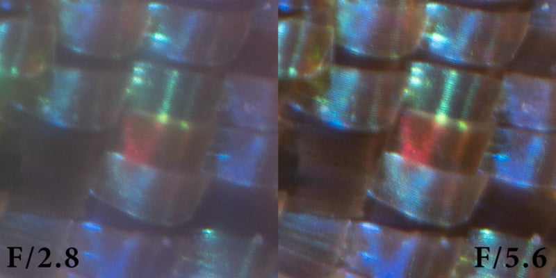

A workhorse of a lens, one of my favorite macro lenses ever, but a design that has no modern technology – originally debuting in 1999. Still, it’s the benchmark in this test. We can see plenty of detail and good color rendition, and the lines on the scales are clearly visible. While there is some degradation of detail when stopped down slightly, this is due to diffraction.
Page 8 of the manual for this lens gives a handy conversion chart from dialed-in aperture to effective aperture, which changes as magnification increases. f/5.6 at 5:1 magnification is actually f/33.6, which would be diffraction limited on the 47MP sensor that these images were taken with. No fault of the lens – we’re just bending light too much.

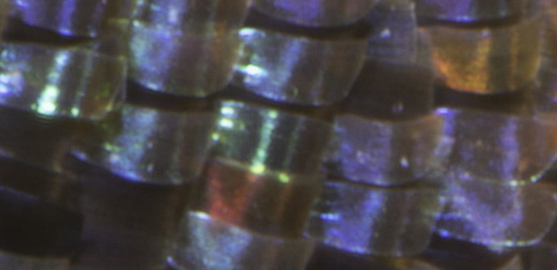

Wide open, it’s… it’s the worst macro lens I have ever tested. By a large margin. It’s foggy, blurry, hazy, and just wrong. Stopping down to f/5.6 helps a little, but this is where diffraction will start to claim quality in the best lenses. Even when stopped down, it’s still the worst lens, and for curiosity’s sake I also shot it at f/11 to see how things progressed:
It continued its downward spiral. I’m having a hard time believing how bad this lens is. I have talked to a few others who have recently received theirs, and it’s not just my copy. Do not buy this lens. Zhong Yi, what were you thinking?

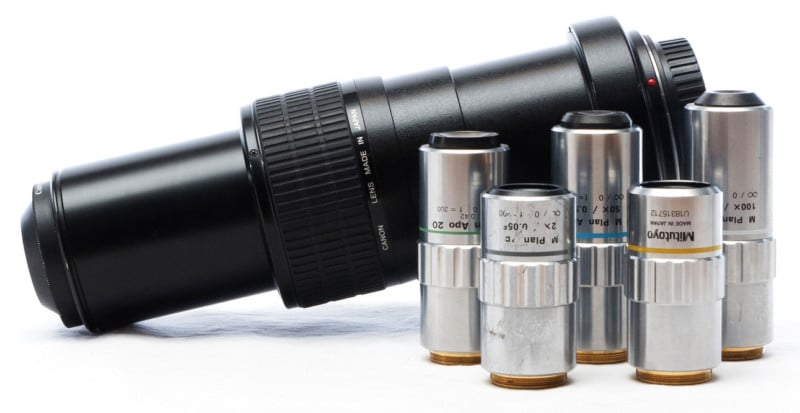

Mitutoyo Plan APO 10x Microscope Objective
There are a lot of high-magnification macro photographers that will state that anything beyond 5x should be handled by a microscope objective. I tend to disagree in terms of usability, especially when shooting handheld as these objectives have such a drastically thinner depth of field in comparison, but that’s where the increase in resolution comes from.
Mitutoyo makes these objectives at 1x, 2x, 5x, 10x, 20x, 50x and 100x, but they aren’t often considered when people want a macro lens. Why? Most people don’t know how to attach them, but the process is incredibly simple:
First, get a regular lens that covers 200mm. All of these “long working distance” objectives from Mitutoyo state “f=200” on the barrel, but not that this number might be different with other lenses. I didn’t have a 200mm lens, so I invested $20 in a Canon FD 200mm f/4 on eBay. You’ll just need a step-down ring from whatever your filter thread size is, to M26. You’re done.

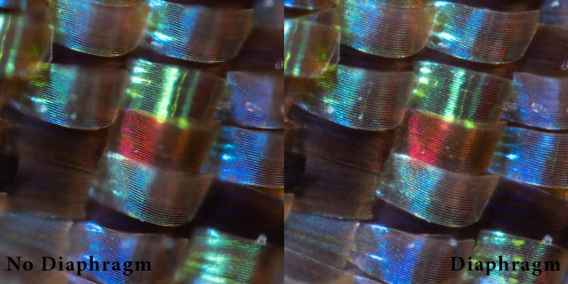

Set the 200mm lens to focus on infinity, and you can now shoot with your camera as if it’s a microscope. You can even add your own aperture diaphragm between the two lenses to sacrifice optical resolution for a greater depth of field – and you’ll want to keep the aperture inside the camera lens always open regardless.
Note: In the about image you can see a Canon MLA-DC1. This was originally designed for G-series cameras to mount a ring flash to them. It’s glued to the step-down ring to allow the mounting of a ring flash around the microscope objective.
The incredibly thin depth of field here makes it very difficult to handhold the camera. I’ve photographed snowflakes handheld at 20x and it was one of the most difficult things I’ve ever had to do with a camera in my hands. Being locked down on a tripod with a focusing rail is the best way to go here! Also – don’t buy a new objective. There is plenty of second-hand inventory often close to half of the retail price.
