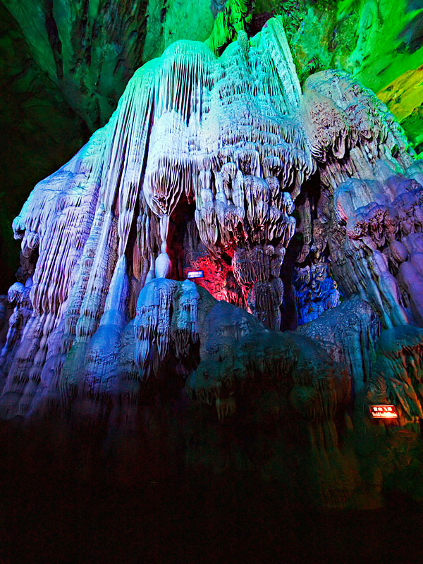

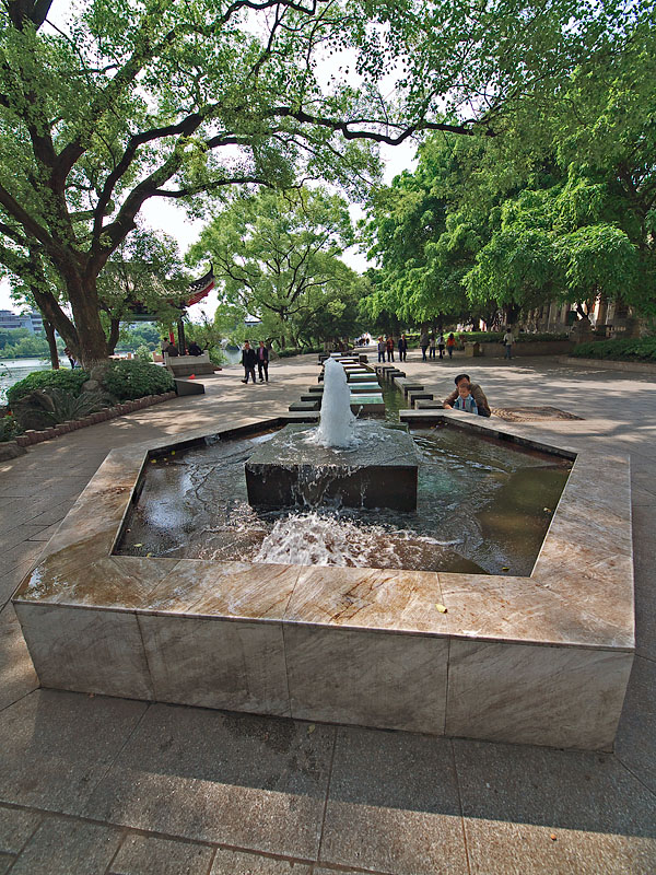

The ZD 7-14mm is a useful lens for travel photography. I find that the 11-22mm is sometimes still not wide enough in some situations eg. when you can't move back any further, or when you are in a very big hall or in a cave. Nowadays, I find that 2 lenses wouls suffice most of the time for my travel needs - the Leica 14-50mm and the ZD 7-14mm for normal and wide angle shooting. The ZD 11-22mm is hardly ever used.
Then again the ZD 11-22mm could not have produced these images either in such a situation or with such a look. These were taken with the ZD 7-14mm at 7mm during my recent China holiday trip.
