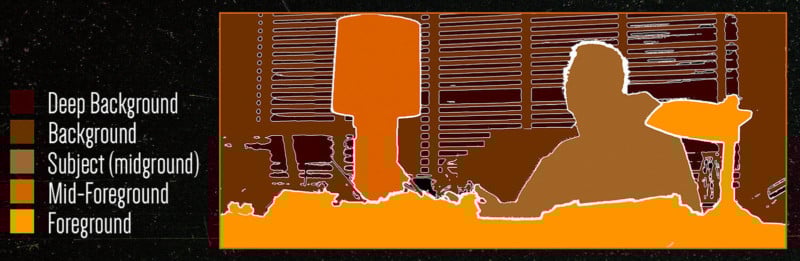

Take a look at the office scene below where we see impeccable lighting throughout a very detailed shot with a lot of depth and including multiple layers of foreground and background. Pay careful attention to how the important aspects have a lot of shape and form and how less important elements have very limited form.
Scene from ‘Se7en’ 1995
See how we have multiple foreground and background layers? See how the deep foreground and deep background don’t really have any form to them whatsoever? The black boxes in the foreground are just dark shapes and the widow blinds behind are the same.
Let’s break it down visually and see how they’ve managed to light what could have been a very visually busy and complex scene.
Breaking your shot down into layers like this can help you to visualize what’s important in the scene and what’s simply there to help sell the story within it. Make sure your subject has a lot of shape and form and then try to ensure other aspects of your image have less form to them. Doing this allows the extra detail that form provides on the subject to draw your viewer’s attention.

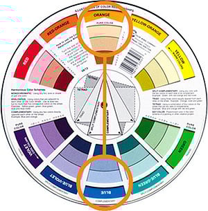

Contrast also applies directly to color too and a little knowledge of the color wheel and a basic grasp of color theory will help you here as well.
For example, an image can have contrast even if all lights within the image are the same exposure thanks to ‘color-contrast’. Take a look at the color image below and then look at that exact same image in black and white next to it.

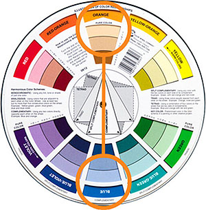

The strongest color contrast can be found via complimentary colors.
color contrast and using color theory to achieve it is an entire article in its own right, so although I won’t do a deep dive on it here (plus there are already loads of articles on my site regarding this subject already). Here are a few pointers to get you started.
Complimentary colors will give you the most color-contrast when using 2 colors and these are the colors opposite one another on the color wheel. Yes, you guessed it, orange and blue are the most popular complementary colors in cinema. From here, it’s really any color furthest from one another on the color wheel when adding multiple colors in the same scene. So for 3 colors like the image above, consider the triadic color theory, for 4 colors look for tetradic colors, and for 5 look at tertiary colors.

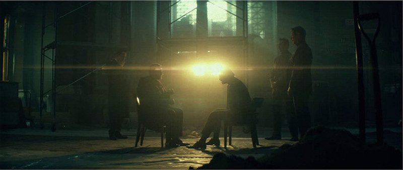

Scene from ‘Blade Runner 2049’ (2017)
There are a few key differences between fog and haze, but primary among them is the shape and texture of fog. Fog is far thicker in shot and is often used to light outdoor scenes as it will hang in the air longer. Fog machines are fairly cheap to buy and run too.
2. Haze
Scene from TV show ‘Peaky Blinders’
Compared to fog, haze appears far finer in shot and doesn’t clump and swirl like fog can. Thanks to this, haze is primarily used indoors to add volume to the light without dominating the scene. For indoor photography, I’d have to recommend haze every time, although the machines can cost a little more.
