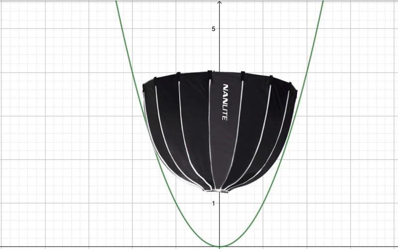

For example, let’s plot a parabola in Desmos and try to fit an image of a softbox that claims to be parabolic.
As you can see, we can’t fit the shape of this softbox to a parabola. Although they visually look similar, they will work in a completely different way and the laws of light won’t be the same as with true inverse parabolic modifiers.
I would stay away from buying parabolic-looking softboxes and umbrellas as they are a mere waste of money. Although they claim to produce deep light that is parabolic, all they do is take up valuable space and work inefficiently. Moreover, octa boxes of the same size will be more efficient and cost a lot cheaper. Just compare the amount of material needed to make a useless parabolic softbox and a simple octa.
