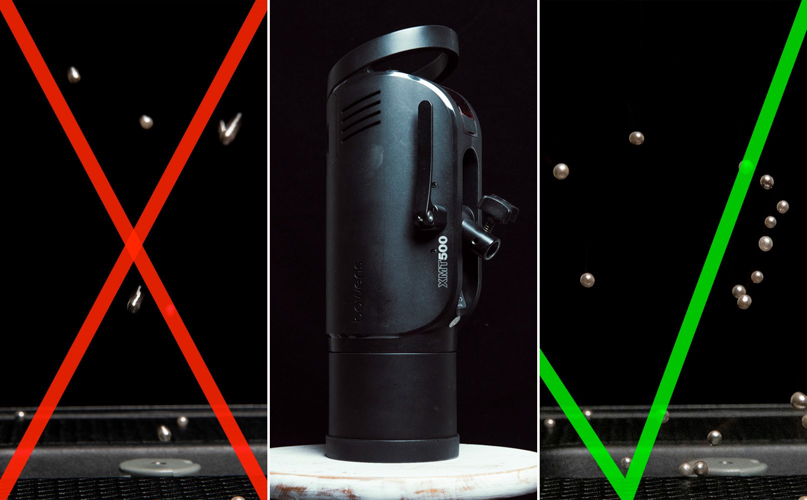

Take a look at the side by side shot below of me photographing some silver cake decorating balls falling onto a metal plate. Both of those images were taken with flash, but both display very different results. Your idea of ‘frozen motion’ may be different to somebody else’s.
Both images of metal balls in motion taken with flash, but both with very different results.

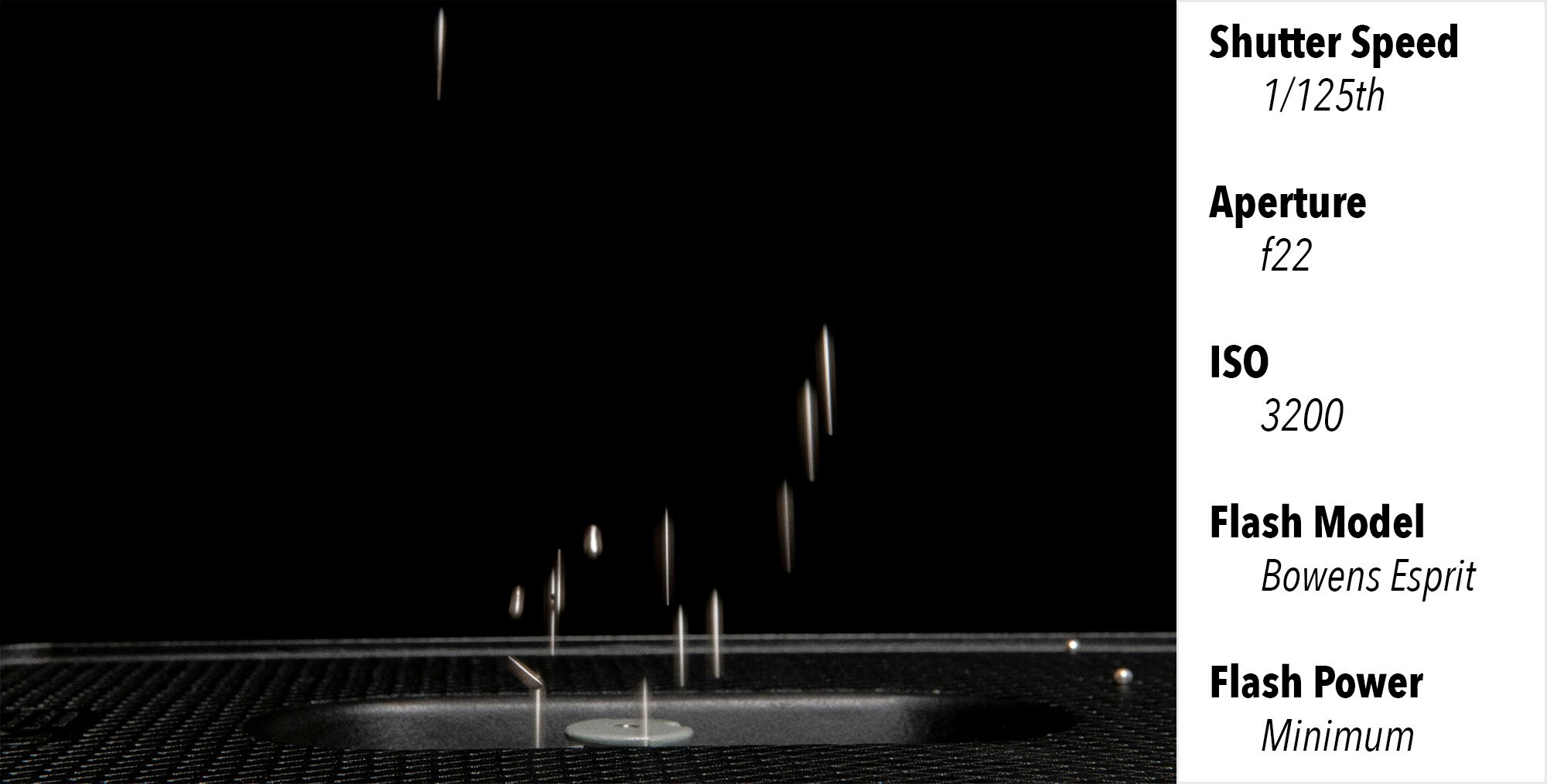

This is a pretty basic test and anybody can do it. Yes, there are plenty of very precise ways of measuring flash duration with sound triggers and infrared gates etc. but here I’m simply dropping silver cake decorating balls from a height of 3 feet onto a metal plate below and pressing the shutter with my finger. I tested a variety of strobes, including a speedlight, and I took shots with all of the flashes at max power as well as lowest power to show the differences.
My objective was to see movement in the objects, so I kept my aperture at a consistent f/22 to show as much in focus as possible. As a result of this high aperture, I adjusted the ISO dramatically on the camera to compensate for exposure differences in the strobes at max and min power.

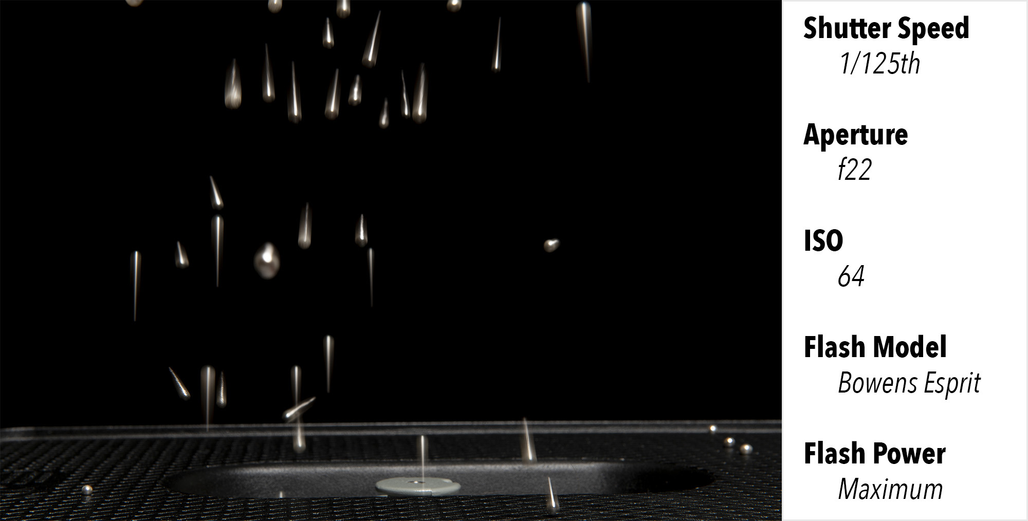

The Old

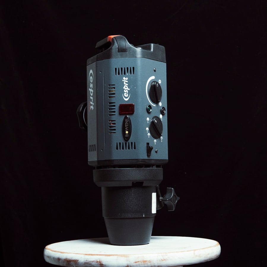

First I tested a very old flash head that is about 20 years old. This is an extreme case, and you’re unlikely to see results like this with any modern strobe, but I felt it might be useful for comparison.
The strobe in question was an old Bowens Esprit 500W head.
Many older strobes like this will produce movement blur at any strobe power, but in many cases you will get a clearer image at maximum power. If you look closely, you’ll see that at max power you get a ball outline and then a tail of motion. This is where the flash dumps a huge amount of power at first and then, as the gas in the tube subsides, you get that tail of movement that slowly disappears.
In the minimum power shot, the ball doesn’t have a clean edge that then tapers off; instead, you simply get nothing but blur. This is how many older strobes dealt with lower power outputs. You simply got the gas burn over a period of time compared to a quick, short dump of a little bit of power.
As I mentioned above, this is rare, as most modern strobes do not have this same way of releasing power gradually anymore. What I will say is that you will start to get this consistent blurred look with old and tired flash tubes. Essentially, the xenon gas within the tubes is getting tired and less efficient.
If you start to think your images are blurred a little at the edges, then consider doing a test like this to see if it’s the bulbs that need replacing.

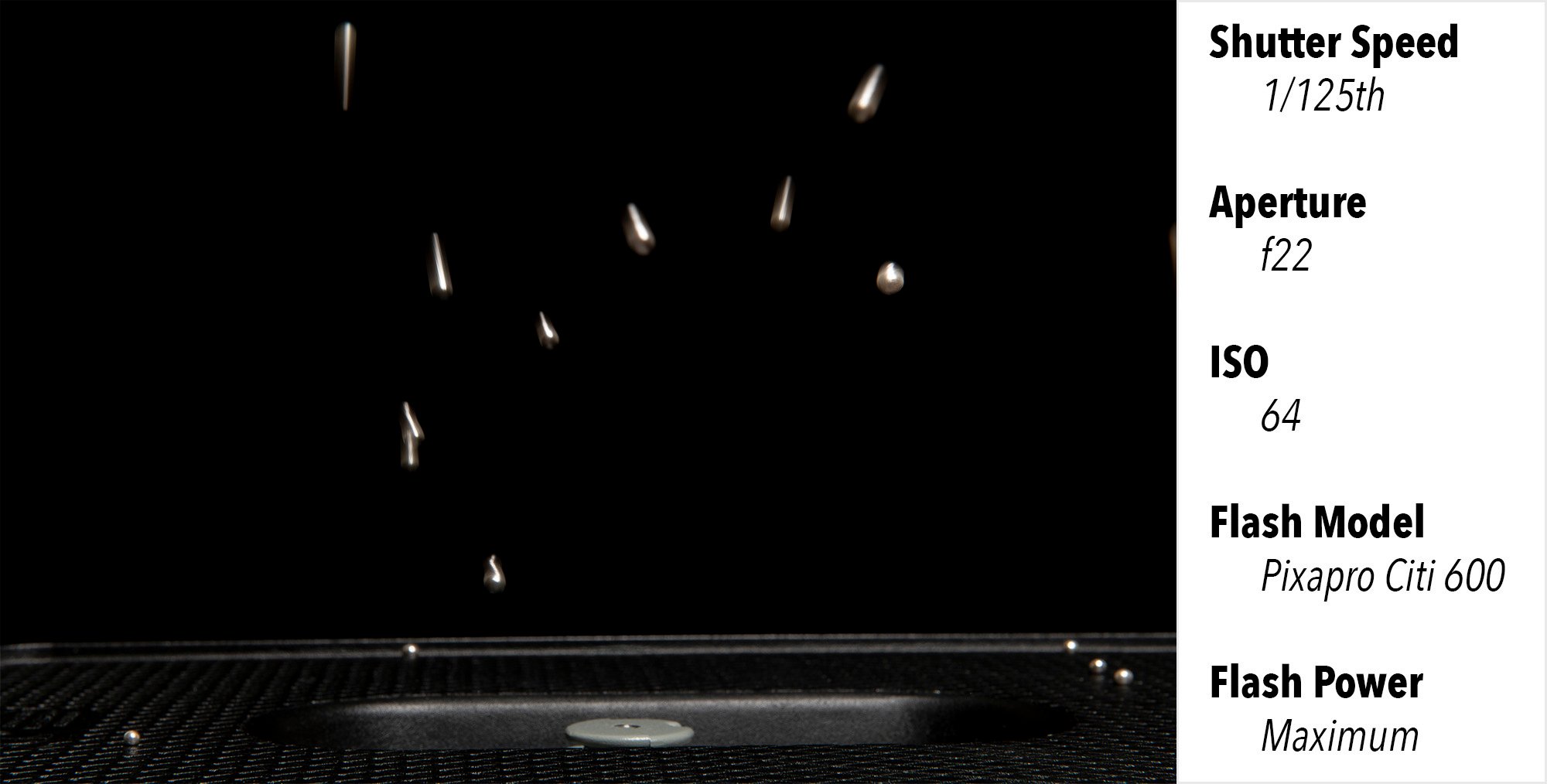

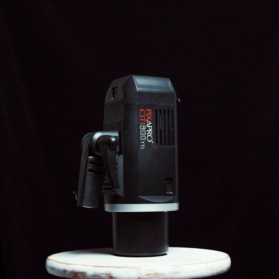

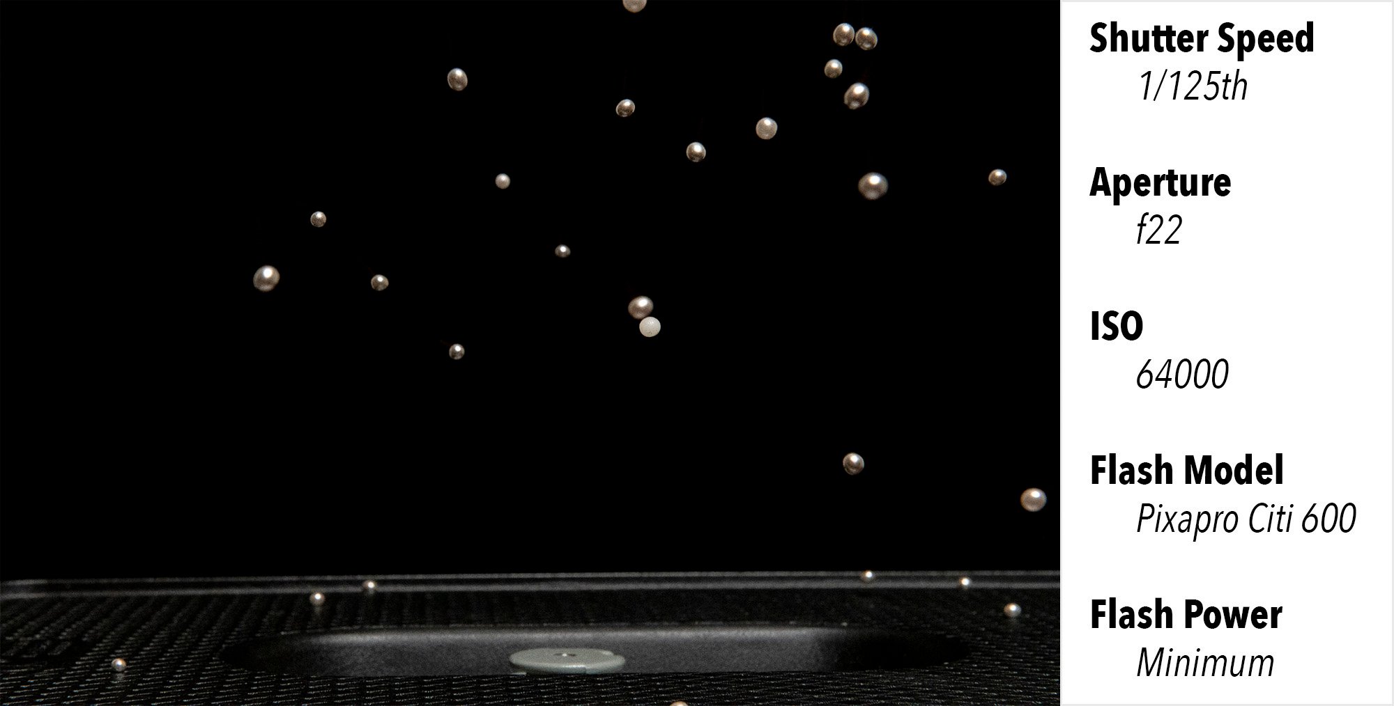

First up, let’s see one of the standard Godox heads; or, in this instance, the Pixapro Citi 600 TTL.
If you were curious, here’s the official number on flash duration from the online pdf for the Citi600. They very kindly show us min and max power durations and they tell us it’s T0.1. -top marks Godox for your transparency on this info.
The resulting images are a little more in line with what we’re used to seeing with flash, especially the minimum power shot. In that image the balls have been captured relatively cleanly and there is minimal blurring, especially when compared to the max power image.
In the max power shot, there is some blurring. Although it’s nowhere near as bad as in older strobes, I’d still consider that a problem for anything that is moving at any speed in your image.

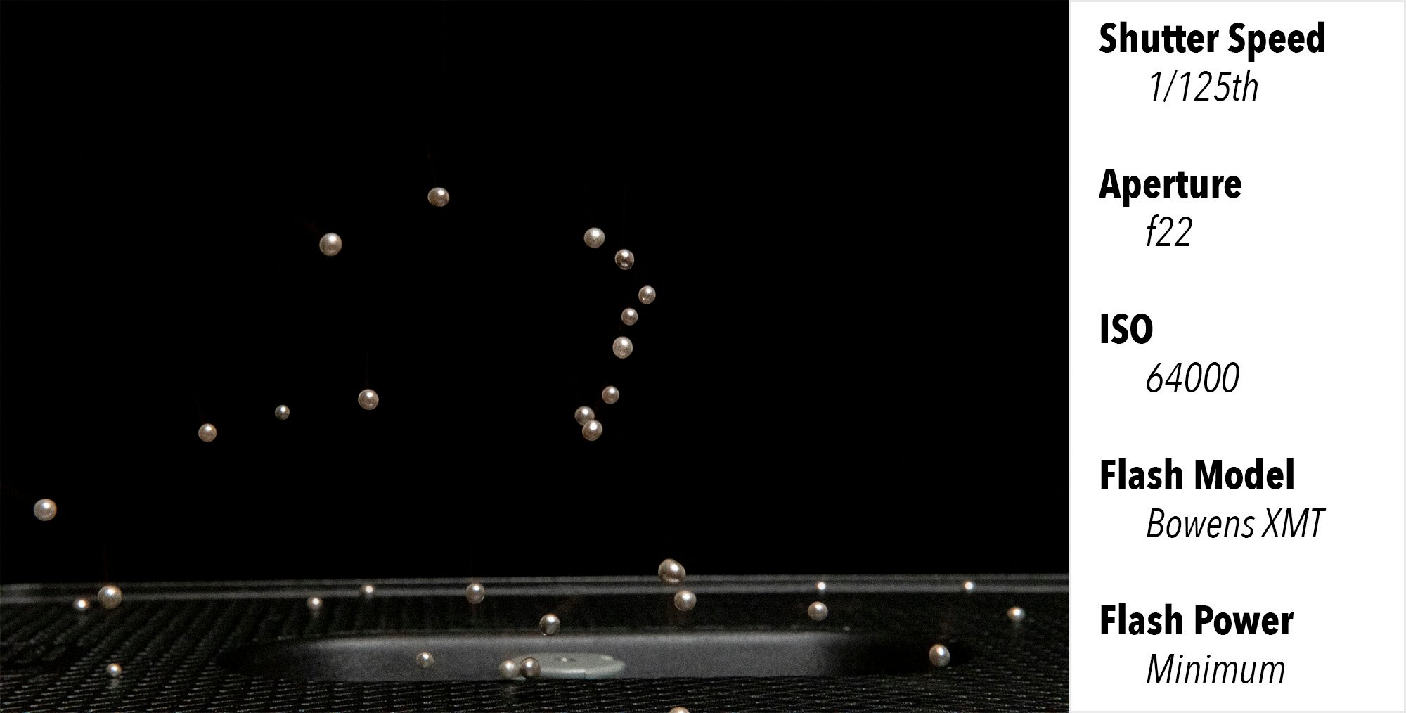

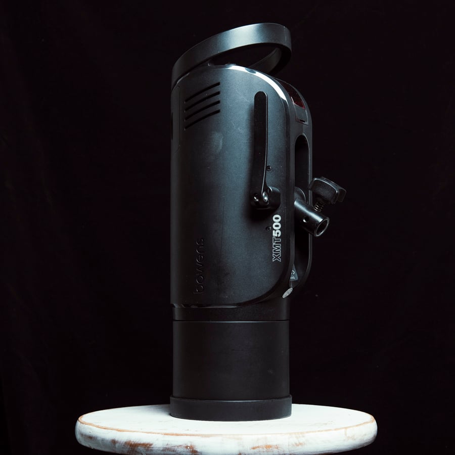

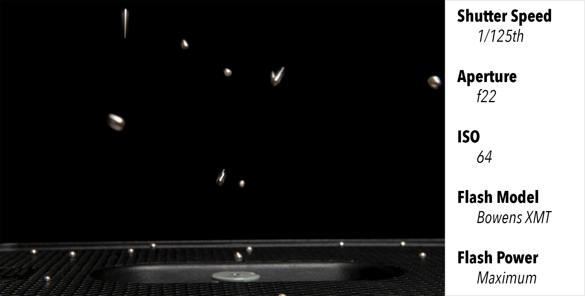

Next up, I tested my everyday workhorse strobes: the Bowens XMTs. These heads are 500W which is a fairly standard power output for most monobloc style strobes. In fact, all the strobes I tested here are monoblocs and if you’re not sure what I mean by that then take a look at the power pack explanation below.
To the well-informed among you, you’ll likely already know that the Bowens XMTs are made by the same company as the Citi 600’s mentioned above. The Chinese company Godox makes both of these strobes, albeit the Bowens manufacturing requirements were a little different and in my opinion a little stricter, resulting in a slightly more consistent head, but then the higher price would also reflect that.
Regardless, take a look at the resulting images below to see how it faired in this flash duration test at max and minimum power.

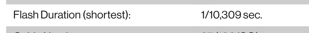

If you were curious, here’s the official Bowens statement from their online XMT pdf regarding flash duration. Naughtily, Bowens only quotes the fastest duration (lowest power) and they omit the T value. This usually means that it’s the t0.5 as that’s often faster and makes the strobe look better.
As always, I’ll let the images above do the talking, but as before, the max power shot shows significantly more blur than the min power shot. I’d argue that the XMT was marginally more consistent in producing cleaner, crisper shots at both max and min power, but like I said, it’s marginal.

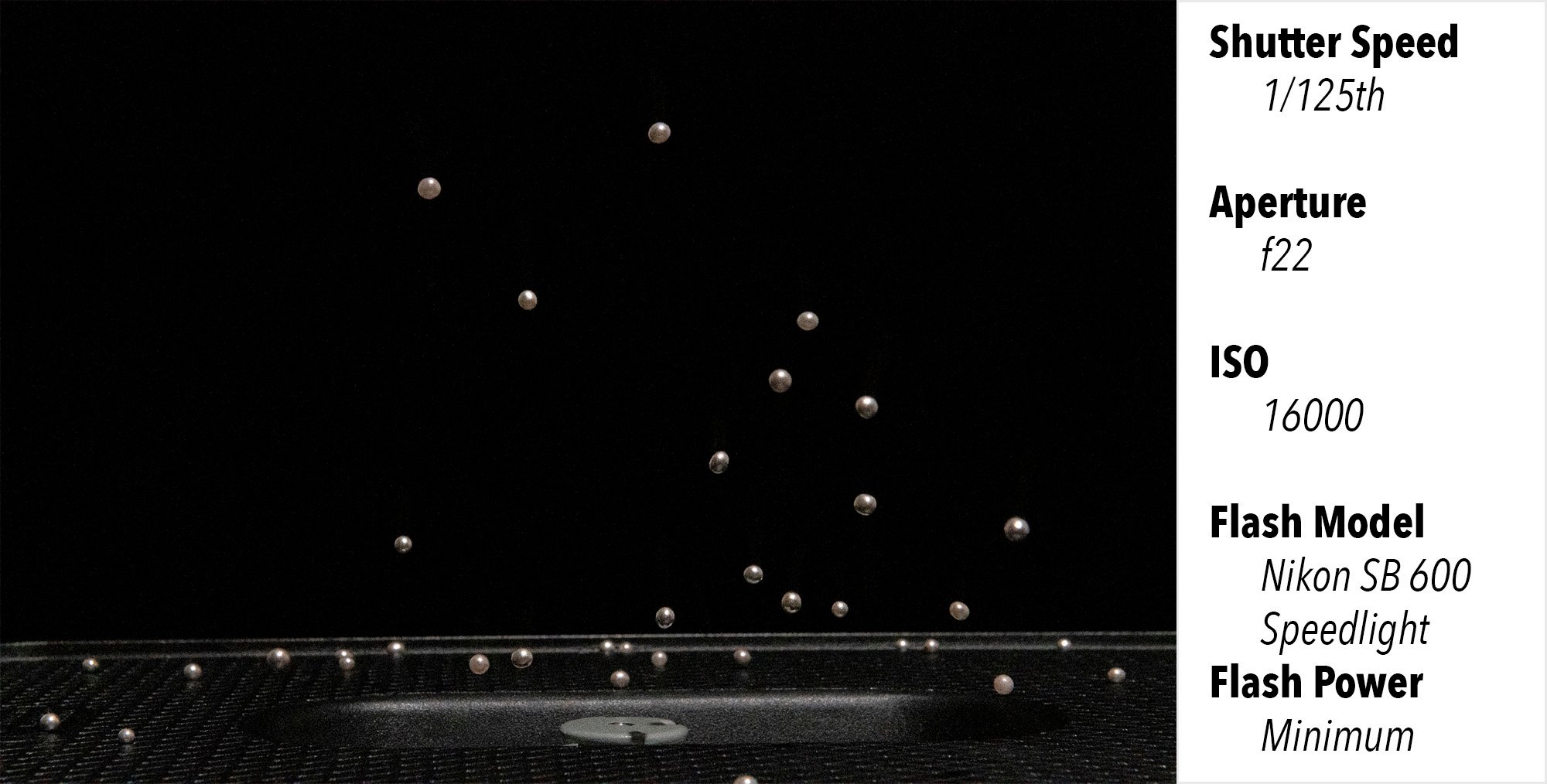

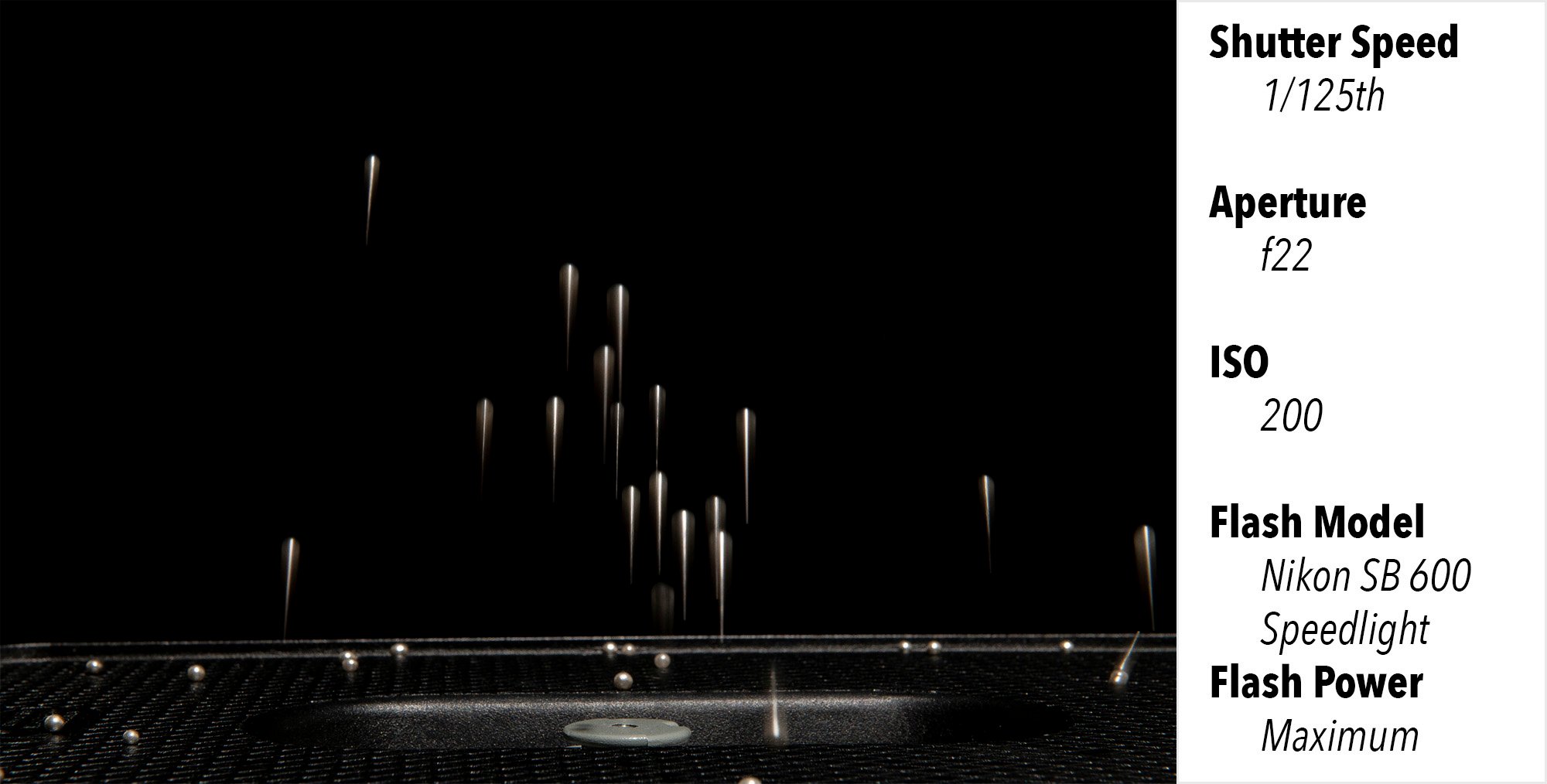

The… Speedlight
Seeing as I had everything set up, I thought I might dig out my old speedlight to also run the same test just to see how it faired. Full disclosure, I’ve not used a speedlight in decades so this old Nikon SB-600 is a little out of date, albeit hardly used. My point being that I have no data to say how much better speedlights are today compared to what we’re looking at here.
Either way, with that knowledge in mind, take a look at the resulting images and take from them what you will.

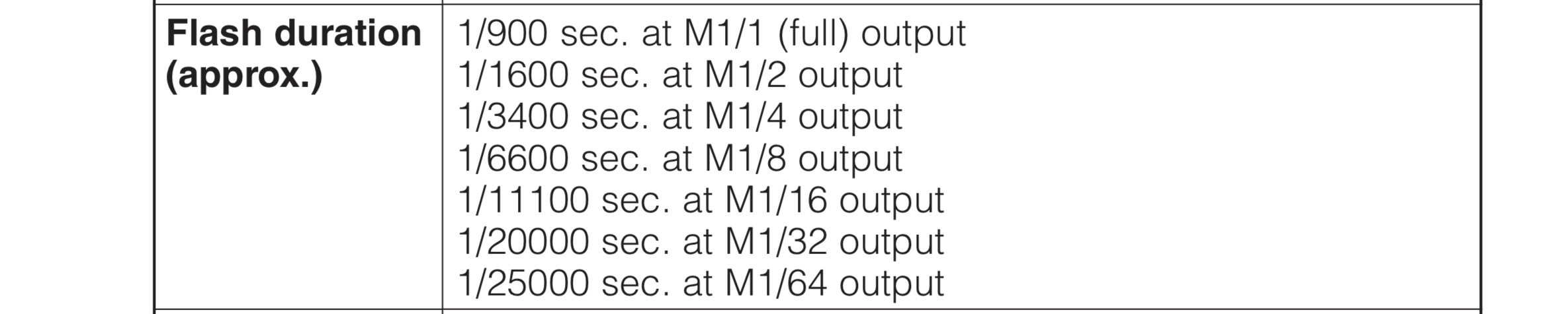

If you were curious, here’s the official flash durations on the SB-600 from the Nikon online pdf. Here is where I struggle to believe the data as my tests showed a very different result to this. Apparently at its lowest power (M 1/64) it has a flash duration of 1/25000, which is over twice as fast as the strobes we previously tested … hmm. Plus, at its highest power (M1/1) it has a flash duration of 900th of second. The resulting images I took sadly do not look like this is 3x faster than the previous strobes at full power either.
As with the strobes, the max power shot produced a very blurred shot, but the min power shot was surprisingly crisp.
The only other element worth mentioning here is that the speedlight at max power acted like the older strobe did. It releases a lot of power over a period of time, not a big hit of power, which then tapers off as modern strobes do. This results in a more consistent blurred image compared to a crisp one that tapers off to blur.
