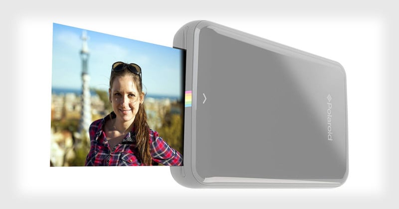

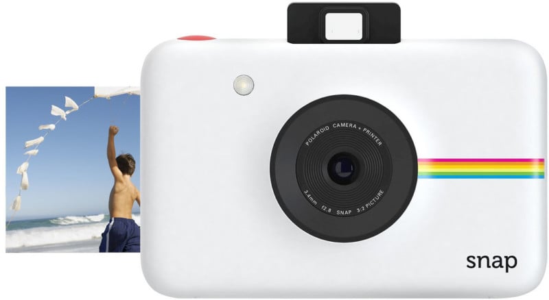

Polaroid, or should I say what’s left of Polaroid, continues to push instant photography, including cameras that produce Zink direct thermal prints. Camera models include Snap, Snap Touch, and Pop. Zip is an instant photo printer. The cameras and printer are available at Target, Walmart, and other mass retailers.

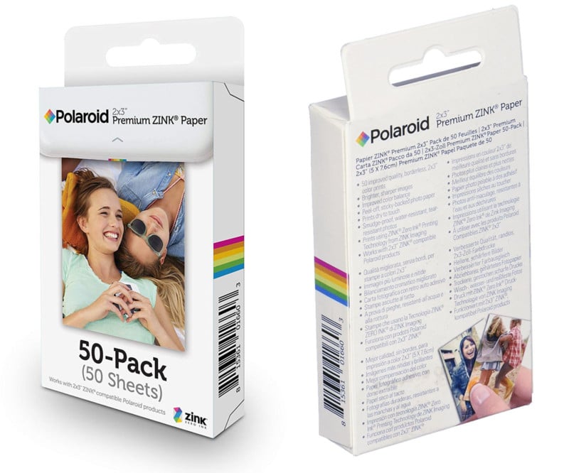

Direct thermal prints contain all the chemical necessary to produce the photo. To produce a photo, these products use heat activated dyes with each color layer activated at a different temperature. Cyan forms at 230°F (110°C), magenta at 302°F (150°C), and yellow at 392°F (200°C).
Unlike with conventional photography, nothing is removed during processing. Stability is a concern since the chemicals that are necessary to produce the photos at elevated temperatures are also likely to react at standard temperatures, destroying the photo.
Zink is more similar to thermal fax paper than it is to other printing processes.
Polaroid and Zink have chosen not to provide any stability information on their products. One can only assume that the expected lifetime for this product must be poor, since if it were not, they would have every reason to publicize it. Simply saying that the prints are “long-lasting,” as DPReview did in their review of the Polaroid Pop does not make it so.
