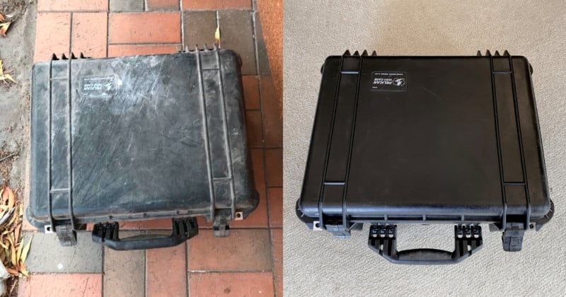

The bag arrived in a pretty dirty state—not surprising, given it’s been stored outdoors—but I got it for free, so I can’t complain about the condition. The photos below show the original uncleaned state.
I know some people like having this wear and tear on their bags, like a badge or honor, but I don’t feel it’s authentic to walk around with a bag that looks like you’ve trekked across the 4 corners of the Earth unless you actually have.
When the bag has earned this kind of wear and tear with me, it’ll stay on the bag.
The original condition of the Pelican 1550

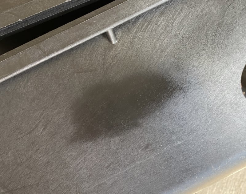

If you’re too lazy to watch the video, start with a heat gun at low heat—about a third to half power—and take your time. I use the heat gun on an area about two inches in size at a time, moving it back and forth across the two-inch area until that area darkens.
The first patch takes a little longer to darken as the heat gun and the plastic heat up. Subsequent areas are a little quicker. Overall, I’d say it should take about half an hour to do the entire bag, depending on whether you stop to allow one side to cool down.

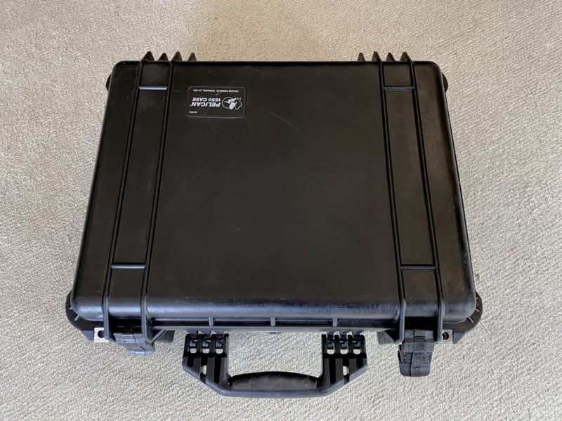

The heat gun worked very well and has restored most of the darkness.
The image above shows a small area that has been heated compared to the colour of the rest of the case just as I started the process. The photo below is what the final result looks like with just the heat gun treatment. I will take another before-and-after photo when I do the treatment, so both photos are taken under the same conditions.
