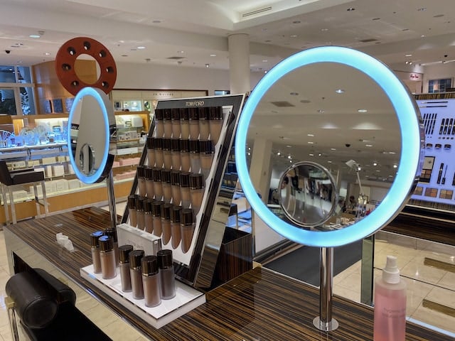

The same concept can be found in make-up mirrors, which surround a magnifying mirror with a ring of light. This combination provides a pleasing contrast to overhead lighting that tends to exaggerate lines, wrinkles, and sunken eyes. The advantage of a circular design is that the subject is equidistant from the light source, providing even illumination.
Department store make-up counters often make use of ring lighting and magnifying mirrors. Photo by Allen Murabayashi

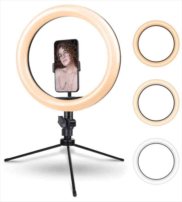

Amazon sells dozens of different types of ring lights like this one from Rovtop. Note the correct position of the camera phone lens in the center of the ring light.
As professional portraitists know, larger light sources result in softer light if the subject to light source distance is maintained. When used properly (i.e. camera in the center of a ring light and placed relatively close to the subject), a ring light can produce a very pleasing effect. But the arrangement of built-in computer cameras disallows the proper use of a ring flash. Most consumers position their ring lights off to the side, incorrectly assuming that it will provide a diffuse, pleasing light.

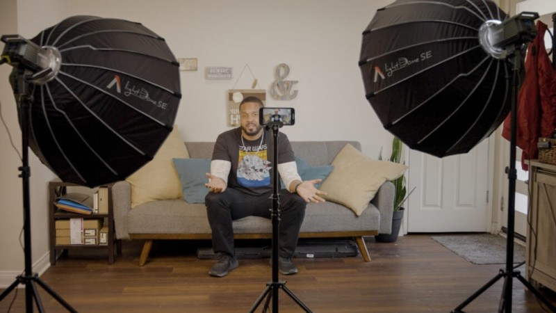

But a ring light’s surface area of illumination is small. So if you really want to look good, you need a bigger light source. Many YouTube creators use large octagonal diffusers to create a soft, but directional light. For most desktop users, this is an impractical solution due to the amount of space required.
Many YouTube creators use large circular or octagonal softboxes like the Aputure LightDome SE. Photo courtesy Aputure.

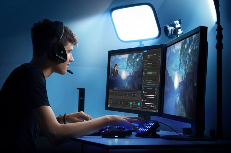

A number of companies produce flat LED panels like Fotodiox, Elgato, and Neewer of varying sizes that can significantly improve your on-camera appearance. You can position the light to create varying degrees of shadow on the face, but the “classic” position is slightly elevated above the head to create a small “butterfly” shadow beneath the nose. You want to avoid placing the light source below your face because it creates “monster light,” where shadows are cast upwards.
The Elgato Keylight and similar products are a better solution than a ring light for most video conferencing and streaming applications. Photo courtesy Elgato.
