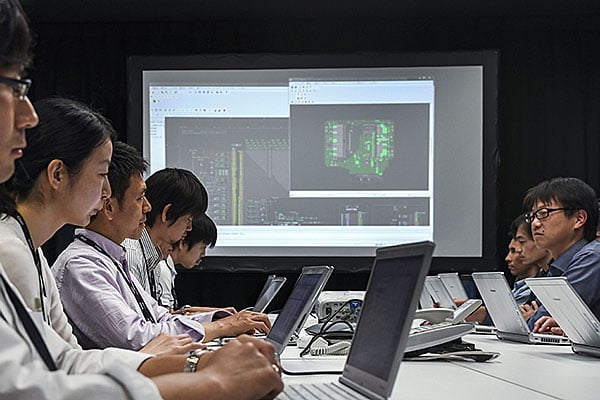

Responsible for determining the layout of devices on the CMOS sensor, Nikon’s sensor designers (assembled in teams that work on sensors for specific cameras) work to create an optimal combination of light-gathering efficiency, noise levels, readout speeds, power consumption, and more.
Nikon’s sensor engineers work in teams dedicated to individual sensors.

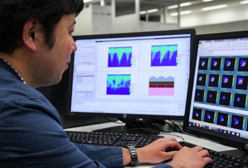

A computer simulating light rays coming in through microlenses, and bouncing around inside the pixel, on the way to the sensor’s surface.
“Even though I knew that Nikon had its own sensor design operation, I was surprised to learn just how deep the process runs,” writes Etchells, who holds a Master’s in semiconductor physics. “[T]he level of design, simulation and testing I saw was frankly astonishing.”

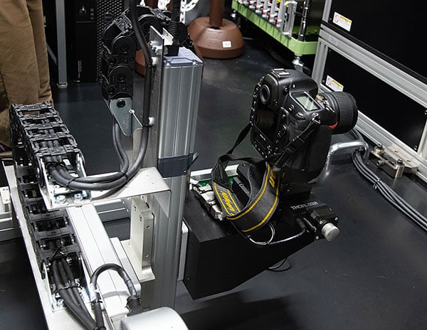

The camera mount from the flare-testing setup. the camera mount from the flare-testing setup.
This machine tests how microlenses respond to light coming from different angles.

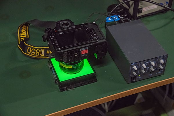

RGB testing.

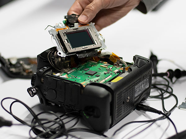

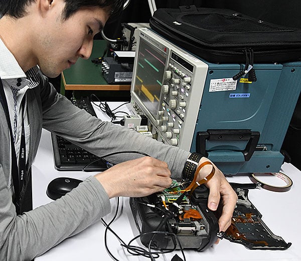

Nikon has special “breakout boards” that allow access to what would normally be internal signals.
