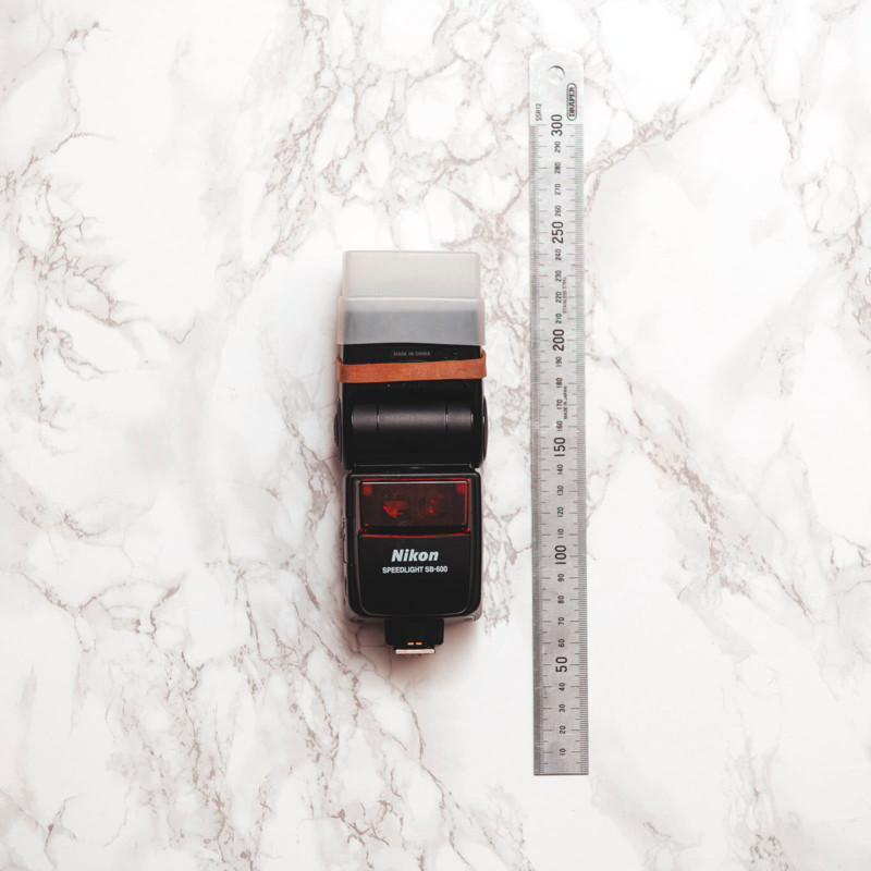

To clarify what I will be referring to as a ‘speedlight’ in this article, I mean the little black boxes that bend in the middle and are usually designed to sit atop your camera via the hotshoe.
There are a million and one cheap versions of these, but you can also spend a lot of money for more features if you need them.
Speedlights are also battery-powered and will often have a small LCD screen on them that displays limited info regarding power, battery life, and outputs, etc.

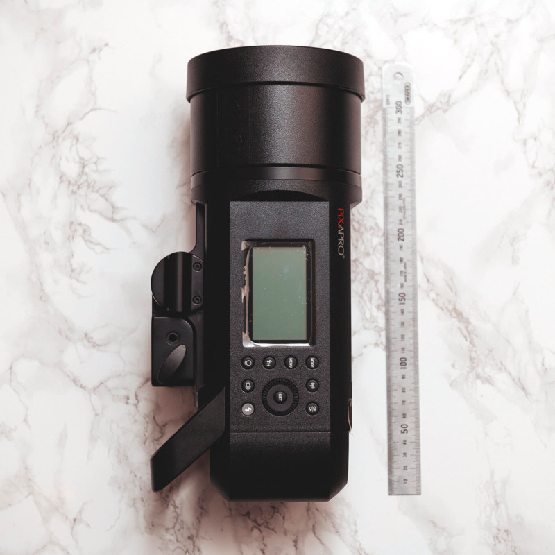

From here on out, I’ll be referring to these simply as strobes and these lights are very different from speedlights so shouldn’t be confused.
Firstly they are a lot bigger and a lot heavier making them impossible to mount on your camera via the hotshoe adapter. Plus, although many use speedlights off-camera, many see strobes as the more sensible OCF (off-camera flash) option due to a multitude of reasons I’ll explain in a moment.
Strobes also tend to be significantly more powerful than speedlights (they can produce a brighter light) and although some older strobes are still powered by cables plugged into the wall, many consumer-level strobes are now battery powered.

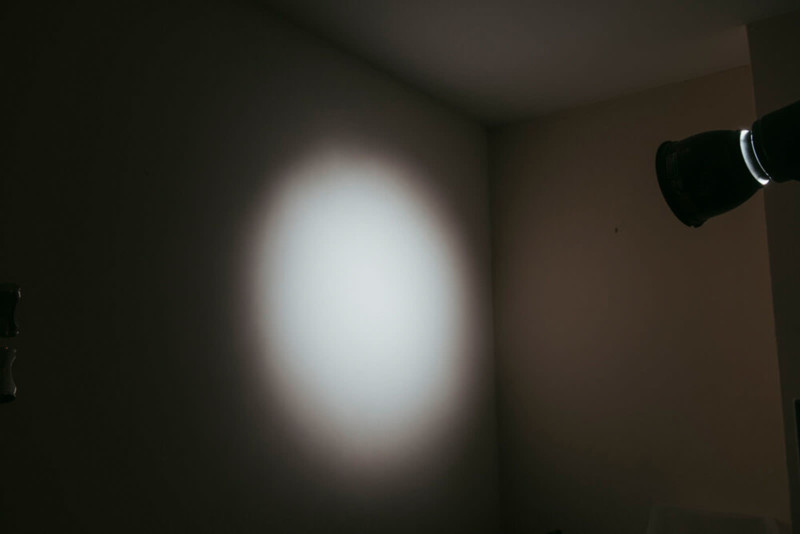

By its very design, a speedlight has to fire a ton of light down and out of a very small chute. There’s no way around this as the poor little thing is perched atop your camera and no amount of prisms, cloudy Tupperware, or cigarette papers is going to soften that very hard light enough so that it looks non-speedlight-like and more natural and pleasurable to look at.

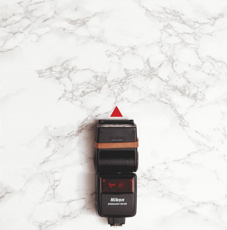

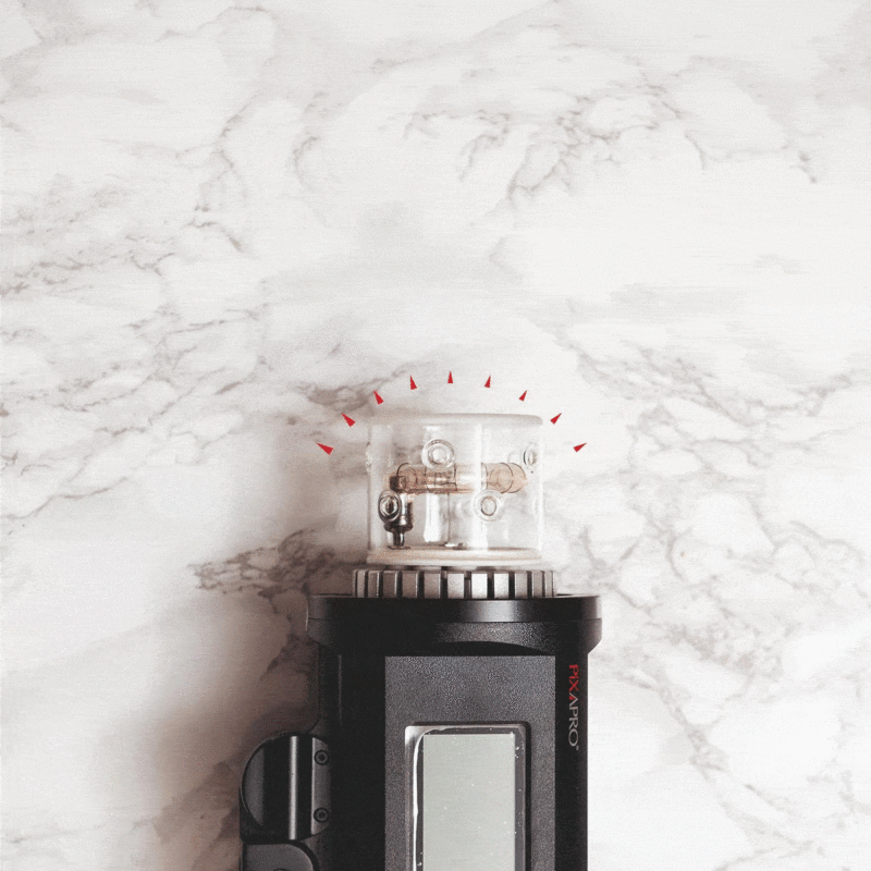

I am of course referring to the delivery method of the flashlight or photons themselves. The speedlight is unfortunately always held back by that tiny chute to deliver its light, whereas the strobes will often have their light source fully exposed for all to see. These two delivery methods will provide drastically different results, but take a look below to see what I mean.
The very directional expulsion of light seen in speedlights results in many lighting modifiers providing a poor quality of light.
Many strobes have exposed flash tubes. This results in light being spread in all directions which in turn fills many modifiers more evenly.

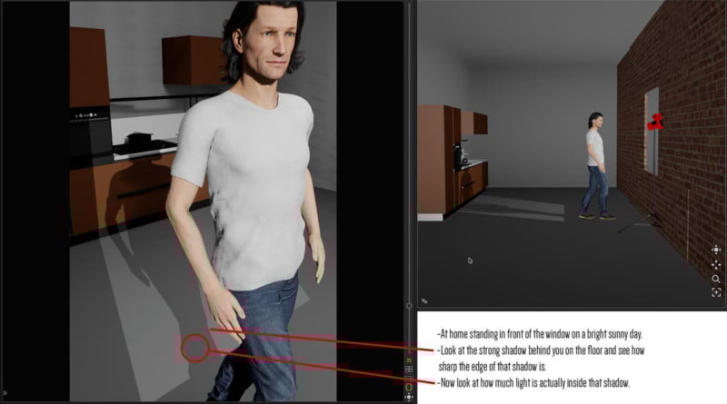

Now picture yourself at home on a bright sunny day and the light is coming through the window in front of you. You cast a shadow on the floor behind you, right? The edge of that shadow is very sharp thanks to the sun being a very hard light source, but how come your shadow isn’t jet black? How can you see detail in that shadow if no light is reaching it?
The reason for this is because sunlight is also hitting and bouncing off everything around you. This results in that light also falling onto that very dark shadow as well and it’s why it doesn’t appear jet-black.
Click to enlarge: This is an example of sunlight streaming through a window and the resulting shadow cast on the floor behind you.
As you can see in the image above, the shadow has light within it and this is how we see the world around us the whole time, nearly every shadow actually has light within it. I won’t get too involved in this here, but this is what I’ll often refer to as ‘shadow light’ in my workshops and training and although many don’t teach it, it’s a fundamental part of every image we see and take, yet many overlook this in studio lighting.

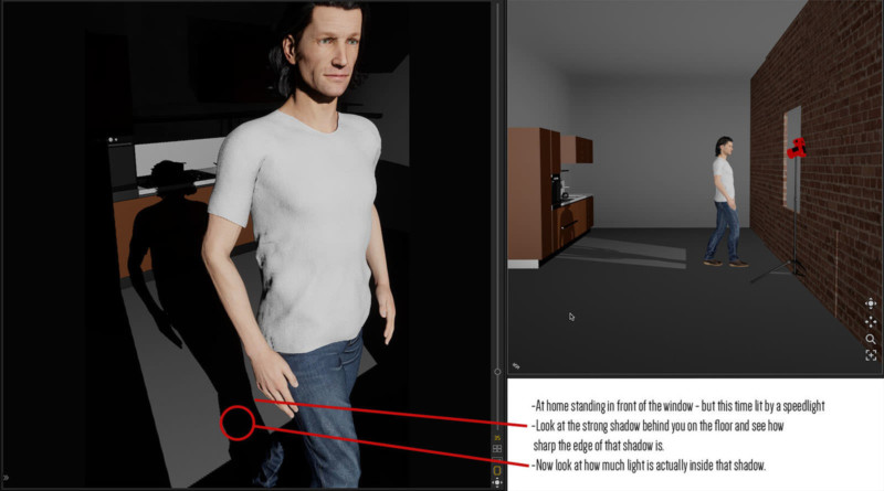

The same scene, but lit with a speedlight
Now let’s shoot the exact same scenario with a speedlight. After all, the sun is a tiny spec in the sky and casts very hard shadows, surely the speedlight should do the same right?
Click to enlarge: Here is the same scenario, but lit with a speedlight. Take note of the shadow detail now.
It should now be immediately obvious as to where the speedlight is falling short. Yes, it creates the same bright, contrasty highlights and razor-sharp shadows, but those shadows are jet black with almost no light in them whatsoever. I’m sure many of us have taken a very similar speedlight shot with those exact same jet-black shadows.
The reason for this is the very directional light that speedlights produce. They fire that hard light straight out and it has no chance to bounce around and spread onto other surfaces. It’s this type of light that immediately looks unnatural and wrong, even though many of us may not be able to explain why.
To be clear, I’m by no means saying that strobes produce light similar to that of the sun, but I do want you to start seeing the differences between a hard light that spreads light in multiple directions like a strobe and a hard light that only spreads light in one direction like a speedlight.

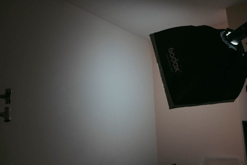

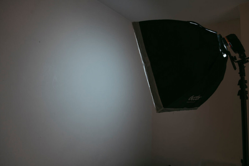

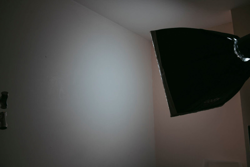

Here is the resulting light from a softbox attached to a strobe and a speedlight.
Softbox attached to a speedlight
Softbox attached to a strobe

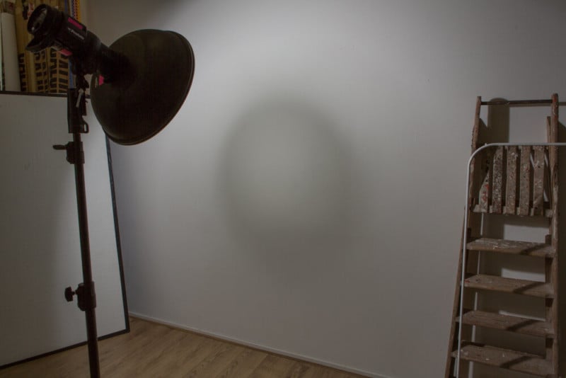

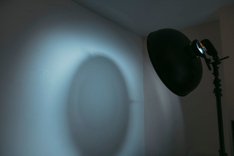

Here is a strobe and a speedlight with a beauty dish
Beauty dish attached to a speedlight
Beauty dish attached to a strobe
What should be apparent by now, is just how different a speedlights quality of light is compared to a strobes quality of light. The speedlight holds up remarkably well when dealing with very diffused modifiers like the softbox, but when you move into more directional shapers of light, things start to fall apart. The grids leave a distinct honeycomb pattern on the wall, the umbrella leaves a mottled and marbled pattern and the beauty dish is simply nowhere near fit for purpose.
The speedlight simply cannot compete with the strobes and nor should it. Speedlights are quick and responsive solutions to lighting situations and in that test, they would beat strobes every time.

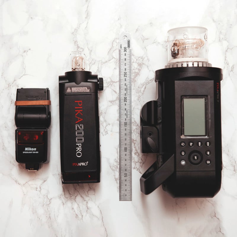

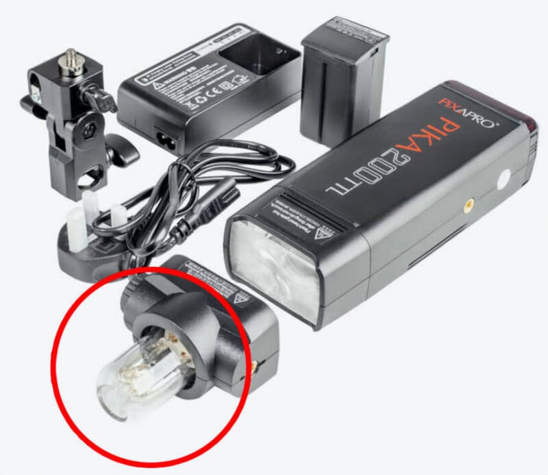

There is a flash out there that is only slightly bigger and heavier than a speedlight, but it also has the ability to deliver strobe-level quality of light. This little flash is the Godox AD200 (AKA PIKA200 here in the U.K.).

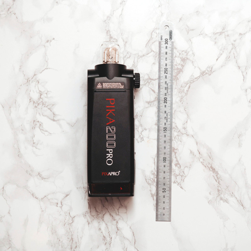

The Godox AD200 AKA PIKA200.

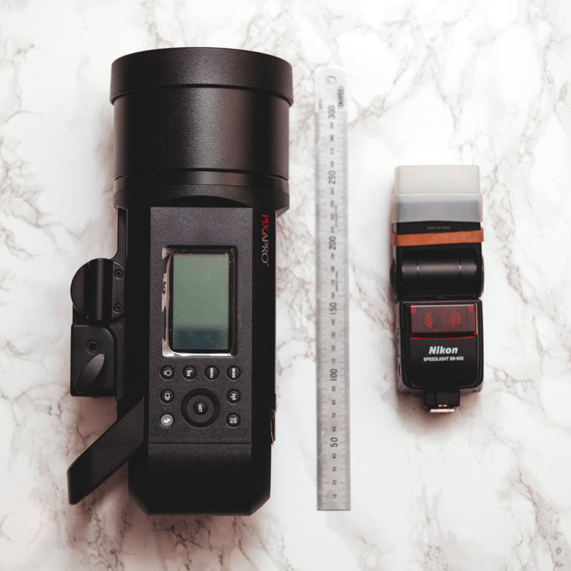

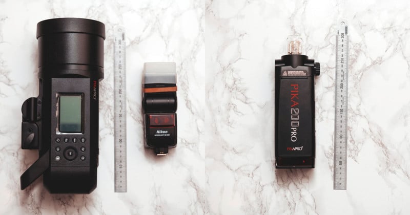

Here is the AD200 compared to both a speedlight and a strobe.
As you can see from the image above, the AD/PIKA200 is tiny (compared to a studio strobe) and at 880 grams (560 grams without battery and flash head), it’s pretty damn lightweight too. For reference, a typical speedlight weighs around 12.3oz/350g plus 4x AA batteries at 0.95oz/27g each and a 200w strobe (Lumina 200) weighs around 4.4lbs/2kg.
Note: Godox lights are almost always called something different in each country. Godox sells the lights to distributers and they often brand them differently. For example, in the U.K. they are branded as ‘PixaPro’ lights by Essential Photo and in the U.S. they are branded ‘Flashpoint’ by Adorama. My point here is that if they look like these lights but are called something different, they are likely the exact same lights made by Godox in China but with a different label.
So what’s the big deal?
The big deal is the genius exposed flash tube attachment! This little feature changes everything in my opinion as this allows us to access and properly use so many modifiers that were previously rendered almost useless to regular speedlights.

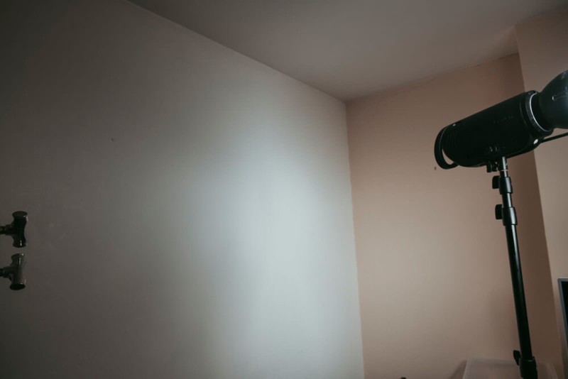

Take a look at how the PIKA/AD200 performs with some of the modifiers I used earlier and make your own decisions.
AD/PIKA200 with a softbox attached
AD/PIKA200 with a grid attached
AD/PIKA200 with a silver umbrella attached
AD/PIKA200 with a beauty dish attached
I think you’ll agree that the exposed bulb of the AD200 easily proves itself as being able to provide beautiful quality of light, plus it comes in a tiny package too. The softbox is as expected and although I would avoid the grid modifier here, the umbrella and beauty dish lighting qualities are marked improvements.
Note: My guess as to why this AD/PIKA200 doesn’t quite match strobe quality level lighting, for example the grid modifier, is likely due to the bulb being physically smaller. Yes, the bulb is exposed, but it is small in size and this results in a harder light. This is seen most noticeably on the grid as that little bulb shoots straight out.

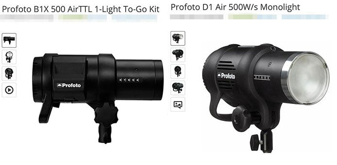

Now, just before you close this tab and walk away laughing, hear me out. Profoto, according to many professionals, myself included, dropped the ball a little with their B1s and D1s. Why? Because of their somewhat bizarre design choice to recess the flash tube in that long tube. Take a look below at the B1 and D1 if you’re not familiar with them.
To be clear, I’m not crapping on these lights, as they are likely excellent units and many, many photographers are extremely happy with them. But, for what I do and the modifiers I use, they are simply not fit for purpose and many were baffled by their decision to place the bulb where they did. Don’t just take my word for it though and you can easily find more examples online where others are voicing their confusion.
Yes, the bulb is very protected in that tube and that is clearly a more sensible place to put it for a battery-powered strobe that is designed to be used on the road and up a mountain if that’s where you are using it. Plus, if you’re a shooter that predominantly uses softboxes, this will be absolutely fine too (within reason and a hot spot is still apparent in certain sizes and depths), but if you’re a photographer like me that uses a wide variety of modifiers, this will cause you issues. What was most bizarre though, was that Profoto didn’t seem to test this new design with their own popular modifiers. Take a look at the quality of light from their very popular beauty dish on the B1 below.
