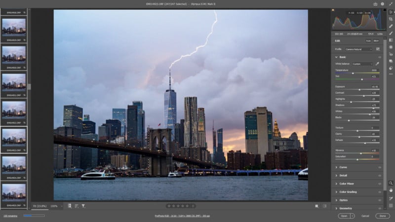

Making basic adjustments across the individual photos before stacking them.
