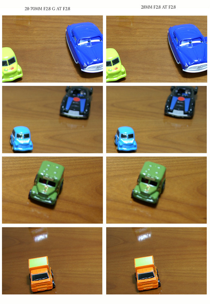

I did a comparison btw. 28-70mm f2.8 G with 28 f2.0 prime..
look at the sharpness, color and bokeh..
more photos in this link: http://www.flickr.com/photos/eyesthruthelens/sets/72157594450899529/detail/
Poison alert. :devil:
might want to check for backfocus on the sharpness test with 28mm f2.0... there seems to be some backfocus :think:
the left arm is more in focus than the head...etc
and imho the bokeh seems better on the prime.. the bokeh of the 28-70 are more "moon-like" where as the prime give a more circular bokeh.
On close inspection, it appears that your 28 f2 is back focusing a bit at f2.8. You will noticed on the bottom two pictures, the figurine on the back is much more in focus for the f2. The table wood grain also shows the different focusing plain. :dunno:
May be you could double check?
Yeap.. I suspected some slight focus differences btw the 2 lens.. as the G is longer that than the prime..
and the G min focus distance is longer.
Anyway, I'm pretty happy with the G lens performance.. and thus trying to poison others to jump into the G-wagon as well :devil:

hehe but i think maybe should redo the test lah. the 28 f2 is supposedly a damn good lens. these results seem unbelievably bad. the 28-70G is not the sharpest in the G line-up. of all the G lenses it's the one that most ppl are willing to forgo and use the consumer version (28-75) instead. so i suspect maybe the 28 f2 focus is off.

I think you need to repeat the test with consistent subject to sensor distance. 28mm f2.0 should be sharper than 28-70 f2.8 G at f2.8, at least my test some time ago confirm that, can't find the test photos anymore.
G lenses are great, but still slightly softer compare to prime for 28mm f2.0, 35mm f1.4, 35mm f2.0, 85mm f1.4 caliber.

:embrass: OK, I think I need to do another test btw these 2 lens..
Hee Hee ... new test... with fixed tripod and object + no filter attach to lens.
I'm still impress with the G-lens performance.
Is there anymore back focus problem on the 28mm f2.0?
at f2.8
at f8.0

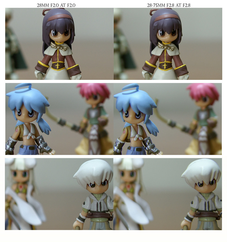

I did a test btw the 28mm f2.0 and the 28-75mm f2.8 as well :)
28-75mm f2.8 is a sharp lens and very usable at f2.8

my eyes ain't very good in telling difference, but what i can see here is that the left side of the 28mm prime ain't as sharp as the tamron and the G, but the right side is sharper than the tamron and comparable to the G. (provided all are perfectly focused)
as for center, i seriously can't tell any different between all the 3 lenses by looking at the small image(in term of sharpness). :sweat:
good test here :thumbsup:
