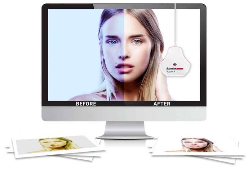

Calibration
Most high-end monitors will ship “factory-calibrated” including a calibration report, but like everything we use, things wear out and change over time. So users should re-calibrate their screens often regularly to ensure the most accurate colors are being displayed. Investing in a calibration tool from Datacolor or X-Rite will allow users to ensure their screens are in peak performance levels, as well as providing detailed reports of the actual visible colors and accuracy being provided through the screens.
DataColor
