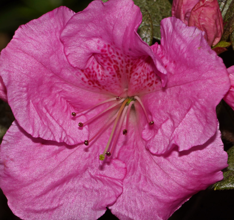

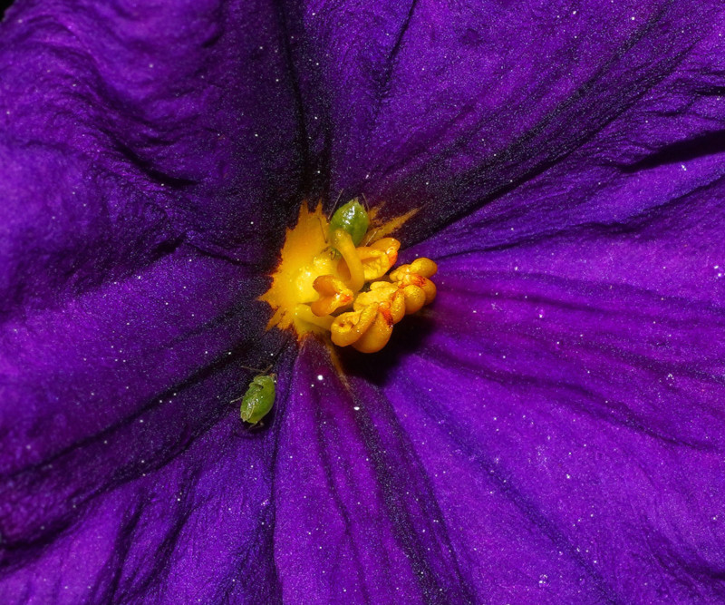

And there are many closeup situations where it’s best to have the flash close to the lens, such as shooting the anthers (pollen clusters), or insects, deep in a flower:

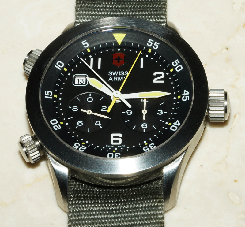

The easiest way I’ve found to photograph a watch is with a pop-up flash. I just shoot from slightly below center to avoid reflections. But a shoe-mounted flash is so high that I must shoot from well below center to avoid reflections – leading to an oblique view. (The crystal of this watch is flat. Domed crystals pose a greater lighting challenge).
The long exposure (with camera on tripod) alternative is far less desirable, resulting in blurred second hands or pulled-out crowns to hack the movement. And, of course, not all watches can hack (stop the movement).
