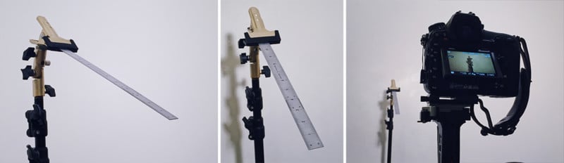

Set your tripod and camera up at the same height as your chart or ruler and make sure the camera is level. Use a spirit level (usually on most tripods) if necessary.
Setting up Your Chart
Next, you’ll need to set up your focus chart. Although there are plenty of places online where you can download and print out focus charts, I personally don’t feel it’s all that necessary. I used a metal ruler that I had in the drawer and that seemed to work for me. In fact, you could just as easily use some packaging that has a lot of text on it.
The real trick here is to mount the focus chart/ruler at an angle so you can see the focus drop off. You just need to have a specific point to focus on and then other areas of detail around it to see where the actual focus is falling. As I said, I used a metal ruler as I could focus on a specific measurement number and then check what was in or out of focus around it.
I mounted mine on a stand at a downward angle and focused my camera halfway along the ruler.
I mounted my ruler at a downward angel and focused half way along the center.

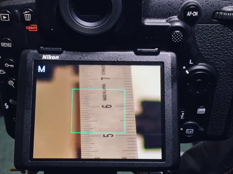

Next, you’ll want to switch to live-view to enable you to zoom in and really nail the focus. It’s my recommendation that you should select the center focus point as well as choose the smallest focal point possible.
Once all that is done, it’s time to zoom in and focus on the center of the ruler and take a shot. Again, my advice would be to take at least three shots here so that you can get a broader look at the autofocus. Each time de-focus the image and then refocus again to test the autofocus properly.

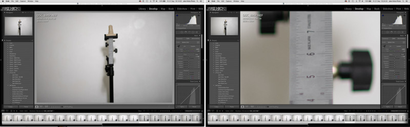

All that’s left to do now is import your photos into editing software like Lightroom or Capture One. Importing your photos into an image capture software enables us to zoom in a lot further than on the back of a camera. Remember that the image on the back of your camera is a JPEG so zooming in a long way can make the image appear fuzzy, whereas importing them into software like Lightroom allows us to check the focus point accurately. Once you have imported your photos, zoom into the image so that the focus point is filling the frame. Now we can assess whether there is any fine tuning to be made with our autofocus.
Import your files and then zoom in so that the focus area is filling the frame. Now we can check to see how accurate our auto focus is behaving.

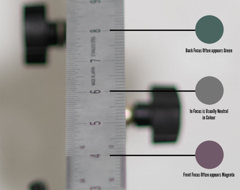

Pro tip: Sometimes it can be hard to distinguish what is in focus and what isn’t, so a good trick can be to use the color picker and see what colors appear in the focal range. For example, most lenses will have aberrations and those aberrations are consistent in a digital file. Areas that are out of focus behind the focal point tend to have a green hue to them, and areas that are out of focus in front the focal point tend to have a magenta hue to them.
If you’re photographing something neutral in tone then you can use aberrations in colour to determine where the focus point is.

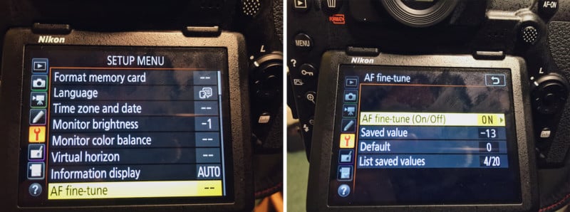

First off we’ll need to bring up our AF-Fine tune to turn it on and make the adjustments. This is the Nikon menus but the other cameras use a very similar name and process. For a Nikon DSLR, go to the menu with spanner icon and in there at the bottom, you have the Af Fine-Tune Menu. Go in there and then turn on the AF-Fine-Tune.
Note: I had a quick look for the Canon version and you can see how to access it here: Canon AF Fine tune.
This is where the Nikons AF Fine Tune menu is located but other camera manufacturers have a very similar name for it too and should be easy to find.

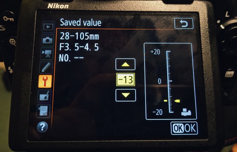

So now that we have our AF Fine-Tune enabled, we can begin to make some adjustments. If we look back at our imported images and review them to see what can be improved.
If you feel that the camera’s autofocus is missing the mark consistently, then you’ll need to make some adjustments in the fine tune menu of your camera. So for example, if your autofocus is consistently focusing behind the intended focal point, you’ll need to adjust the autofocus fine tune with minus numbers to bring it back to where it needs to be. Conversely, if the autofocus is consistently focusing just in front of the intended focal point (closer to the camera), you’ll need to increase the autofocus fine tune with positive numbers.
For example in the image above you can see my 28 to 105 mm Lens was consistently back focusing, which meant that the fine tuning adjustments ended up being -13 in the fine tuning menu. This process can take several attempts to get it perfect so you may want to make large changes to begin with to start seeing the effect. Make the fine tune adjustment, take some more shots, review the images in Lightroom and make any necessary adjustments again. Repeat the process until you’re happy.

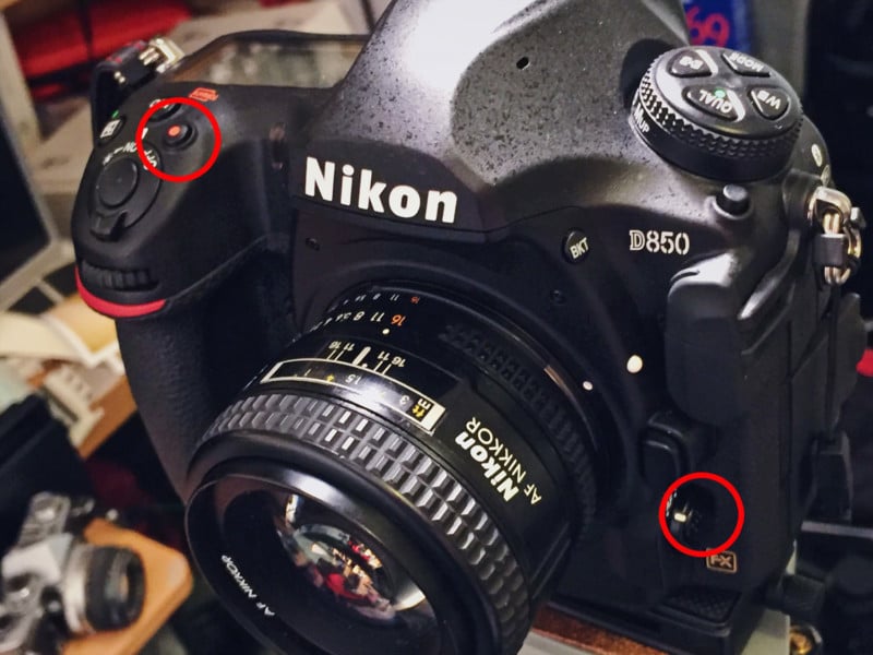

You don’t actually have to take a shot as the camera will do that for you in the next step. What you need to do next to hold the auto-focus selection button (often located on the auto and manual focus switch) and the video record button for about 3 seconds.

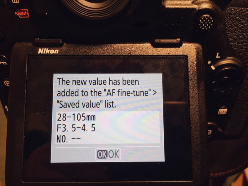

If everything was done correctly, your camera will then show you another screen a couple of seconds later to say “The new value has been added to the ‘AF fine-tune’ ‘Saved value’ list.
You can now go to the fine menu and see what value has been assigned to your lens to correct it.

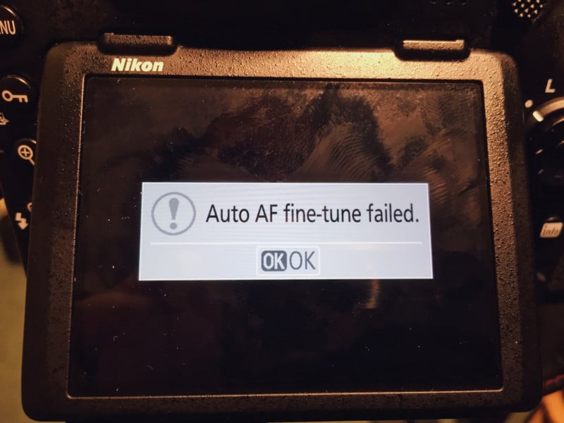

Auto AF fine-tune failed
You will likely get the auto AF failed window a few times and here’s a couple of things I did to fix the issue.
1. Make sure there’s enough ambient light. If not, don’t be afraid to boost the ISO.
2. Shutter speed too low. I was originally shooting at a 60th but it needed a faster shutter of 125th to work in my tests.
3. The camera moved. Like I mentioned before, when the screen pops up asking if you’d like to proceed, be as gentle as possible to avoid any subsequent camera shake.
4. Improper source image. The image filing the focal point needs to have sufficient detail for the camera to look at. Mine had strong lines, but text on a non-shiny surface would work well too.
