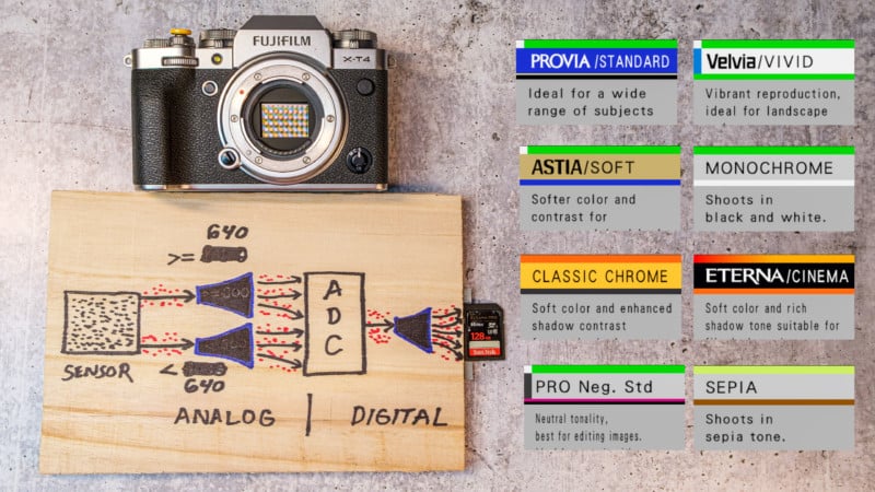

For those of you new to Fujifilm or to photography in general, whenever you increase the camera’s ISO value, you are amplifying the electrical charge from light photons that hit your camera’s sensor. If you are taking photos in low light conditions, increasing the ISO is one of three exposure triangle settings you can make that allows you to capture more light in your image.

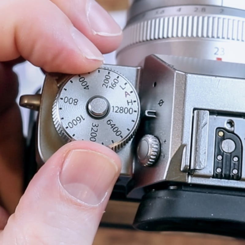

I tested each of the 12 main film simulations at the following ISO values: 1600, 3200, 6400, and 12800. Those are all native ISO values for the camera. In addition, I tested two additional ISO values of 25,600 and 51,200. Those are called ‘extended’ or ‘simulated’ ISO values. And they are applied digitally to your already shot image just before your camera saves the file to the SD card.

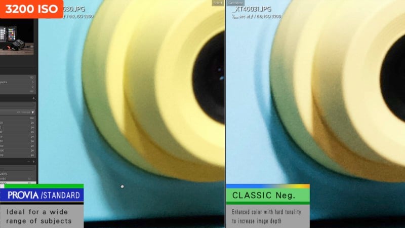

- ISO 3200
- You can see differences zoomed in at 200%.
- Lowest noise: PROVIA, Pro Negative Standard, and Monochrome.
- Highest noise: Classic Negative, ACROS, and Bleach Bypass

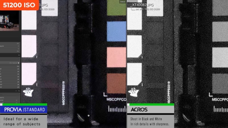

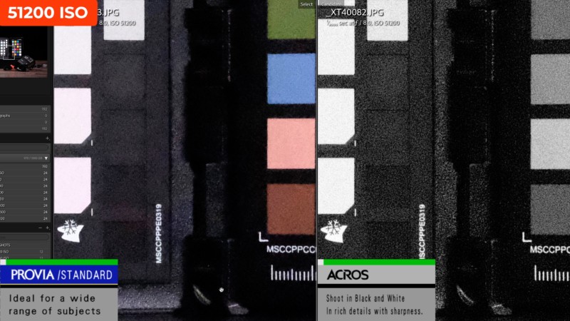

- ISO 25,600 and 51,200
- Lowest noise: Pro Negative Standard and Monochrome.
- Highest noise: ACROS and Bleach Bypass
- Conclusions

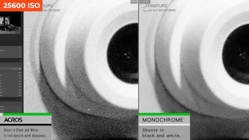

- Monochrome is much less noisy than ACROS at all higher ISO ranges. In going through my testing, it seems pretty conclusive that Fujifilm adds some additional grain and/or noise to ACROS to help give it that unique look. The problem is, at much higher ISO values, it can start to fall apart at bit. If you are planning on shooting with ACROS, I would not go above 3200 ISO. Also, I’d definitely make sure the grain setting on your camera is turned off.
