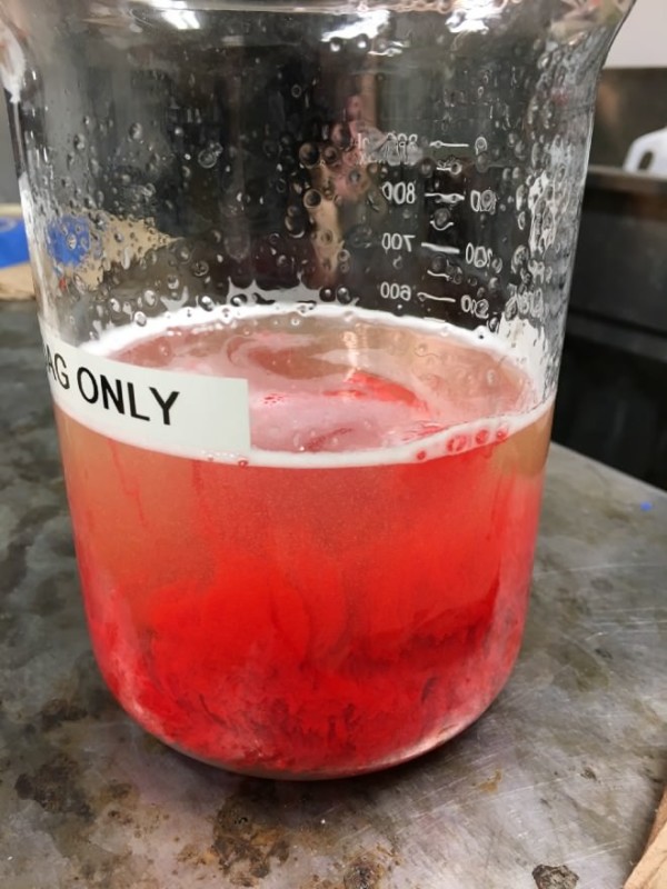

Step one was creating a tissue — in this case the tissue is a colored gelatin goo that brings color and life to the image on the paper. To start you have to mix gelatin, a bunch of chemicals (wearing gloves in a highly ventilated fume hood like you had in science class), and water colors to the gelatin. You can use any colors you want. Our class went with black, red, yellow, and blue.
Preparing the gelatin.
Adding color to the gelatin.

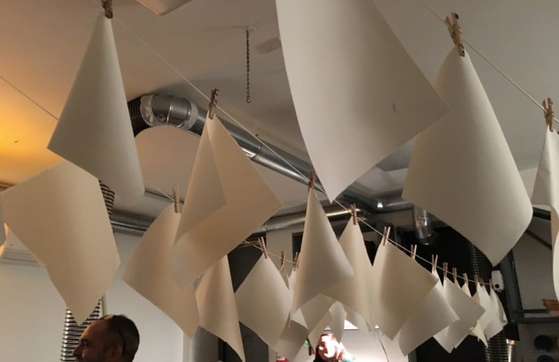

Next, we had to prepare paper to transfer the image onto. We started with hot press, 120lb cotton rag paper and cut them up into 8×11 or smaller sized pieces. Then we soaked them in warm water to prevent them from shrinking later on in the process and hung them to dry.
This was a common site both days.

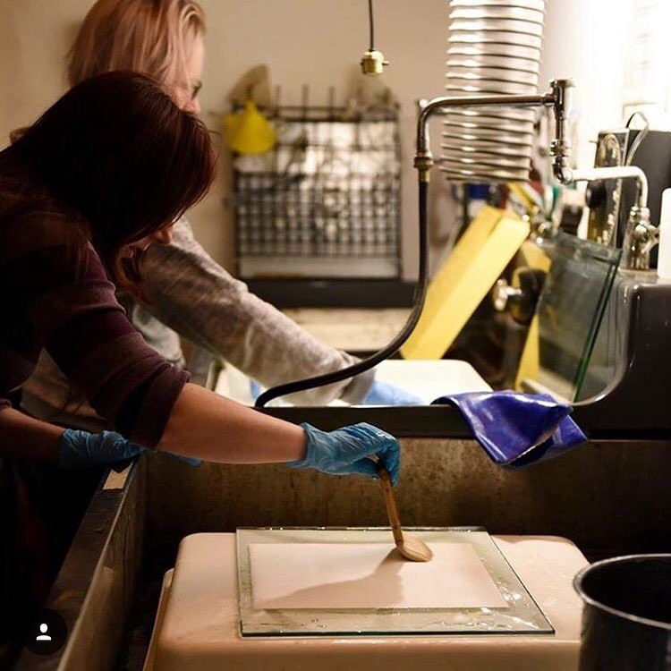

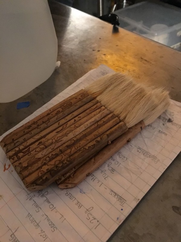

After the paper dried, we coated it in a sensitizer solution of potassium bichromate which is an incredibly dangerous chemical — tip: don’t use this unless you have been taught how to handle it properly! The sensitizing process makes sure your image transfers onto the paper from the tissue. We then used a very soft and elegant hake brush to apply the chemicals onto one side of the paper.
Hake brush
Me sensitizing paper.
After we sensitized what had to be upwards of 60 pieces of paper, we squeegeed and hung them up to dry (again). That took up the entirety of our 8 hour day — it was A LOT more work than I thought it would be, and I still didn’t have any pictures to show for it.

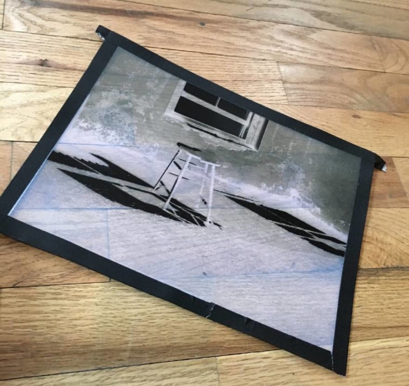

Day two. Everyone was excited to actually begin making pictures today! We began by choosing which negatives we wanted to work with. A photographer in 1865 would have used a traditional large format film negative — but because there are many steps in the process where you could damage your negative and lose your image forever — so we cheated and used digital negatives because we could. Digital negatives are easy to make and cheap so if something goes wrong, the original image is protected and you can produce another digital negative quickly. The digital image I chose to work with first is below.
From my perspective collection, this image is called “Ellis Island Hospital”.

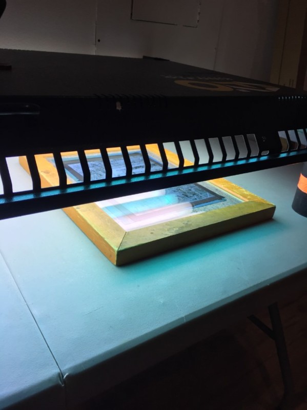

You take the negative, and place it on the sensitized paper, lock it in a press and expose it under a UV light (back in the day this would just mean putting it outside which would require a much longer exposure).
Exposing an image under the UV lamp
I started with a 2 min exposure as a baseline, knowing I could increase or decrease the next one as needed. Once that exposure is complete, you take the paper out, put it in cold water, place it face to face with whatever tissue you want, squeegee them together and place them in between two 1/4 inch thick glass plates. Then you put 10 lbs of weight on top of the plates to let the chemicals from the tissue interact with the chemicals from the sensitized paper that has the image on it — you let that sit for 10–20 min.

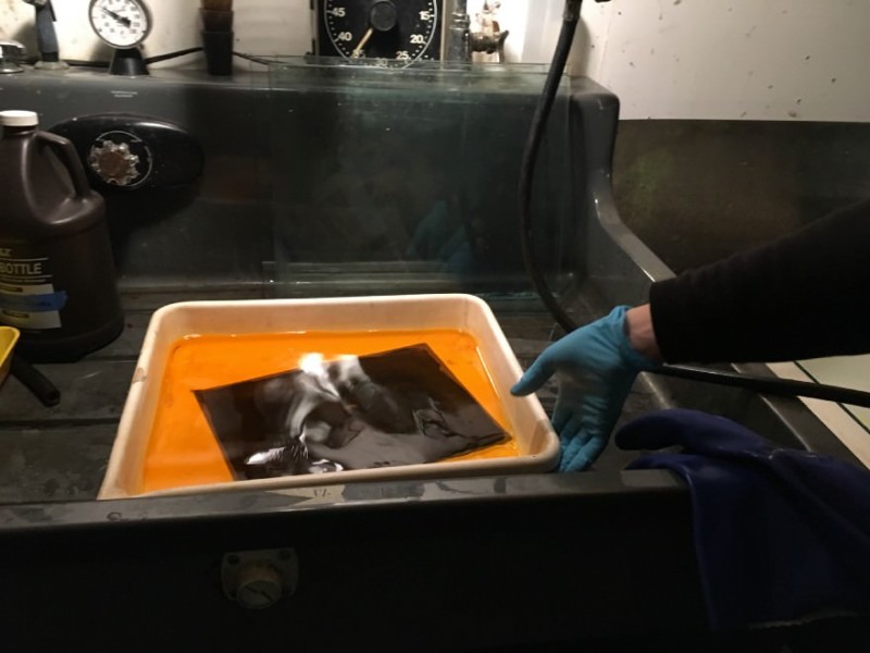

Now it’s time for the real magic – seeing if all the hard work over the past day and a half paid off, and feeling the joy of producing a real carbon tissue photograph! After preparing a very hot water bath you place your paper and tissue in the bath, and slowly, very, very, very slowly start peeling the tissue away from the paper to see your beautiful image come to life. Then you very, very, very gently clean up the image using the hake brush again to get all the extra tissue bits off.

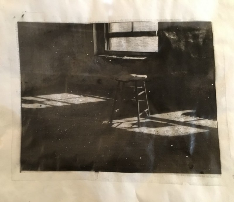

So holding my breath, I peeled back my first tissue and you know what I saw?? Zilcho, nada, nothing — a blank piece of paper. After all that work. Sigh. I grumbled a bit and started all over again. On my second try I got an image, but I pulled the tissue back too quickly and the image pulled right off the paper and floated down the drain. By try number 4 I finally got something! It felt glorious.
My first successful carbon print — from my perspective series, titled “Ellis Island Hospital”

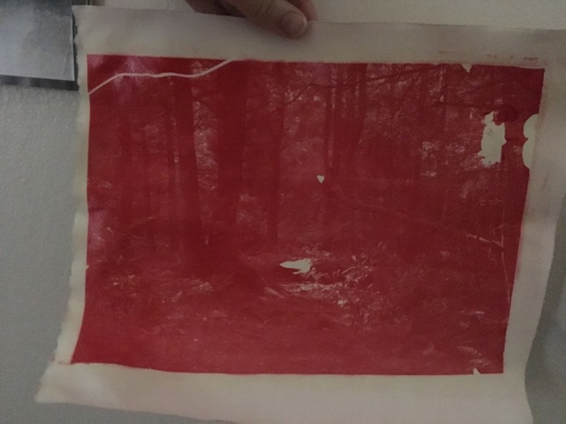

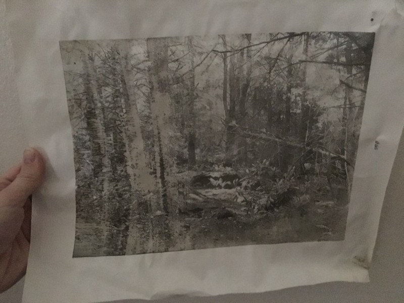

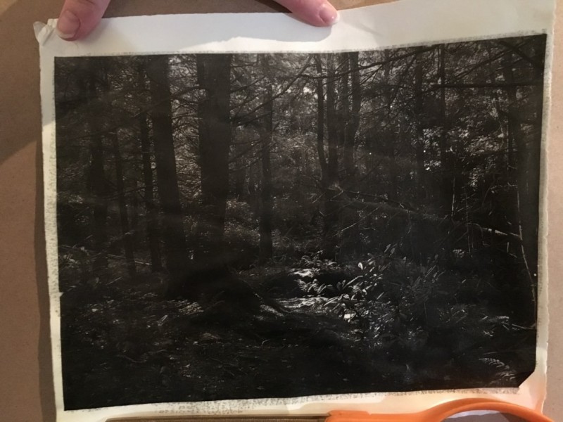

For the rest of the day we became printing machines! At one point, I switched to a picture I took while I was hiking in West Virginia when I stumbled upon a fairytale scene of light streaming through a thick forest. I created variations of it using different colors and exposure times.
Dark exposure
Light exposure
Dark red

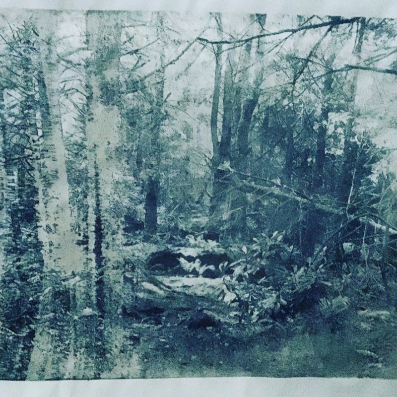

My favorite print was one of the last ones I did using a blue tissue. I have compared it to the original digital image below so you can get a feel for the difference.
The original image I took in West Virginia
Carbon Tissue Version — Blue Tint
