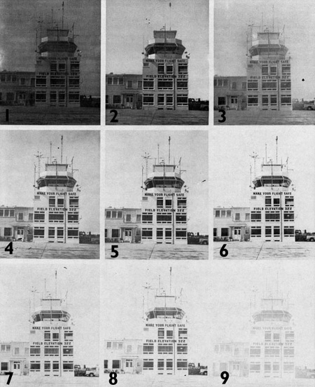

Left side is Underexposure. Right side is Overexposure.
Top side is Underdeveloped. Bottom is Overdeveloped.
Sorry to confused you even further, here is another text on the subject with photos of the negatives.
http://micro.magnet.fsu.edu/primer/photomicrography/bwprocessingerrors.html
