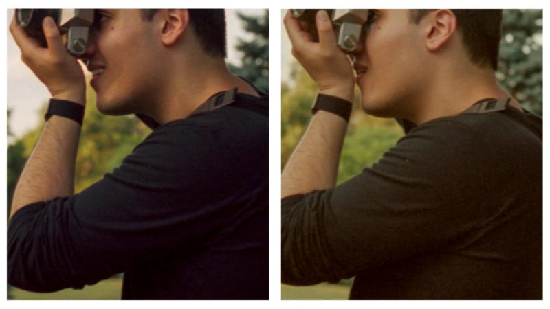

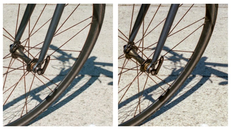

“This time around, I wanted to control the experiment more. I sent one roll of Kodak Portra 400 that I had not yet taken pictures on through a TSA CT scanner at BWI airport,” Nuri says. “The roll only went through security one time and was not sent through the TSA CT scanner again after I shot the photos. I then loaded that roll into a 35mm camera with a 50mm lens and loaded a separate 35mm camera with a 50mm lens with a fresh, unharmed roll. I shot the exact same pictures using the same settings on both cameras for each shot so that I could compare them side-by-side as accurately as possible.”
Left side: Unscanned film. Right side: After CT scan.
Nuri found that while only the darkest shadows may have lost a negligible amount of detail, the film was relatively unharmed.

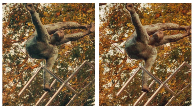

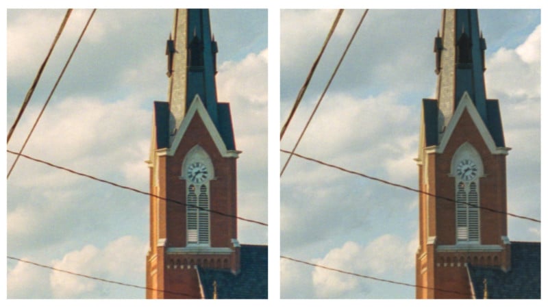

“Compare that to photos I took in Rhode Island that got TSA CT scanned after I took photos but before developing them, you can see the difference is clear. Having your roll get scanned after you’ve taken photos but before developing will noticeably decrease the level of detail in the shadows.”
In his testing, Nuri says that one scan through the new CT scanners before you take any exposure will not noticeably damage film, assuming the photos are properly exposed later. However, sending a roll that already has photos on it through the TSA CT scanner will damage them with a noticeable loss of detail in the shadows.
