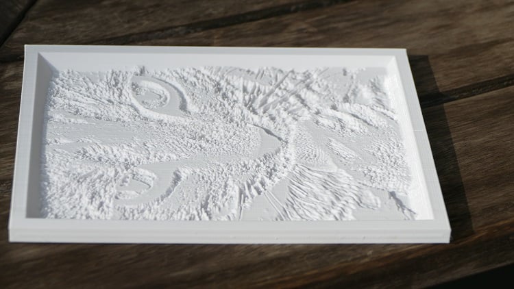

A lithophane is usually a translucent object where an image is projected by varying the thickness of the material and has been in use for a couple of hundred years, but only recently became easier to produce thanks to 3D printing. When you shine a light on the back of the lithophane, the image reveals itself through the contrast of different light intensities. Thicker parts of the object have lower light intensities which make the object darker and vice versa for thinner parts.

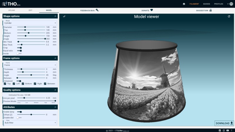

For the design of the lampshade lithophane I used ItsLitho. After uploading the photos, I selected the cylinder shape from the shapes dropdown menu. Something to keep in mind is to make sure the top diameter is lower than the bottom diameter to provide a classic lampshade look.

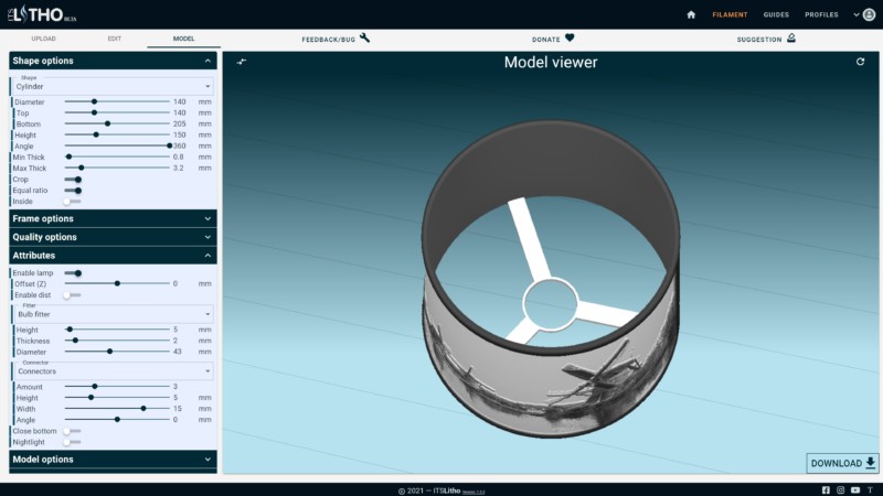

For a lamp shape lithophane, we want to enable the lamp attribute. You should measure the lamp holder and insert the number in the bulb fitter diameter. Make sure to add a bit of tolerance so it will fit easily.
I entered the important numbers and tweaked the connectors of the light bulb fitter to my preferences. At this point, I thought the model looked great, so I then downloaded the model. Click on the download button on the lithophane + attribute button to get the 3D model file.

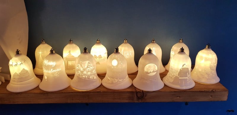

Now that you know how a lithophane can be created and printed, it’s time to show you a couple of awesome other prints to use as inspiration! There are numerous different designs people come up with during this season. One of my favorites would be a Christmas bell lithophane. These are easy to place, easy to light, and I find they enhance the Christmas spirit.
