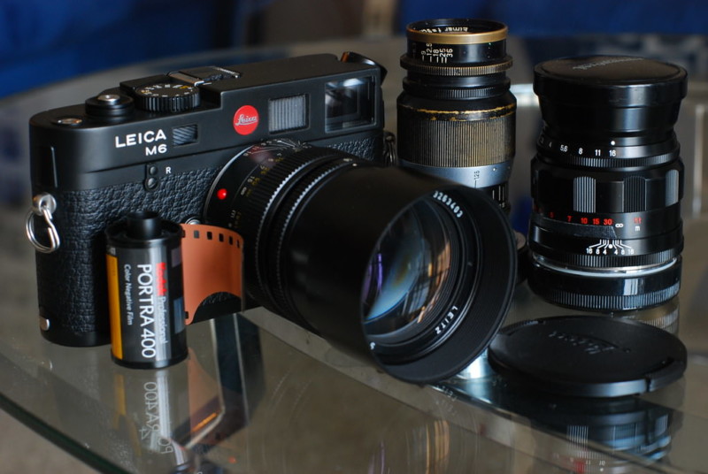

Leica M6 TTL .85 with 75 & 90mm lenses. EBL = 59.1mm

Leica M6 TTL .85, Leitz 90mm f/2 Summicron Pre-ASPH, Fuji 400 Pro H

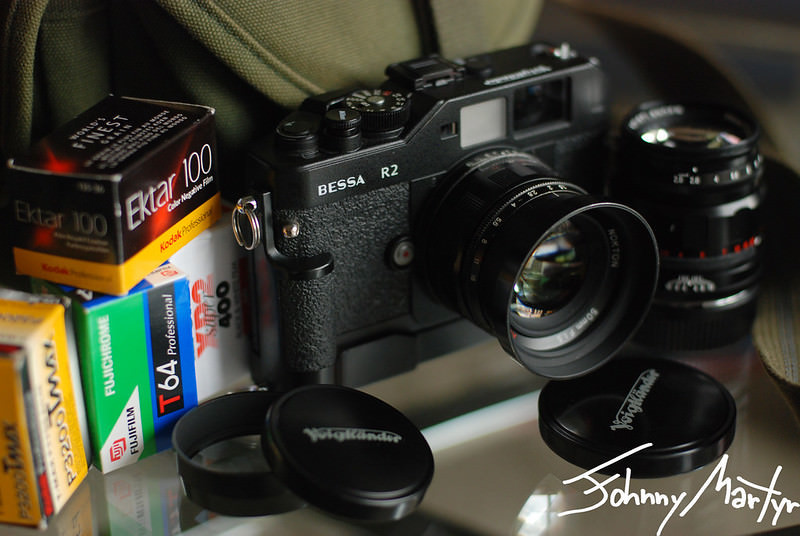

Voigtländer Bessa R2 with 50mm & 75mm lenses, EBL = 25.53mm

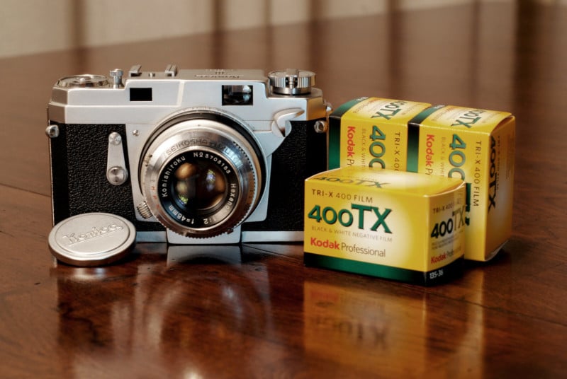

Konica III with fixed 48mm f/2 Hexanon, EBL = Who knows, but probably in the 20s

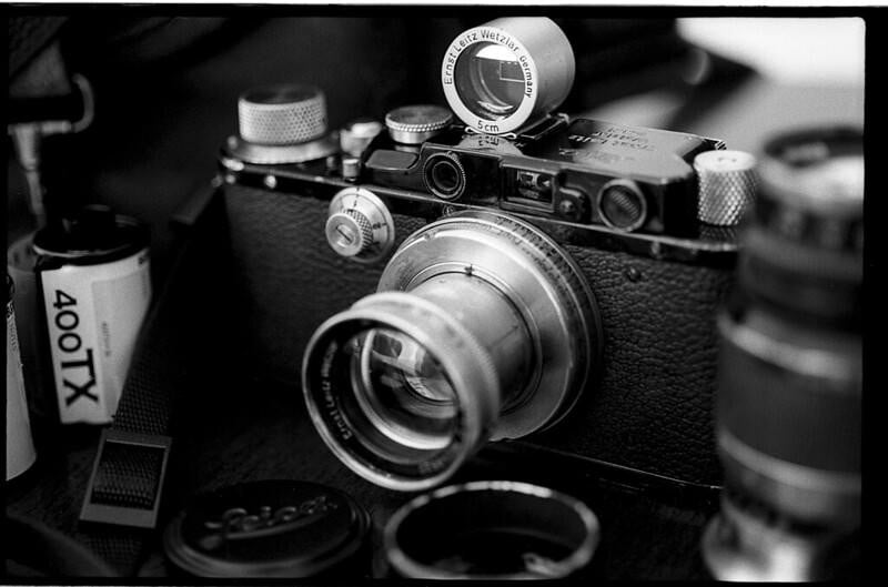

1930 Leica with 50mm f/2 Summar, EBL = 58.5mm
