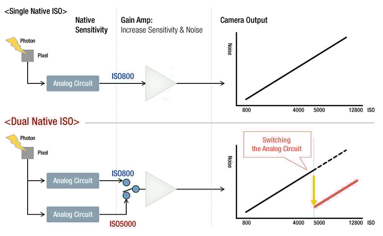

Panasonic describes its “unique technology” as Dual Native ISO:
Dual Native ISO is a unique technology from Panasonic that can be found in the cameras that are part of the cinema camera lineup. The sensor of the VariCam camera has two native ISO settings, 800 and 5000. This means that, simply put, you can take advantage of having two film stocks in a single camera. This allows you to shoot ISO 800 for normal lighting situations, or to gain almost 3 stops with ISO 5000 to capture magic hour or candle-lit scenes; all without any loss of dynamic range, resolution, or color.
a_diagram_showing_what_is_dual_native_iso_technology_found_in_panasonic_varicam_and_eva1_cinema_cameras.jpg
According to McKeegan, Dual Base ISO — sometimes also called Dual-Band ISO — refers to the same idea:
Dual-Band ISO where the camera has two base ISOs. A lot of the Alpha 7 cameras, for example, have a base ISO of 100 as well as a second base ISO at 640. And the reason for this is that there are two lots of circuitry on the sensor: a low gain circuit, and a high gain circuit that is optimized for working with a weaker signal.
