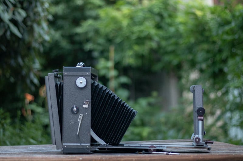

An Austrian-based photographer and educator, Hofstätter likes to bring the old and new together. In his photography, he specializes in collodion wet-plate, which means that he’s regularly working with decades-old equipment that may require certain parts restored. He recently purchased a Mentor wet-plate camera at the Camera Obscura Festival auction and had to spend some time repairing it to bring it back to life, similarly how he repaired a damaged Linhof tripod a short while ago.

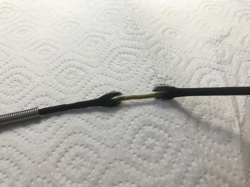

In his latest YouTube video, Hofstätter shows that it is possible to restore damaged equipment back to full working order, even though at first glance old cameras like these could be overlooked and forgotten. First, he had to fix the slide lock before he made repairs to the wobbly plate holder — which could otherwise lead to light leaks — and the cable release. Although the bellows — which is the accordion-like, pleated expandable part of a camera — wasn’t broken, it made a cracking noise so Hofstätter decided to rip it apart and glue it all together himself.
The damaged cable release

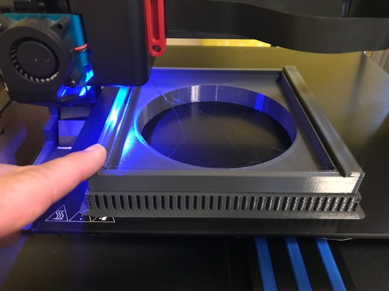

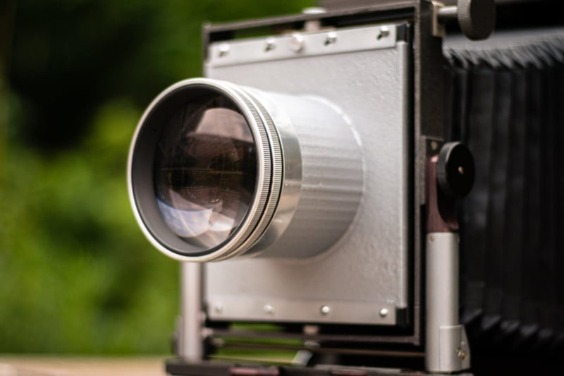

To be able to shoot a wet plate with this camera, Hofstätter had to modify the plate holder and was on the lookout for a suitable lens. He eventually found a fast Leitz Hektor 200mm f/2.5 lens and, using his 3D printer, Hofstätter made a compatible lens port. After four days of printing, he had to add final touches and his new wet-plate set up was ready for a portrait shoot in the garden.
