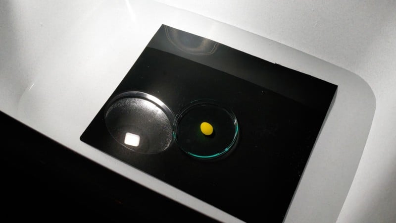

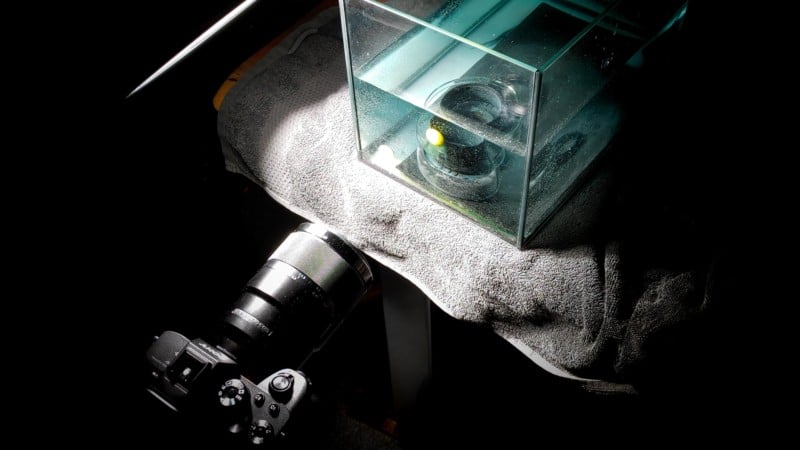

“All you need is any camera, a tripod, a small fish tank, and a petri dish with water,” Heidler says. “Put M&M’s inside [the dish] and take images as the candy is dissolving.”

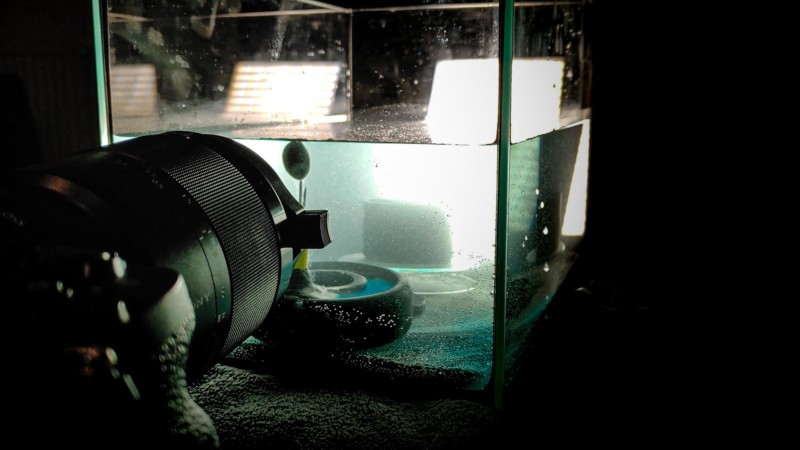

He says placing the petri dish inside the fish tank allows you to separate the M&M from the background more easily, and Heidler recommends using different light sources, backdrops, and angles to create different results.

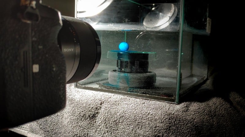

“Most of the shots were taken… with black synthetic material on the bottom (I used an old folder). Using a petri dish allowed me to separate the M&M from the background which boosted the mesmerizing flow of the white sugar layer,” he explains further. “This only works when you are using chocolate-peanuts M&M’s with a thick white layer, otherwise the effect will look pretty boring. The dissolving process works using normal cold water, starts immediately, and lasts for about 3-4 minutes until the white sugar layer has disappeared.”
In the photos below, Heidler’s technique is more visible. The petri dish and M&M are set inside the fish tank and fully submerged.

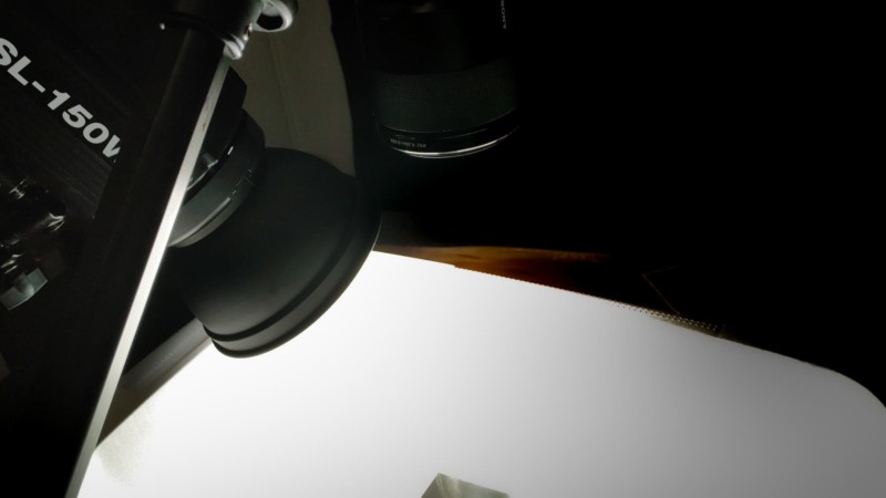

For the needle shots that start around the 1-minute mark in the video above, Heidler used a backlight to make sure the colors and streaks were more visible.
