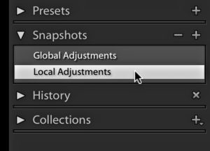

[h=3]Snapshots[/h]If you select a photo and switch to the Develop module, you will find the Snapshots panel under the Presets panel on the left side of the interface. The purpose of a snapshot is to capture a set of develop settings at a given point in time and preserve it in a way that makes it a one-click solution to jump back to that state. For example, you might create a snapshot right after youve made a white balance adjustment, and then another after completing all tonal adjustments, and perhaps another after performing a lens correction. In another scenario you might not want to be so granular and you might simply create a snapshot after all global adjustments have been performed and before you begin certain local adjustments.

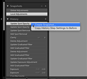

Snapshots can be created several ways. The most obvious way would be by clicking the + sign on the Snapshots panel the moment youve reached a certain state in development. If you look under the Develop menu you will also find the New Snapshot command and its shortcut CMD+N (PC: Cttrl+N). You can also use the History panel by ctrl-clicking (PC: Right-clicking) any history step and choosing Create Snapshot from the contextual menu.

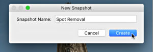

No matter which method you use to create the snapshot you will be presented with the New Snapshot pop-up dialog box where you can give that snapshot a name that makes sense to you. Note that snapshots are arranged in the Snapshots panel in alpha-numerical order.

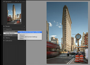

Just like with presets and history steps, as you move your cursor over snapshots, the Navigator panel will display a preview of the image at that particular state of development. You can also set any snapshot as the Before state of your photo so that when you take advantage of the View > Before / After menu you can compare your most up-to-date adjustment against the snapshot of your choice instead of comparing against the state right at import. To do this, ctrl-click (PC: Right-click) the snapshot you want to use and choose Copy Snapshot Settings to Before from the contextual menu. Now just press the \ key to switch between the Before and After and compare your latest work against your chosen snapshot state. Pretty cool!

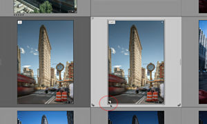

You can create a virtual copy by ctrl-clicking (PC: Right-clicking) the photo and choosing Create Virtual Copy from the contextual menu, or by going to the Photo > Create Virtual Copy menu (where you can also see its keyboard shortcut). A virtual copy has a page curl icon in the lower left corner of the thumbnail in Grid view and the Filmstrip. If you dont see the icon in Grid view go to View > View Options and make sure Thumbnail Badges is checked, or in the Filmstrip ctrl-click (PC: Right-click) a thumbnail and make sure Show Badges is checked under View Options.

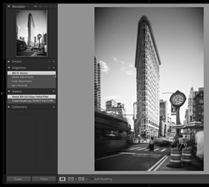

So lets say I want to create a color and a black and white version of the same source photo. I select my original color photo and create a virtual copy via the Photo menu. Now I can take that virtual copy to the Develop module and process it as a black and white without having any affect on the original color version. The virtual copy will start with the same settings as the original photo at the time the virtual copy was created, and while you wont have access to the original photos history steps you will find that snapshots are shared across all virtual copies and the original. That gives me a great deal of flexibility in my virtual copy if I should ever want to go back in time to a previous state of the original and move forward from there. Plus if I create a new snapshot in the virtual copy, that snapshot will be available to the original (Lightroom calls it the master) photo as well.
