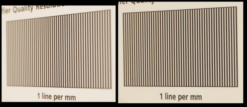

Close (left) and farther (right).
This ruling is angled so its right side is closer. All of these photos were taken at f11. The entire camera is farther away for the right photo. Note the improved depth of field. Moving the camera farther away also reduces perspective distortion.
Above, the second shot was made from double the distance. You can read the depth of field on the ruler.
