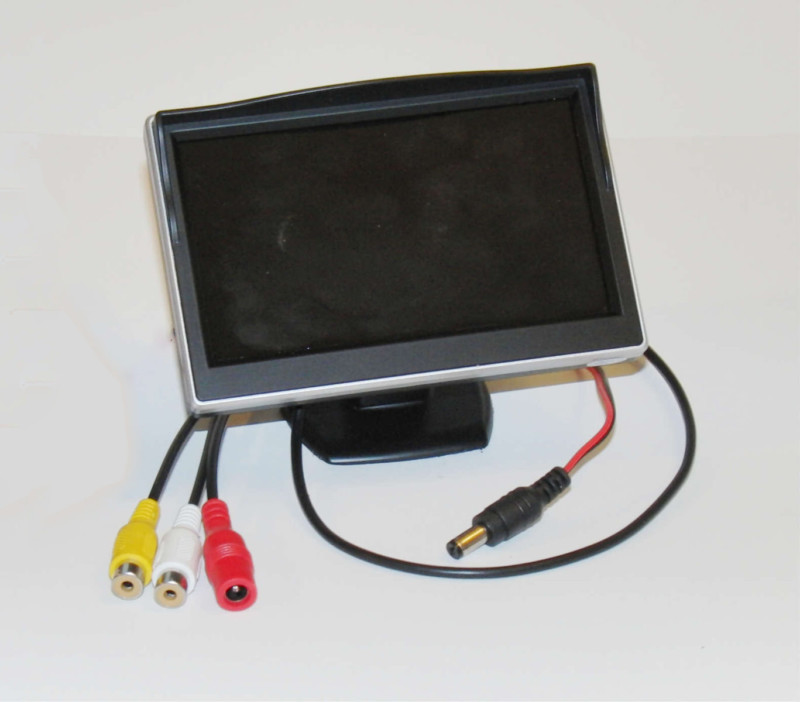

This is what came in the box. The terminal, it’s A/V connectors and a power plug

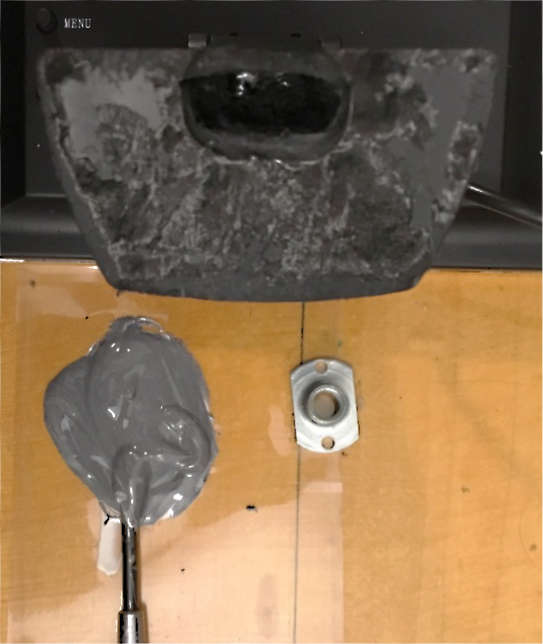

Knowing that eventually I would want to fasten the monitor to something like a tripod I decided to install a ¼ x 20 inch “T” nut on the bottom of the terminals foot. Since the stand was hollow on the inside I gouged out part of the thin plastic bottom cover and glued the “T nut in place.
The thin plastic at the bottom of the foot of the pedestal was gouged out to accept a “T” nut so it could be attached to a tripod or something else.
This is the “T nut. It has a “universal” ¼ x 20 thread.
Since the terminal’s foot was hollow I attached the “T” nut using JB-Weld to cement it in place.

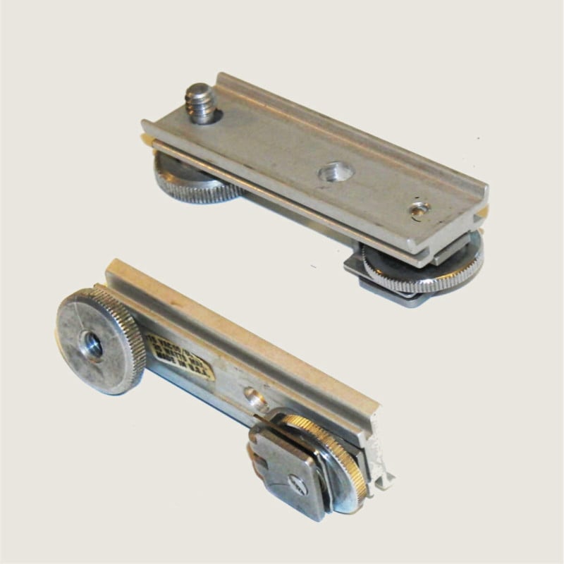

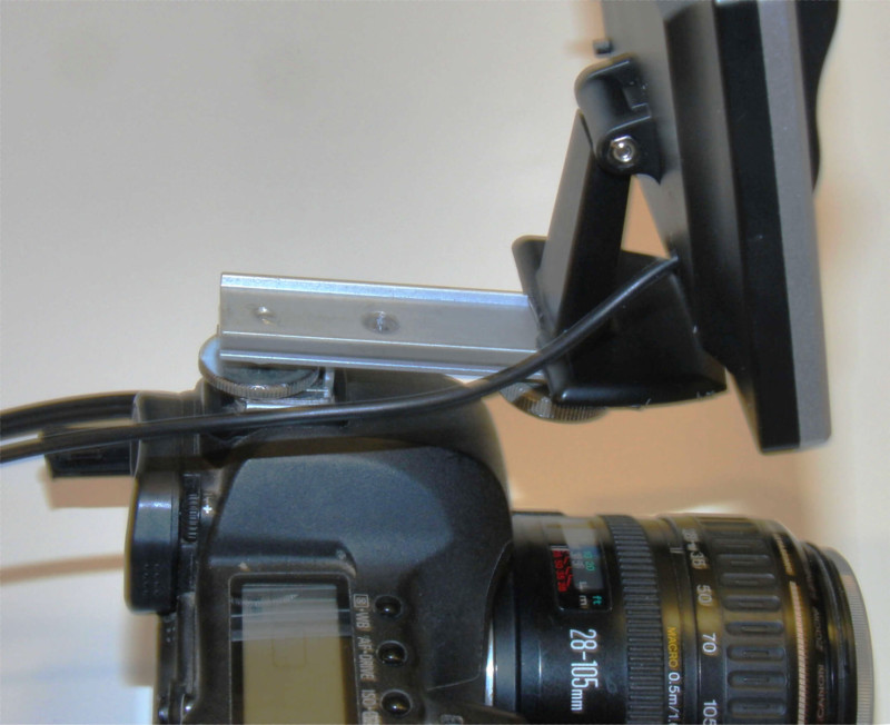

Going further, I found among my left-over items a 3” metal bar with a hot-shoe adapter on one end and a couple of ¼ inch holes drilled along its length. Inserting this into the camera’s hot-shoe would allow me to fasten the terminal to the camera if I wanted that bit of convenience.
I happened to have this metal bar with a hot shoe at one end and a couple of ¼ inch holes along its 3 inch length.
The foot of the terminal could be attached to the bar and the bar inserted in the hot shoe of the camera.

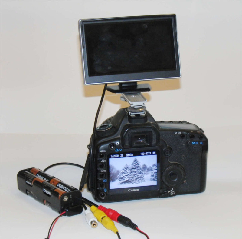

Making the video connection from camera to terminal was straightforward using the yellow color-coded RCA connectors.
The camera’s video out is connected to the terminal’s video-in (yellow to yellow) and the battery pack power cable connected to the terminal’s power socket (red to red) Then here, with the camera’s video out disconnected, the normal operation of the camera’s display screen shows an image of a snowscape.

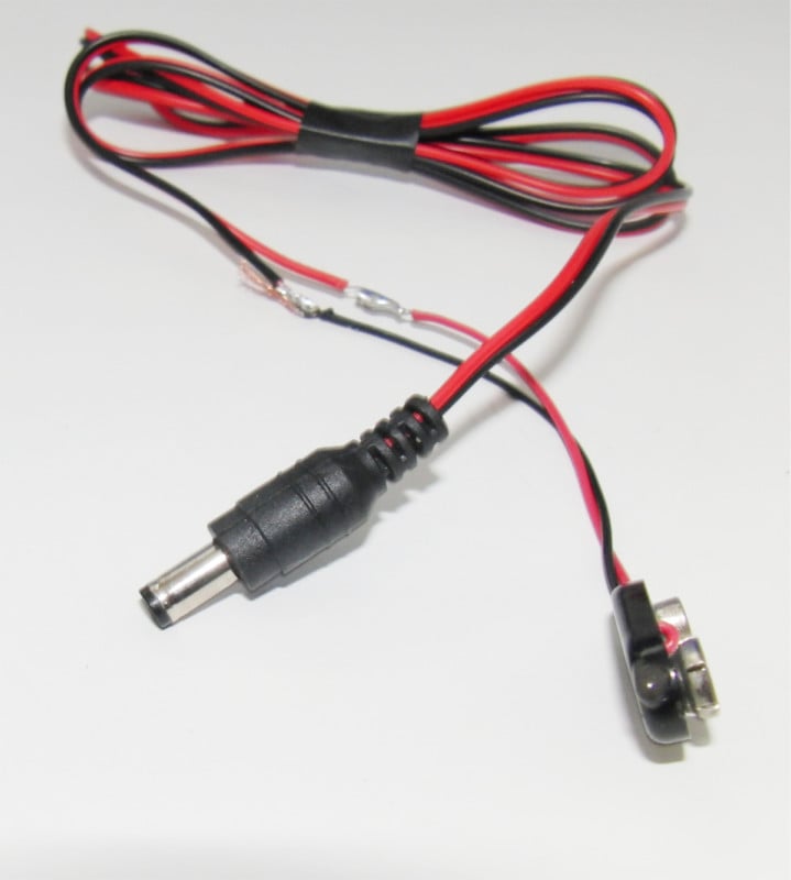

For power to simulate the car battery, I used an 8 pack 1.5 volt per cell battery holder since this would output 12 volts.
To make the battery pack to monitor power connection I used a 9V battery clip soldered onto the end of the terminal’s power supply cable that came with the terminal.
The supplied power cable was soldered to the 9V battery clip. Bare wires insulated with electrical tape.
This proved “tricky” as at first I connected the battery clip incorrectly.
When I made the video connections and attached the battery clip to the battery pack and turned on Live View on my camera nothing happened. Needless to say, I was disappointed.
However, I reversed the polarity of the power cable and suddenly the monitor displayed what the camera’s screen would. BTW, the camera screen goes dark when you output video.
When the video out of the camera is plugged into the camera the terminal now displays the same image as that which the camera’s screen showed before connection.

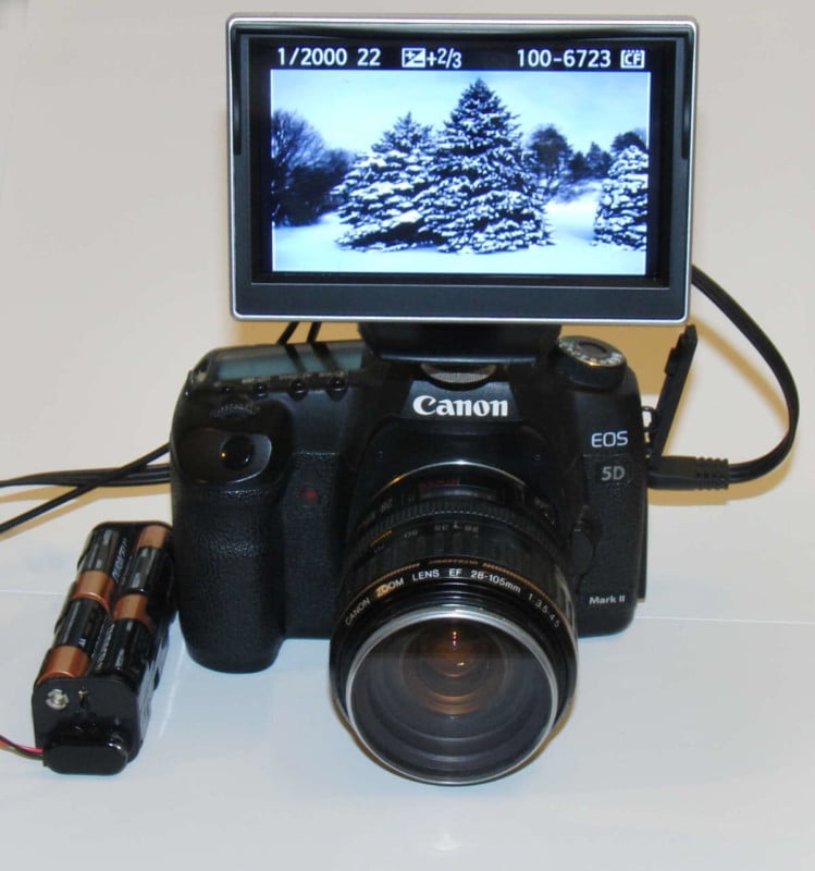

Finally, I could place the camera on the floor or at the ceiling and could easily see what the camera would be recording. Using the built-in image magnifier also let me adjust focus accurately while away from the camera.
Finally the monitor is turned around on the bracket and now the image that was prevously seen from the back of the camera can be seen from the front of the camera. Success!
