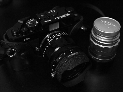

Hi all, finally decided to get a Bessa rangefinder R2M from Chiif today. Here's the handsome fella:
I went shooting after that and went through 2 rolls of film in night conditions, but one annoyance I had with the metering was that occasionally, there were instances where it was near impossible to get the correct exposure and sometimes the EV setting would flicker between -2 and +2 when I changed the shutter speed by a notch. I was using the CV 35mm/f1.2 often at wide open and I could for the most part get the metering right but the problem was acute with the Leica 90mm/f2.8 Tele-Elmarit. Any thoughts on how to get around these issues?
Or I guess a more general question would be: How best to meter in a low light condition with the Bessa R2M? :s
