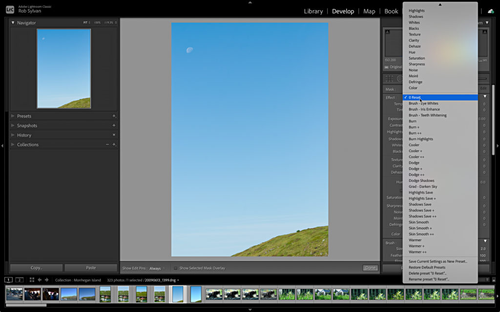

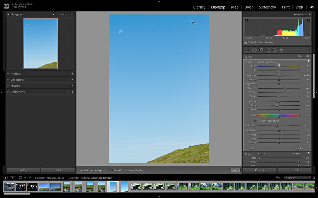

Step Two: Grab the Adjustment Brush, and single-click somewhere at the top of the photo, then select the local adjustment preset you want to transfer to ACR.

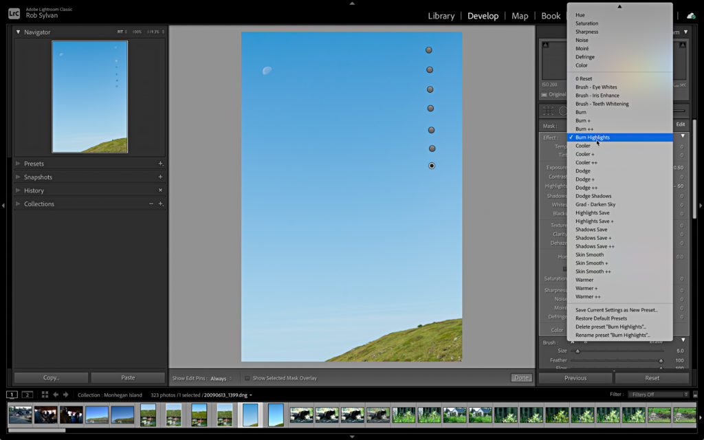

Step Three: Press Enter/Return, to create a new adjustment, and single-click just below that first pin, then apply a different local adjustment preset.
You may be detecting a pattern here. Sure, you could do this one adjustment at a time, but I think this speeds up the process a little. Just be sure to press Enter/Return so that you create a new pin each time, as each pin is where the local adjustment preset will be applied. I did this 7 times, but you can do it as many as you like.

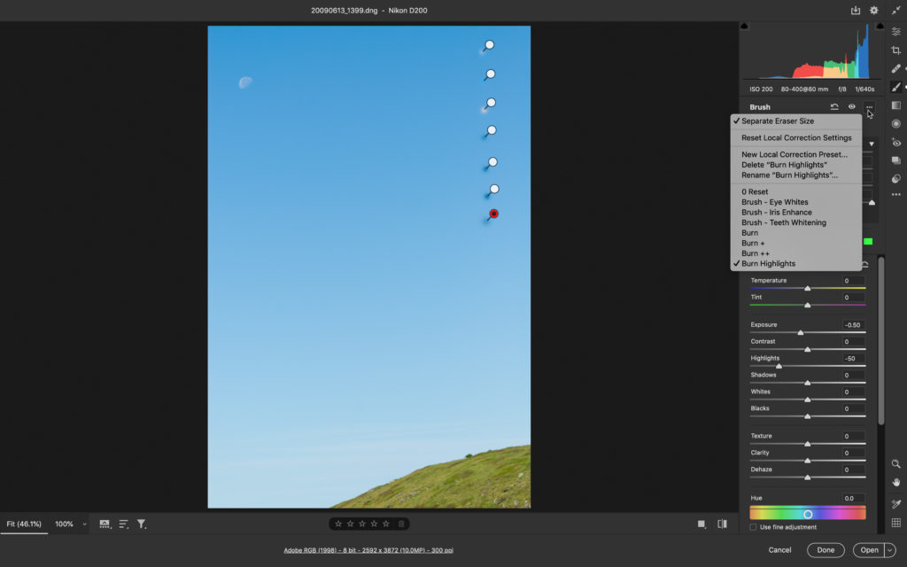

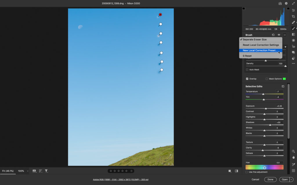

Step Six: In ACR, select the Adjustment Brush, then click the first pin to enable that adjustment. You will see the associated settings of that pin appear in the adjustment brush panel.
Step Seven: Click the three-dot (…) menu at the top of the Brush panel, and choose New Local Correction Preset… from the menu.

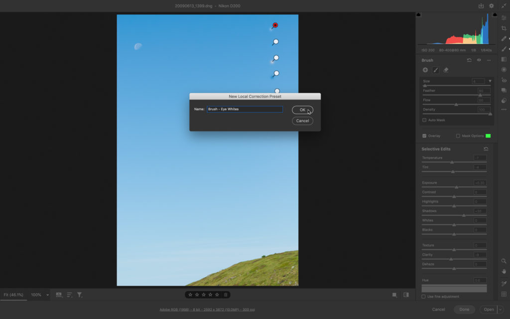

Step Eight: Enter the name for that preset in the resulting dialog box (I just switched back and forth between LrC and ACR to see the names and keep them the same).
Repeat that process for each pin you applied to the original photo in LrC, until you’ve transferred over all of the settings for each pin. Each time you click a pin you’ll see the settings associated with it, and that’s what you use to create the new local correction preset each time.
