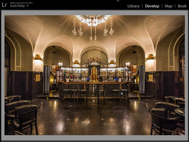

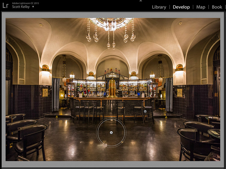

Once you choose the Brush tool (click the Masking icon, and from the pop-down list of tools, click on ‘Brush’), the Brush cursor (as seen above) shows you the actual size of the brush (the smaller circle inside). The larger outer circle shows the amount of feathering [edge softening] applied to your brush. When you see a big gap between the larger outer and inner circles, you have a lot of feathering applied (it’s a soft-edged brush). If the two circles are very close together, it’s a harder-edged brush.
Above: To shrink the size of the brush (the feathering amount moves in tandem with it), press the left bracket key on your keyboard ( [ ) to shrink the brush size and the right bracket key ( ] ) to make the brush size larger (these keys are just to the right of the letter “P” on a standard QWERTY keyboard).
Above: If you want to leave the brush size as is but change the amount of feathering (as seen above), hold the Shift key and use the same left and right bracket keys.
