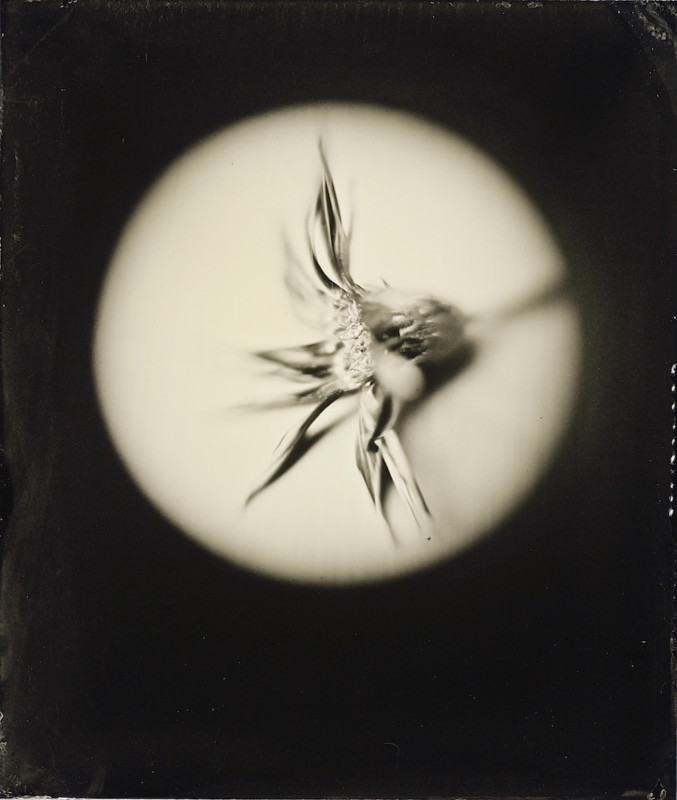

Also, due to such short focus, this optics turns out to have a very fast working aperture, and that means an extremely shallow depth of field. This worked nicely though to exaggerate bokeh when getting up-close with various small organic objects I picked up along my travels, with the flower being the only object specifically gathered for this project.

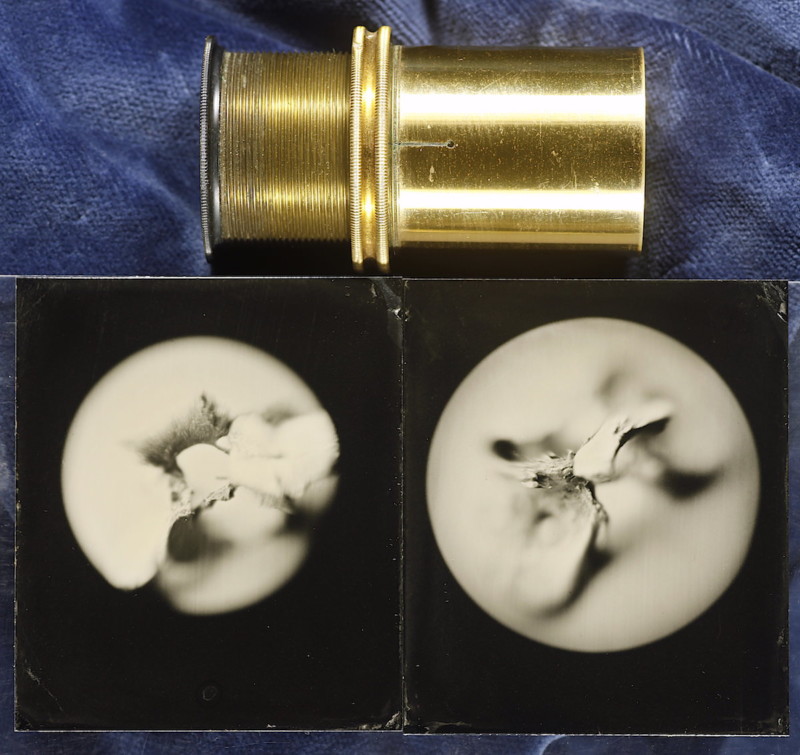

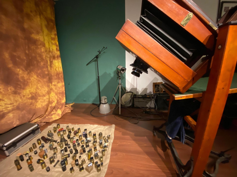

Above you can see the studio setup for most following close-up images, minus the large softbox out of frame view. I started by working outside, but a few plates had odd ghosting effects, caused by light reflecting from shiny brass or lacquered black surfaces. Keeping some of those plates, I later moved indoors for a more controlled environment. Since the glass in these is almost never symmetrical, in order to see possible differences, two images of each object were made with the same loupe: one image through the top, and one through the bottom.
Below images show two tintypes and the loupe they were captured with, with images positioned by the respective end through which they were shot. Each plate is 2.75×3.25in, which is a traditional 1/6th plate size; from that, you can judge the circle of coverage as well as the approximate scale of loupes pictured.
