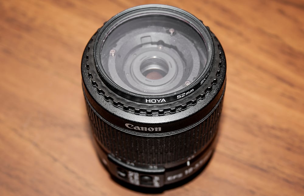

  3. In case you decide to remove the zoom barrel and the filter thread is gone, you can glue the screw ring of a tulip lens hood to the front of your lens, such as I did in the photo below.
  4. Attach a UV or Skylight filter to prevent dust from entering the lens body.
  5. Alternatively you can glue the filter directly on to the lens body to gain a few millimeters more working distance. If you decide to do so, ensure that the filter is perfectly clean, and that you use a glue that won’t leave fume residue on the glass.
The plastic thread of a generic tulip lens-hood glued well to the plastic body of this lens.
