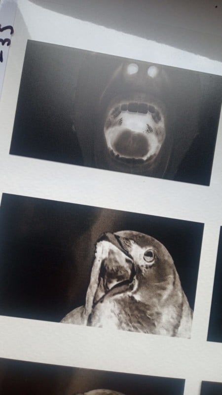

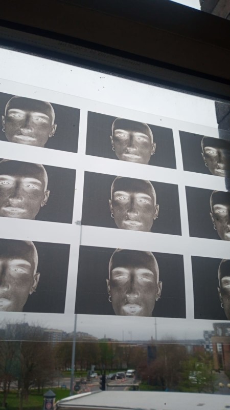

“In total, this resulted in over five thousand individual JPEGs,” Carr says. “These were then transformed into digital negatives by printing them on A4 acetate for use in the cyanotype process (nine frames per sheet of A4).”

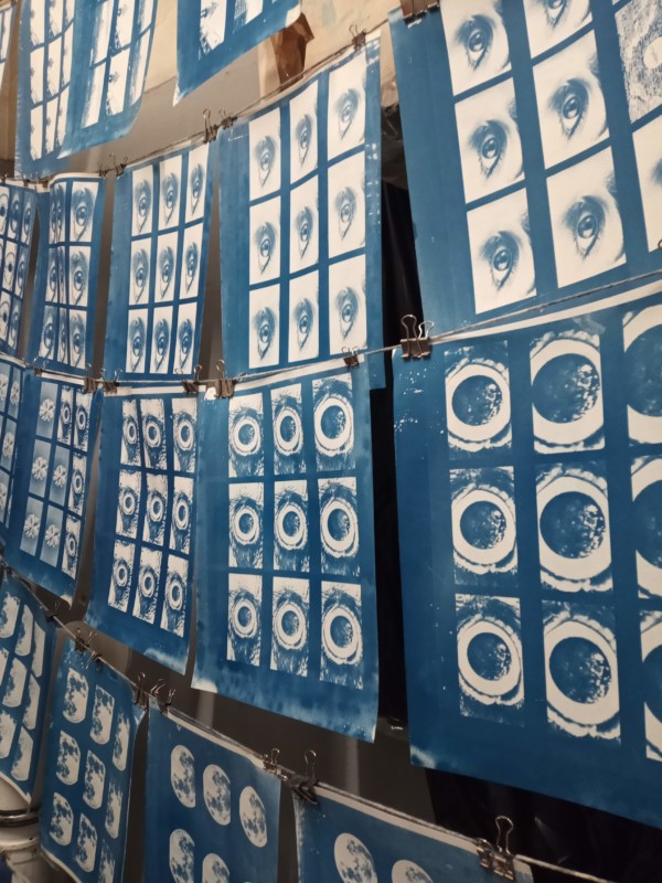

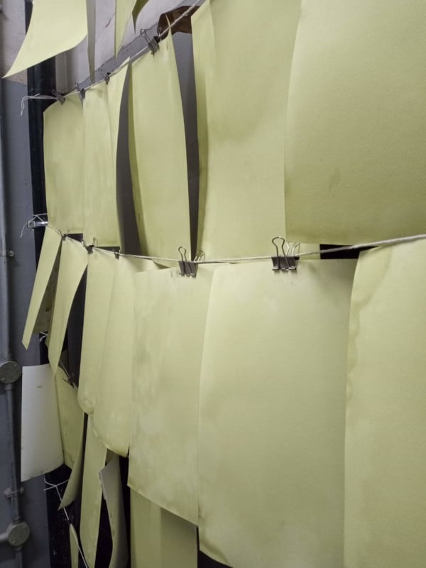

Coating cyanotypes en masse.

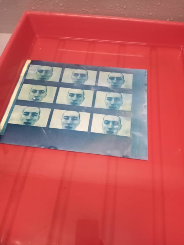

Wash development.
Processing the cyanotypes was, as expected, the most difficult part.
“This took a month, full of errors and changes and mistakes. As cyanotype can fog over time, I had to coat the paper in batches, leave them overnight to dry, and then expose and develop the next day. Typically, I would coat around 100 A4 pages a day, using only one coat of cyanotype solution. I would then allow them to dry, and tape the digital negatives onto them,” Carr explains.

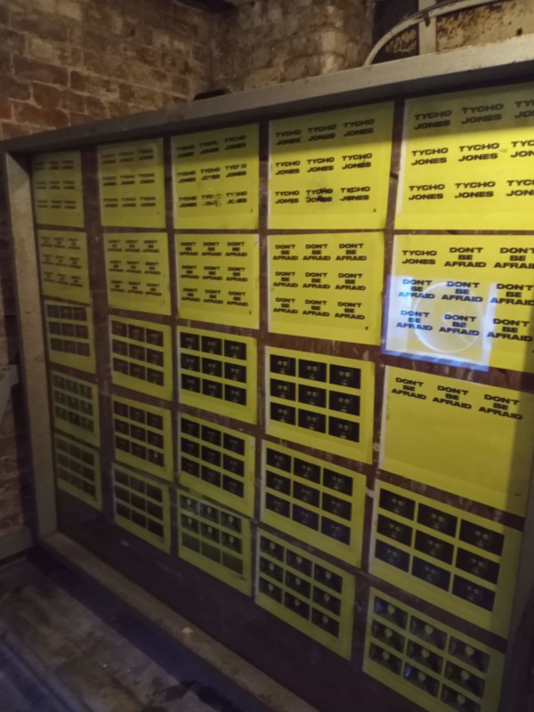

Exposing the cyanotypes.
“These were then printed the following day on a large scale UV bed, in batches of 25. I would then wash them the same day, using two still baths of water (instead of running to save water) and spraying them directly with white vinegar to retain the mid-tones. Overall I printed around 580 sheets, nine frames per sheet, so roughly 5,000 individual frames,” he continues.
