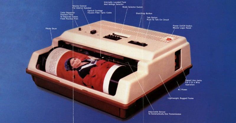

This large device is basically a portable fax machine that would be able to send both black and white or color photographs over long distances using telephone lines. It could also be used to send drawings or printed materials of any kind that could fit on its scanning spool.
Associated Press brochure announcing AP’s new portable photo transmitter for both color and black and white photographs, 1981. (AP Photo/Corporate Archives)
“Sending color photographs is greatly simplified with the AP Portable Transmitter,” the description reads. “A single color print is mounted on the drum and by simple positioning of the desired filter in front of the photo multiplier, the same print is sent three times. One time each for cyan, magenta, and yellow. Of course, the transmitter can also be used to send regular black and white separation prints.”
One of the major selling points was that it only contained two mechanical functions: the rotation of the picture drum and the electronics that moved the fiber optic carriage. The entire machine was powered by an 8-bit microprocessor that controlled the timing, motor, video, and oscillating functions. It also controlled the automatic gain system and would prescan the entire photograph to obtain the best white levels and then set that white output signal to the proper level.
The AP Portable Picture Transmitter was also capable of operating in the AM or FM modes in the laserphoto standards that were used at the time.
While it isn’t small by any modern standards, at the time it was considered to be light and compact as well as durable — it took up no more space than 170 cubic inches.

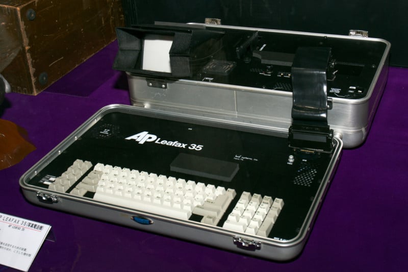

The AP Portable Transmitter looks as though it has more features and was slightly more advanced in its design than the UPI 16-S, though additional information on it outside of this single image from the AP’s archives is thin. What is notable is that the AP eventually switched to a different device called the AP Leafax 35 by 1988, which was more advanced and was housed inside a silver briefcase (which can be seen on the AP’s blog post). It eventually became the proprietary technology of the AP as it was capable of the same functions as the Portable Transmitter but was also a portable negative scanner, the first device of its kind that could perform both duties.
