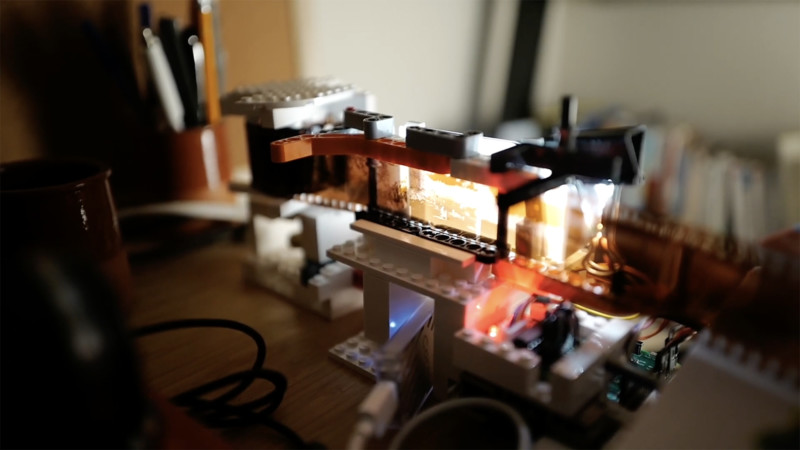

Industrious designer Benjamin Bezine has created a Raspberry Pi-powered film scanner that combines with a film advancer made from Lego and a mirrorless camera that along with machine learning automatically scans whole rolls of film.

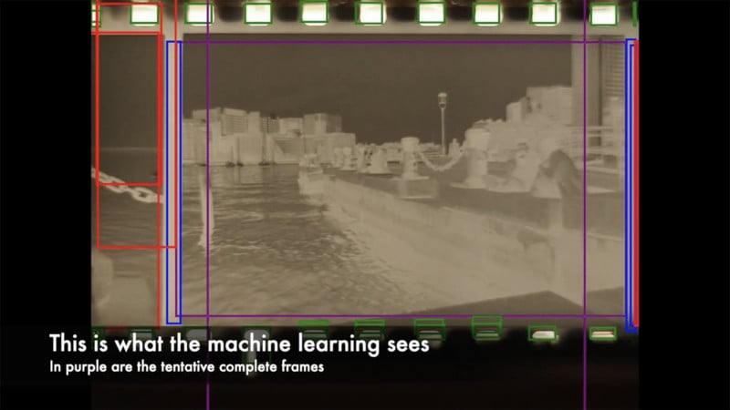

Bezine writes that this is his fourth iteration of the Roboscan device, with the latest model made more efficient thanks to the Raspberry Pi. It uses machine learning to detect when a photo is correctly framed before triggering the camera to fire.

Bezine says that this device can scan a 36-frame roll of film in about six minutes, which includes the transfer of the images to a PC.

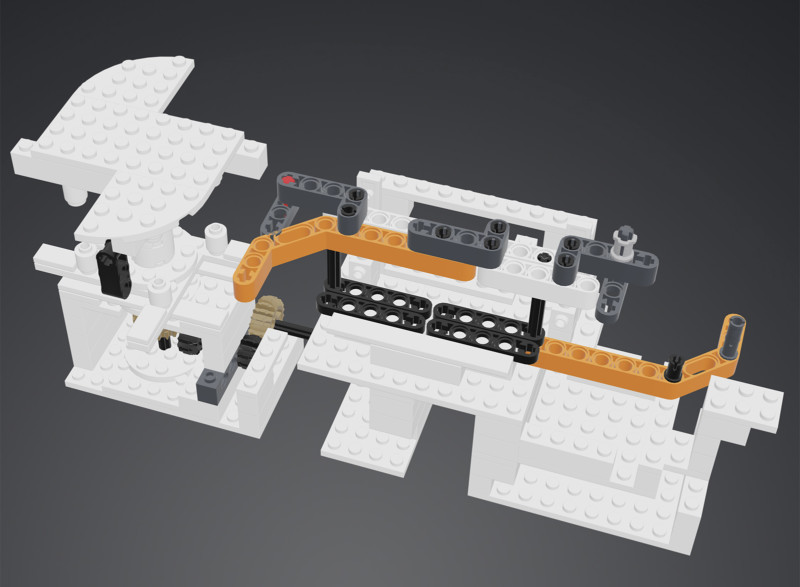

To assist those who want to try and make this device at home, Bezine has published the designs for the Lego brick structure here.
You’ll also need a digital camera with a macro lens that is compatible with libgphoto2 with image capture and preview support, a Raspberry Pi, a stepper motor with driver, a 3D-printed adapter to integrate the motor onto the Legos, a white LED backlight module, an LED driver, a high-power LED, and the aforementioned Lego frame.
