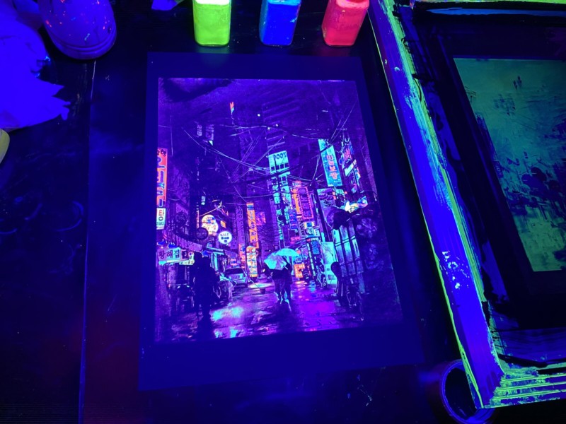

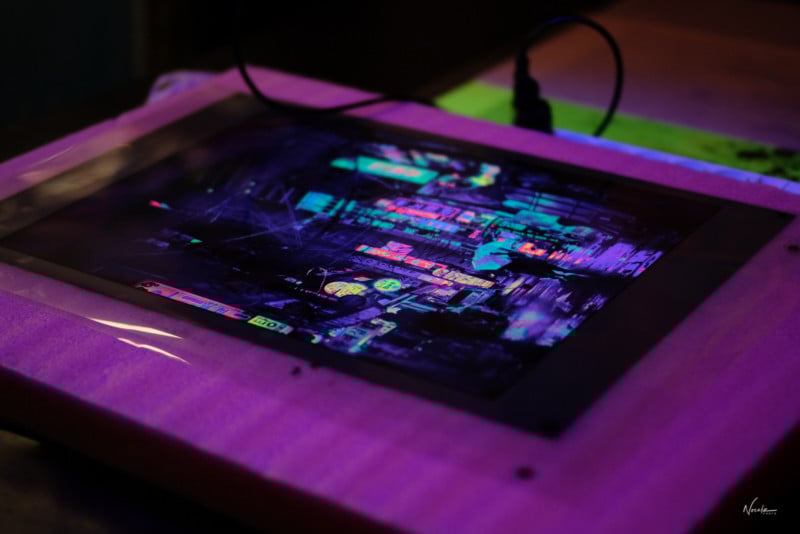

For the lengthy printing process, Blackmarket uses ultraviolet powders and mixes them into a clear oil-based ink as a replacement for basic CMYK.
Using 250GSM matte-black softboard, the printer works from lightest to darkest layers in this ink order: white base, bright yellow, magenta, cyan, white highlights, and finally rich black.
200 mesh screens are used to capture fine details, so the liquids (which are mixed with a slow drying agent) need to be mixed just right to pass through the screen at the correct volumes.

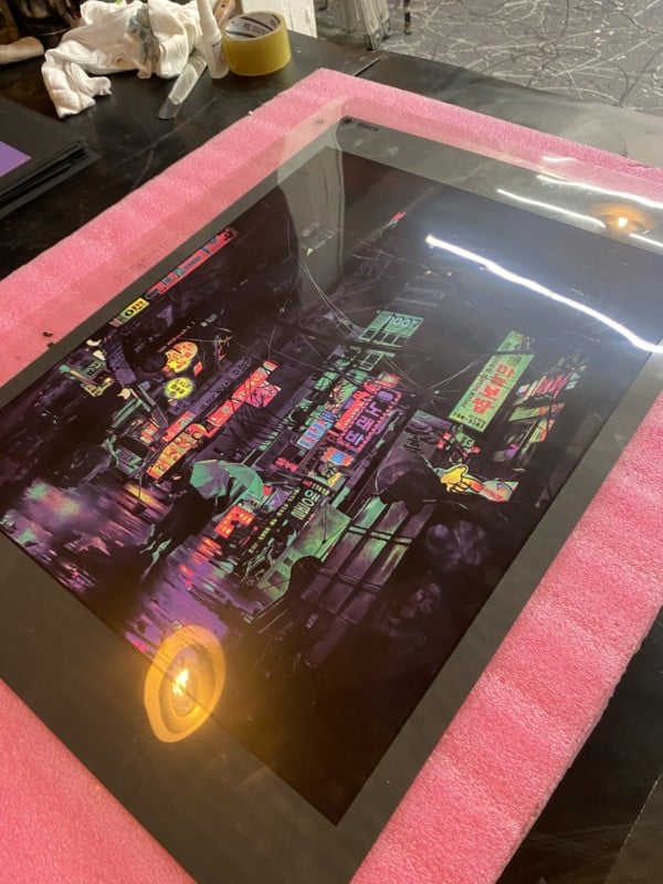

The resulting prints look normal under normal light…
Noe_Alonzo_01_Seoul_Korea_art_silkscreen_silkscreenprinting_silkscreenprints_printmaking_serigrafia_homedecor_wallart_artposter_poster_prints_artprint_2048x-800x800.jpg
Photo by Blackmarket.
Noe_Alonzo_06_Seoul_Korea_art_silkscreen_silkscreenprinting_silkscreenprints_printmaking_serigrafia_homedecor_wallart_artposter_poster_prints_artprint_2048x-600x800.jpg
