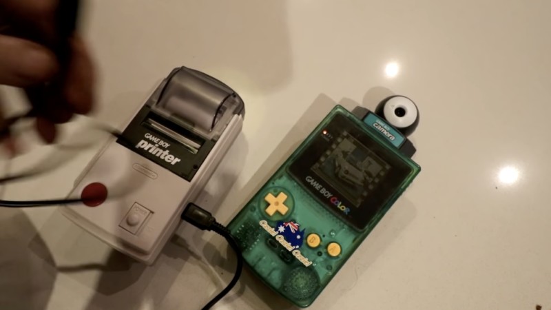

In the video initially spotted by DIYPhotography, Conorsev states there are a few problems with the Gameboy Camera, primarily starting with the fact there is no way outside of using the Nintendo branded printer to get the images captured with it off of the device. The good news is that is no longer the case with a little DIY and an affordable Arduino system.

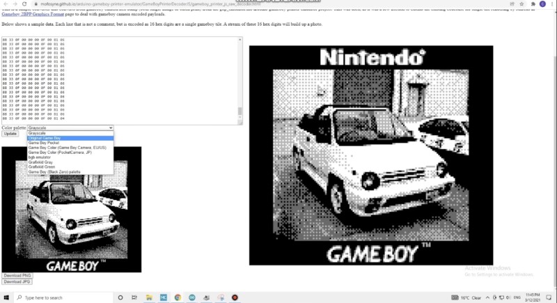

Using the Arduino code, Conorsev was able to trick the Gameboy Camera into thinking it was connected to the Nintendo Printer and capture the graphic information it was sending to print. Then users can simply copy that code into a raw data decoder to turn it back into a digital image file.
