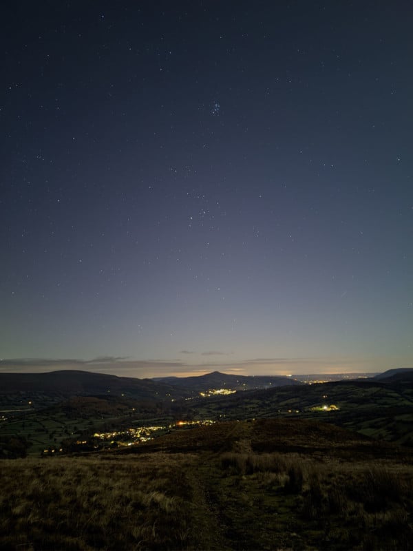

The open star cluster Pleiades (M45) above the Brecon Beacons, Wales. Pixel 4XL. Alyn Wallace

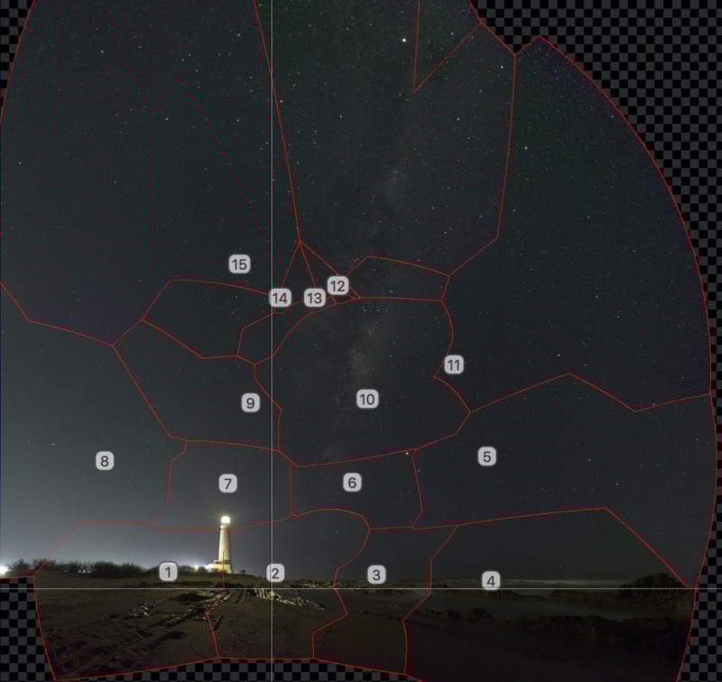

Stitching a panorama in PTGui. Each frame was a stacking of 5-exposures captured on a Huawei P40 Pro. Uruguay. @astropolo_
The resulting panorama is highly detailed and pretty noise free. Huawei P40 Pro. Uruguay. @astropolo_

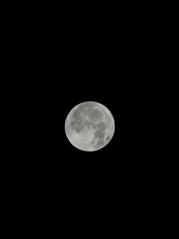

Captured with “Moon mode” on a Huawei P30 Pro. @dakri_und_wer_bist_du
Captured with “Moon mode” on a Huawei P30 Pro. (C) VIs Pat

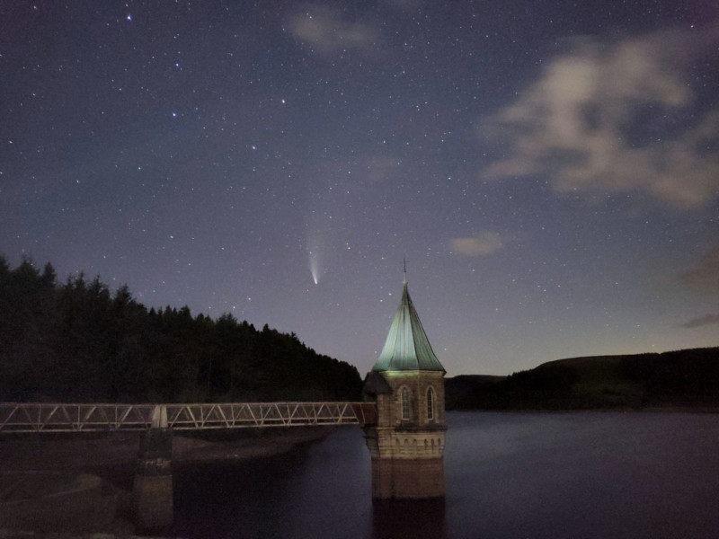

Comet NEOWISE above the Brecon Beacons, Wales, captured on a Xiaomi Mi8. @adamtattonreid

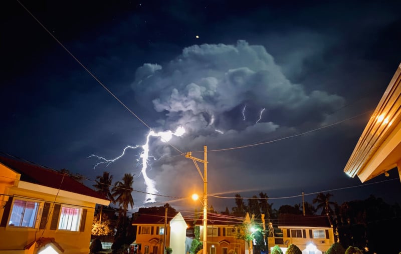

Lightning as Volcano Taal was erupting in the Philippines captured by @eugeneappleseed on an iPhone 11
