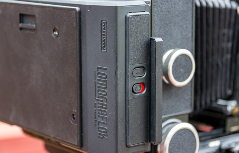

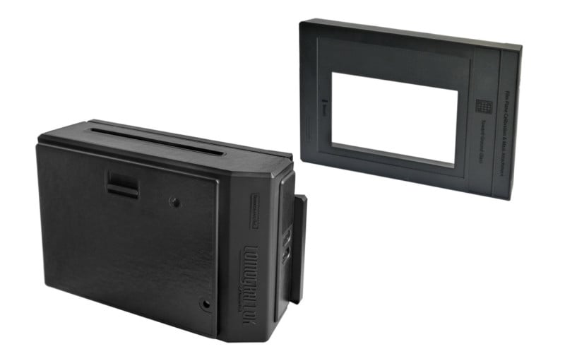

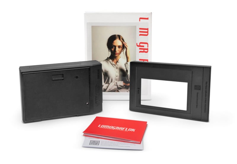

The LomoGraflok is comprised of two main parts: the first is the actual back itself, powered by four AA batteries, in which the Instax Wide cartridge is inserted. It contains a dark slide, an ejection port, a power on/off switch (which also locks the dark slide and prevents accidental ejection), and the ejection button. Secondly is the focus compensation/composition mask. Unlike film holders, which allow the sheet film to be positioned on the same focal plane as the ground glass, the LomoGraflok necessitates a 19mm back-focus compensation.
LomoGraflok back (left) and spacer/composition mask (right)
4×5 sheet film produces an imaging area of 120mm x 94mm, yielding a 152mm diagonal, and a full-frame equivalent “crop factor” of approximately 0.28x. Instax Wide has a 99mm x 62mm exposure area (about 117mm diagonal), which results in a crop factor of roughly 0.37x. So, because of this smaller imaging area, the mask pulls double duty to compensate both for the focal plane shift and to show you the true frame for accurate composition. The back also includes an automatic frame indicator that counts up to ten (the number of photos in one pack of Instax) — this is illuminated with a blue light to make it easily visible in lower light, which is a nice touch.
The back and mask are made of plastic, which is an entirely understandable and reasonable choice given the target price point. Part of me does, however, wish there was an anodized aluminum or perhaps carbon fiber option available. Because of how many steps are involved and how often you need to insert, remove, attach, detach, and so on, it’s incredibly easy for the plastic to become marred and scratched after a few photos (sorry, Lomography, at least you know that it was used).

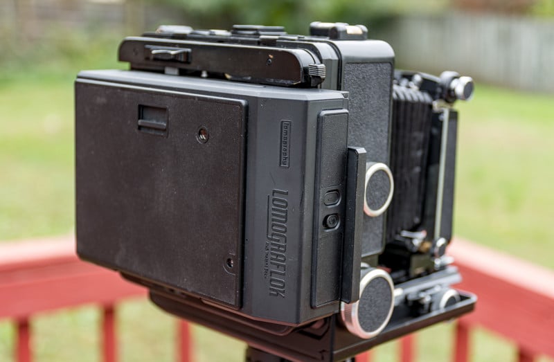

The plastic doesn’t feel the most durable: my camera and tripod ended up taking a tumble when a huge gust of wind came through one day (my fault for not hanging weights from the center column). My Wista’s sunshade snapped off, but luckily, the LomoGraflok was not attached; I’m not sure it would have survived the impact without cracking. But all else considered, this is a very decent price-to-performance ratio.

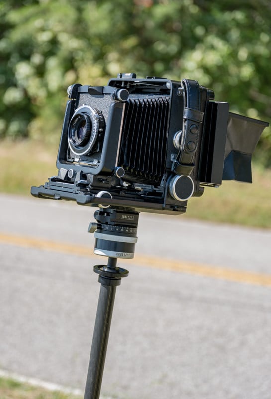

For this review, I decided to use my aforementioned Wista Field 45 instead of my monorail camera, primarily because the latter is incredibly heavy and large comparatively and thus also requires all the attendant bulkier support. Besides, a field camera just feels more appropriate when using something like this. I used my Schneider Kreuznach 90/5.6 Super-Angulon, Nikkor-W 135/5.6, Fujinon W 180/5.6, and Schneider Symmar-S 240/5.6. These yield a full-frame equivalent of about 33mm, 50mm, 65mm, and 90mm respectively on Instax Wide.

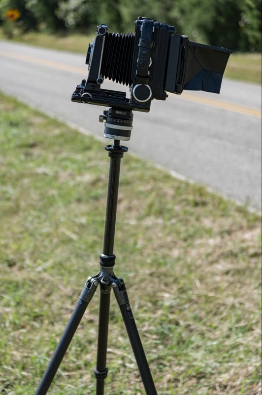

Once you have your tripod — I used my Gitzo Traveler and Arca Swiss p0 head — and camera fully set up and ready to focus as you normally would, there are a series of steps you must follow that diverge from how you normally shoot 4×5 film.
Step 1: Slide the frame mask in front of the ground glass, much like you would a film holder. There are arrows and writing on it to indicate which direction it goes. Lock it in place. Make sure you are sliding the mask in from the right — if you do it from the left, you need to rotate everything 180 degrees, otherwise, your photo will be upside down.
Step 2: Focus and compose via the ground glass. The mask will show only the portion that covers the Instax film and the mask itself is built to compensate for the small displacement in the focal plane. Once you have your composition and focus locked in, slide the mask out.

Red indicates the back is powered on

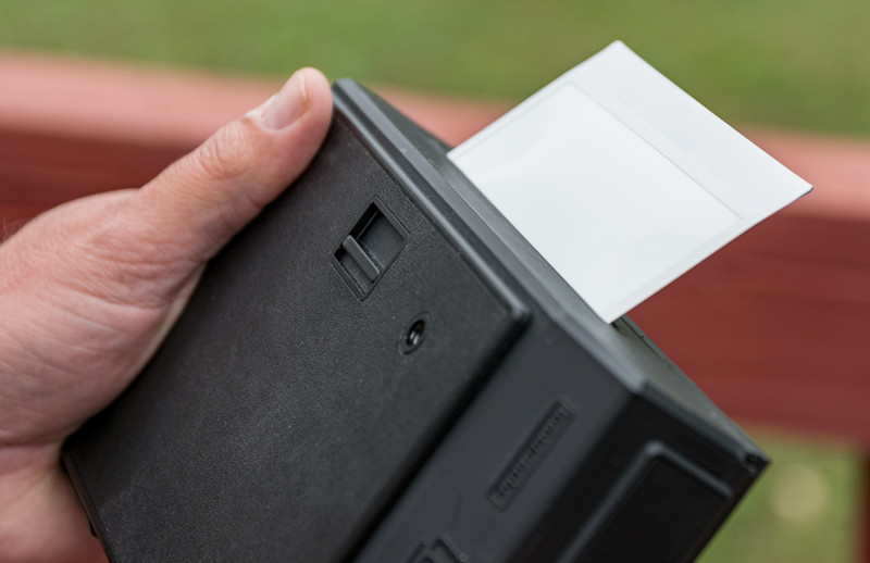

Step 7: Remove the back and eject the film — you can also eject while the back is attached, provided nothing on your setup is blocking the ejection port. Make sure you power the back off at all times, aside from when you are exposing and ejecting the photo. The ejection button is extremely easy to accidentally press — I lost about seven or eight photos to accidental ejection.
