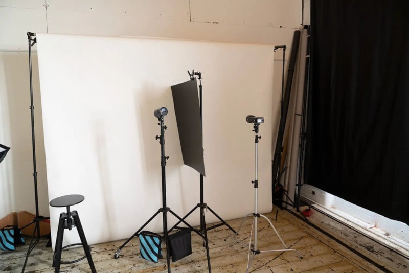

While this was by no means laboratory conditions, I did everything I could to control all of the variables.
Two flashes were placed side by side, about 1m away from a white backdrop. I then used a flag to separate the two lights. No light was spilling from one side to the other.
  • White balance was set to ‘flash’ in camera.
  • Shutter speed 1/250 to kill all ambient light.
  • Flashes were placed close to the background, so no light pollution could occur.
  • A SpyderCHECKR was used to white balance from.

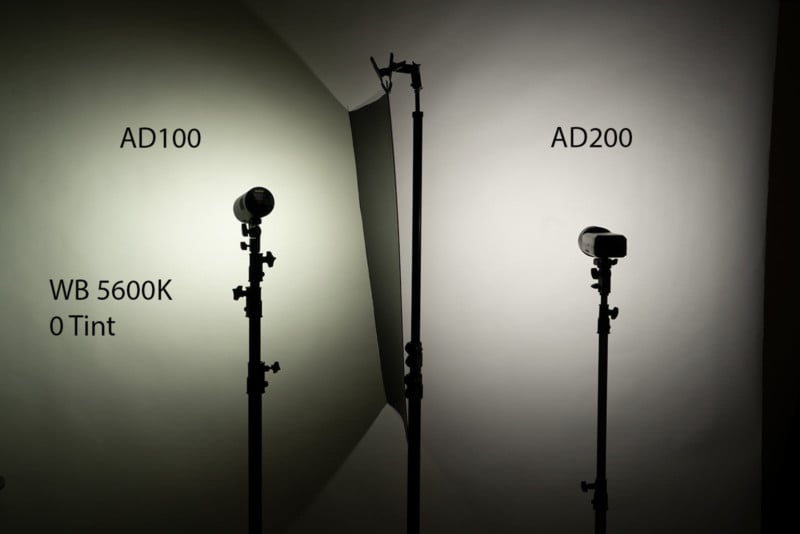

As you can see, the AD100 produces a very significant green cast when side by side with an AD200 Pro. (Note: I had a round head on the AD200).

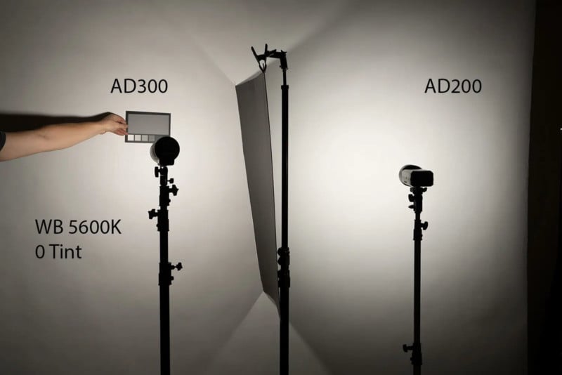

Compare this to the AD200 and AD300 units:
Here, the colors are virtually identical. I also tested an ad600, which matched up with the ad300 and ad200.

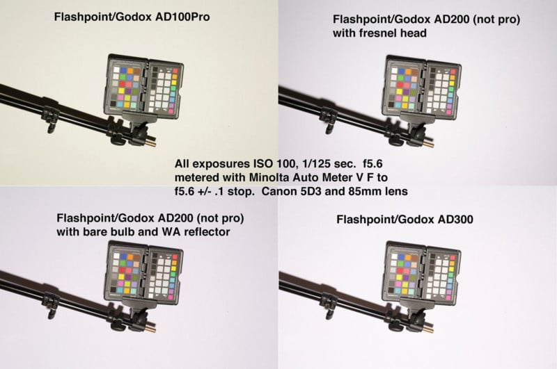

Thinking I might just be having a bad run of luck, I posted on a Godox group on Facebook.
A few others posted up their sample images:
Courtesy of Steve Kershaw. AD100 on right, AD200 with roundhead on left.
Courtesy of Jeff Behm.

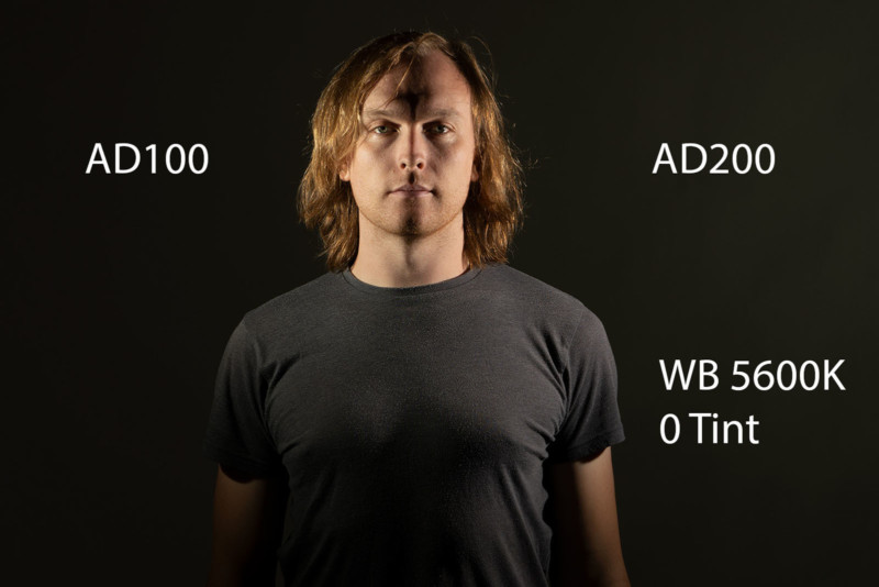

What’s the Big Issue?
If you’re thinking it can be fixed in post… well, sometimes. If the AD100 was the only light source for an image, the green tint could easily be balanced out.
However, I find that the AD100 isn’t really powerful enough to use on its own. This means I use it in combination with other Godox flashes, which creates an issue. Any light coming out of the AD100 will be tinted slightly green.
To correct this you need to add pink to the photo. Any parts of the photo with correct color to begin with will now become too pink.
There’s no way that you can win. One part of the photo will always have a strong color cast.
The above photo illustrates the point. On the skin, you can clearly see a difference in tint, from one side of the face to the other.

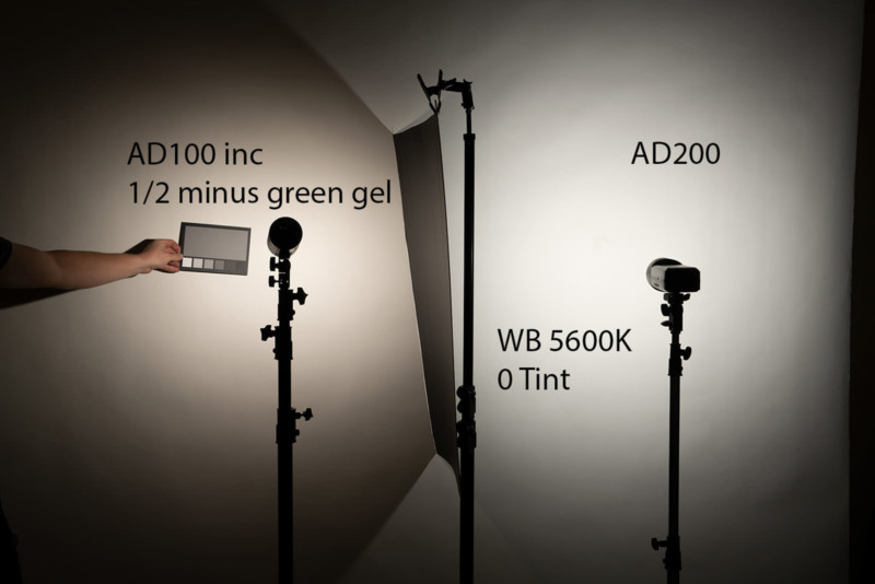

In my own testing, I found that a ½ minus green filter will nearly fix the color cast.
It’s not perfect, but it’s close enough to make it useable.
Notice that the AD100 is still slightly warmer than the AD200. That’s because the AD100 is spec’d at 5800k, and the AD200 at 5600k. (This might be fixable with another gel, but I haven’t looked into it yet).
