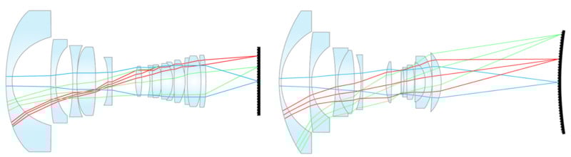

“The imaging of extended scenes (wide field), has always been a challenge as optical systems naturally curve the focal surface,” Curve writes. “The bending of photographic plates has been used routinely in many fields, even astronomy with the use of Schmidt telescopes which naturally have a convex focal surface.”
“The advent of flat electronic sensors has been a revolution, forcing optical designers to introduce additional optics to fit the flatness of these sensors’ surface,” the company continues. “The classical problem of the planisphere appeared then: a huge distortion is created by the imaging system on the edge of the field. Additional complexity came along with the distortion: field flatteners increase the volume and mass of systems, and chromatic aberrations appear. Also, the imaging response is not uniform across the field.”
In summary, lens manufactures go to great lengths to combat the issues that arise from using a flat sensor, namely introducing field-flattening elements that make lens designs larger and more complex. A curved sensor emulates how the human eye works and would theoretically make lens designs much simpler by removing the need for aspherical elements.
