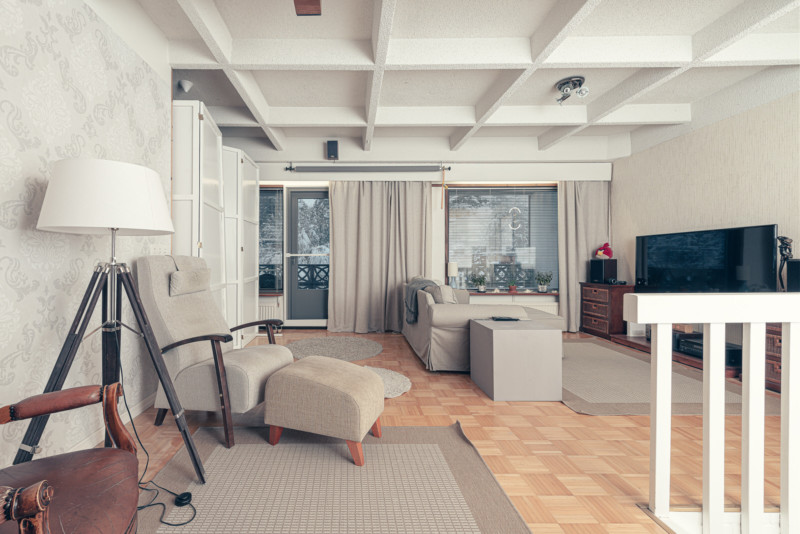

The home studio space before conversion. Living room mode.

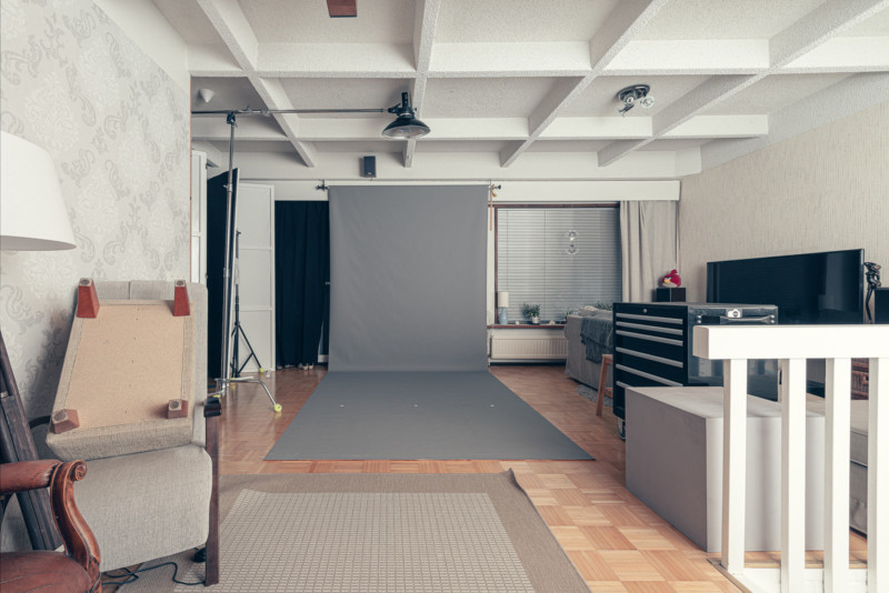

The home studio space after conversion. Home studio mode.

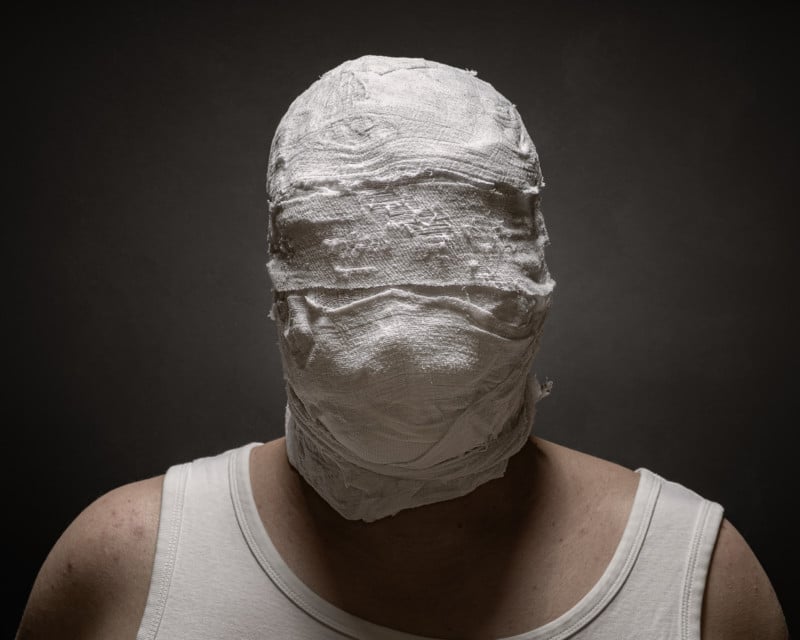

I often like my characters to not have eyes showing in my images. I think that the character is a much more impersonal and image-less portrait when the eyes don’t show. It kind of gives more room for the actual story in the image.
I ended up using a simple outfit with a sleeveless shirt, trousers from the army snowsuit, and a mask. I wanted it to be clean and not colorful so it won’t take too much attention. The shirt and trousers were easy to obtain but a mask I had to make myself.

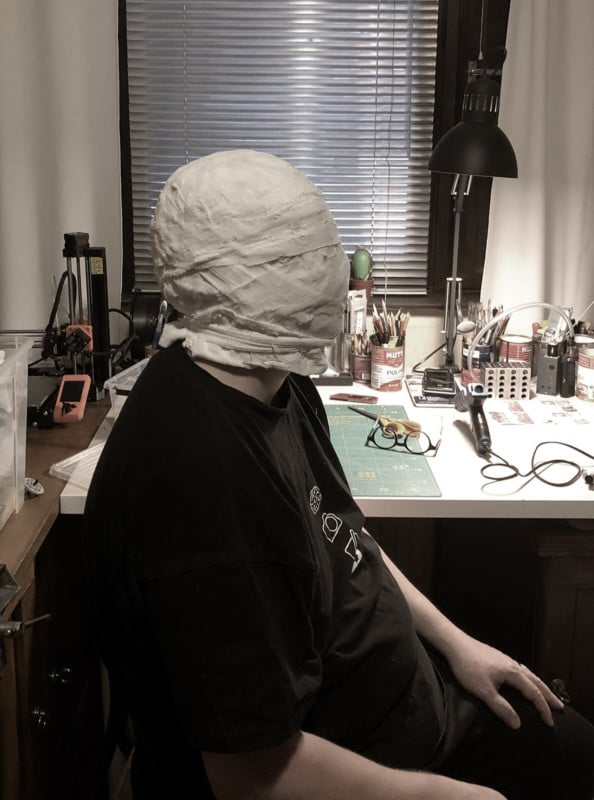

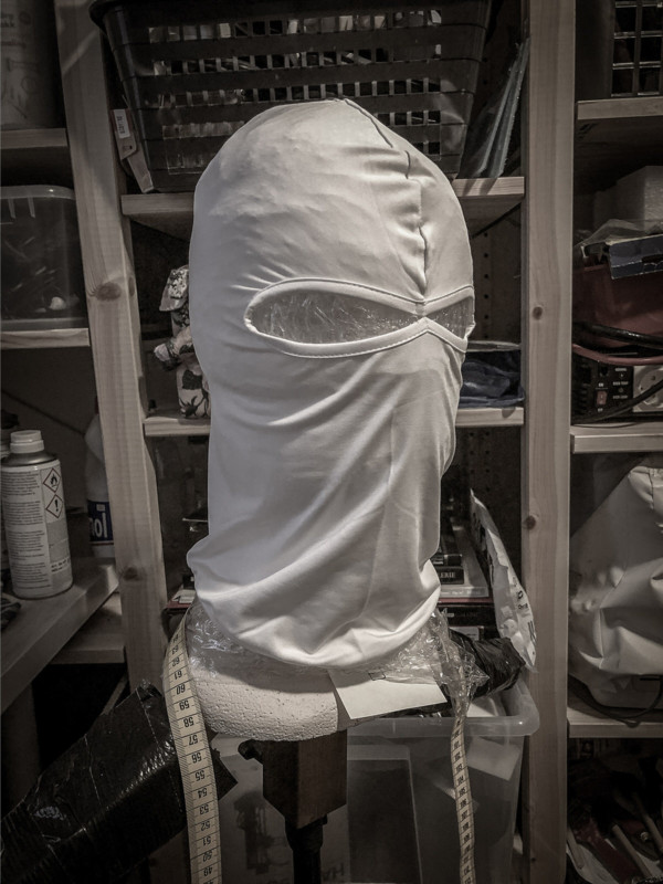

Since this is a self-portrait series and I’m working in a home studio on my own. I have to take the mask off constantly after usually five frames (visibility in the mask is very limited as is expected). So wrapping the bandage was not an option for every shot. After some DIY work, I managed to get the look I wanted to a mask that is relatively fast to put on and take off.
The mask.
Fitting.
The base of the mask.

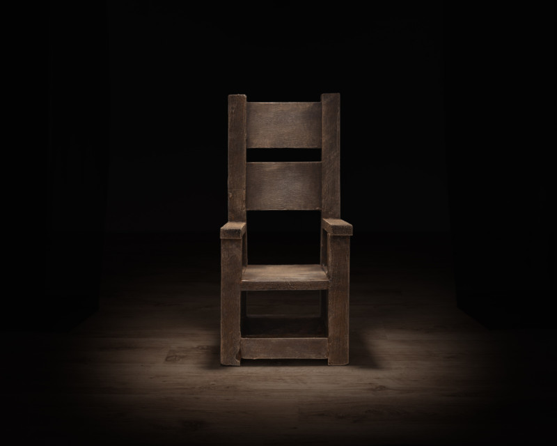

“Haunting Thoughts.” Chair is 1:6 scale, “helmet” is a kitchen bowl and conduits are shower hoses.
