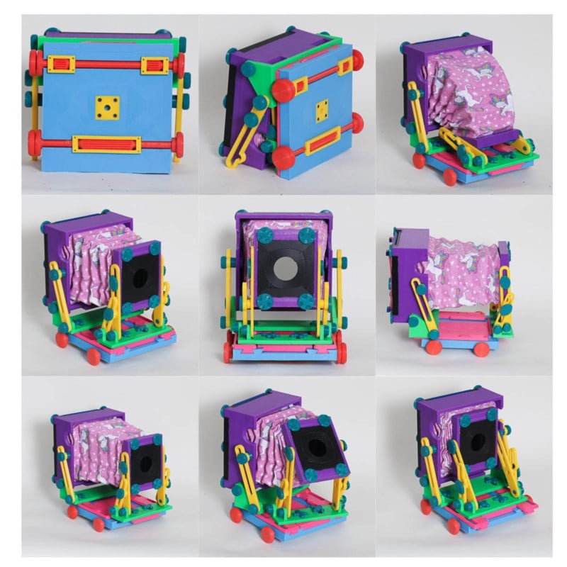

A while back I made a medium format camera that took Mamiya Press lenses and Mamiya RB67 or Graflex backs. I surprised myself a handful of times during that design process, and ultimately produced a camera that I genuinely love, and love to use, and I think lots of other people do too.
I won’t go into that camera in this article (see above link for the full blah blah on that), but it sets the backdrop for the Brancopan.
I had a lens mount that worked really well, was super sturdy and took lenses that covered big negatives. How well it came out was one of the things that really surprised me. I even started selling that lens mount by itself to homemade camera builders (people who just wanted a great Mamiya Press flange to mount on their most excellent homemade cameras).

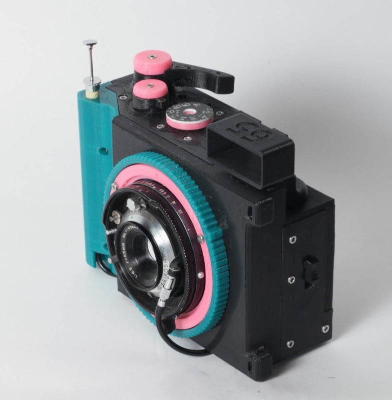

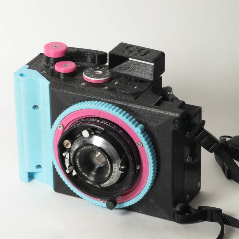

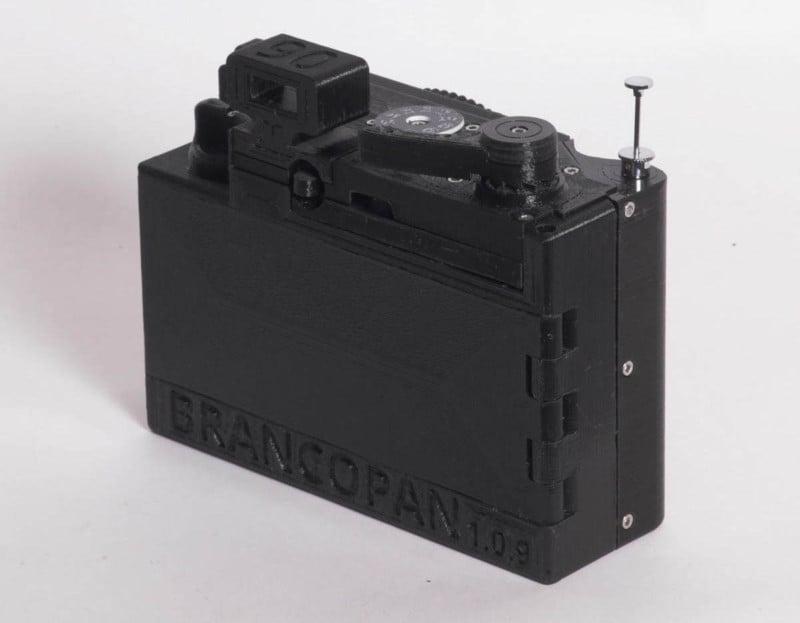

I spent a week designing, printing, testing and modifying different ratchet mechanisms. I could have just made a wind knob. I could have done that in a few hours, but that wouldn’t be good enough for me, let alone Mr. Hollywood. I needed a ratchet scheme that would be durable enough to spool thousands of feet of film, one frame at a time. In the end, I used a very similar design to some mountain bike parts.
I researched patents and designed a totally unique mechanism for disengaging the wind-on gears so that you can rewind the film back into the canister. That trivial little latch, or sprung button on the bottom of your camera, the one you press to rewind the film, that took someone weeks to design.

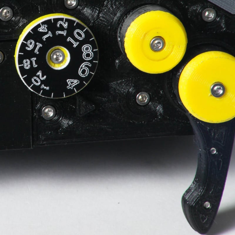

I designed an entirely separate gear train, that would be pulled along by the film, metering out the distance between sprockets, and stopping the winder at just the right spot for even frame spacing. Eat your heart out, 1990s Kiev Camera Export models! I added gears and a dial to that mechanism to add a frame counter to the system.
The frame counter is interesting in an odd-ball way that really tickles me. In most film cameras with which we are familiar, the frame counter will advance just 1 detent each frame. The way this is done is with some sort of an intermittent motion gear set. If you want to know more about intermittent motion mechanical systems, there’s a ton of great info out there in clock and watch design. I also know a thing or two about cars. Lots of intermittent motion machines require engaging and disengaging pieces or sectors, or standing pins on gears.
Generally, when you break a car transmission, it’s not while the transmission is engaged, it’s damage and wear caused by meshing and un-meshing of gears. All this is to say that much like car transmissions, and the hearts of men and women, small camera gears take more wear and stress as they begin or end their interactions with one another.
I designed the frame counter dial gears and the film spacing mechanism gear that mates with it to never disengage. This keeps the entire mechanism moving smoothly because there are no mesh points to encounter. Because of this feature, instead of the frame counter ticking over one detent, it rotates a full turn plus one detent each time you wind a frame. It’s not something I think the average user would notice, let alone think about, but its something just a little different that has a purpose. It’s just a little trick I used here to get plastic to do the job of metal, without the strength or precision of metal parts.

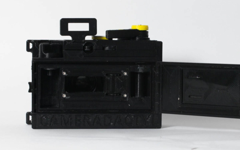

I designed a door with a built-in light baffle, a hinge, and a sprung latch that can be opened with the press of a button, but also locks tightly and most importantly: doesn’t leak light.
I originally designed the camera to use two small springs from a supply of HVLP (high volume low pressure) spray gun repair parts that I had bought as part of a truckload of equipment in a deal years prior. Eventually, I destroyed half a dozen Bic pens to harvest and test their springs, so that I knew everyone would have access to camera springs. One for the door latch, one for the frame spacing mechanism.
I repositioned them onto one side of the body, but I stole the super sturdy beefy strap lugs from the Homonculus.

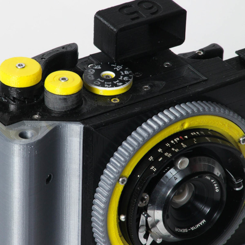

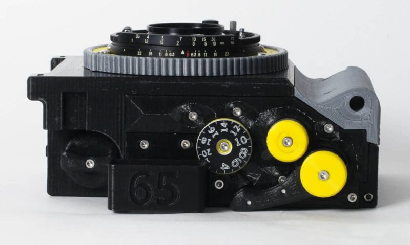

I designed a big sturdy body with inner and outer plates that hold all the gears in place. The gears and latches and ratchets are all printed oversized, meant to be tough above all else.
I usually design individual mechanisms outside of a camera first. It’s just much quicker to build and test an arbitrary block with a ratchet in it, rather than a camera. Once I have a bunch of working mechanisms, I will begin to integrate them into a camera body and get them all to play nice with each other.
It took me 3 tries to get everything to go together inside a body. That means 26-27 hours of print time for each body alone, or 60-70 hours of print time for each set of parts. Each time a set of parts would come off the printer, I would trim and assemble them, measure them, work a mechanism back and forth and feel and look closely for pinch or wear patterns. I would make notes, then modify my model, print, repeat.
The first time I printed a Brancopan, I made 5 pages of notes.
All checkbox, to-do lists of engineering and tolerance changes. The second time I printed and tried to assemble a camera, I think there were only two or three pages of changes. I got to body #4 by the time it all fit and everything moved well. Body #5 or #6 was the first camera to assemble as a camera and also function like one. It had light leaks and other issues, but it was very close. I think I went a few full time, round the clock, printer tending months, to get to about 9 bodies together before I started building working cameras.
I guess I’ve gained a bit of confidence through experience, that mechanical interactions exist in the world, and so they can be worked out again, that gears and levers and cams and such, can be made to do my will. I don’t know if I would have ever gone this far even a year ago, given my initial failures. Now it really seems weird to call them failures, just gathering data, part of the prototyping process, something to be worked through.
After a few months, I made a Brancopan for myself in CAMERADACTYL PRO colors – pink and baby blue – and shipped Eric an all-black camera with his name on it, just before he started shooting his feature on film. Only about a month and a half more than I originally had thought it would take me.

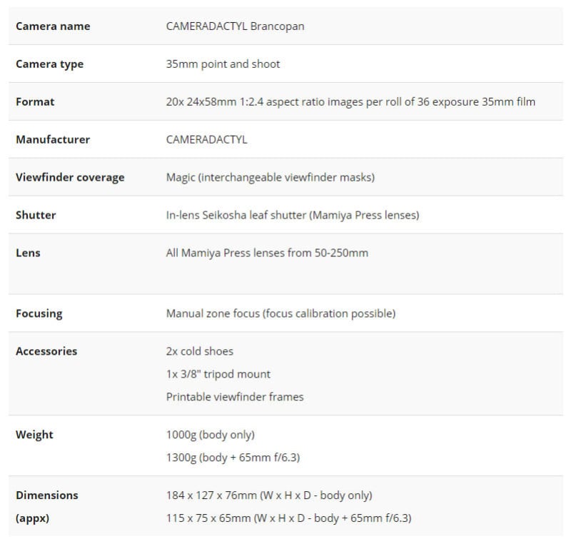

Broncopan Technical Specs

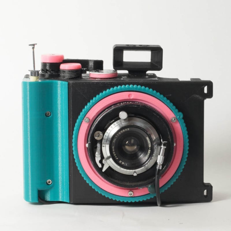

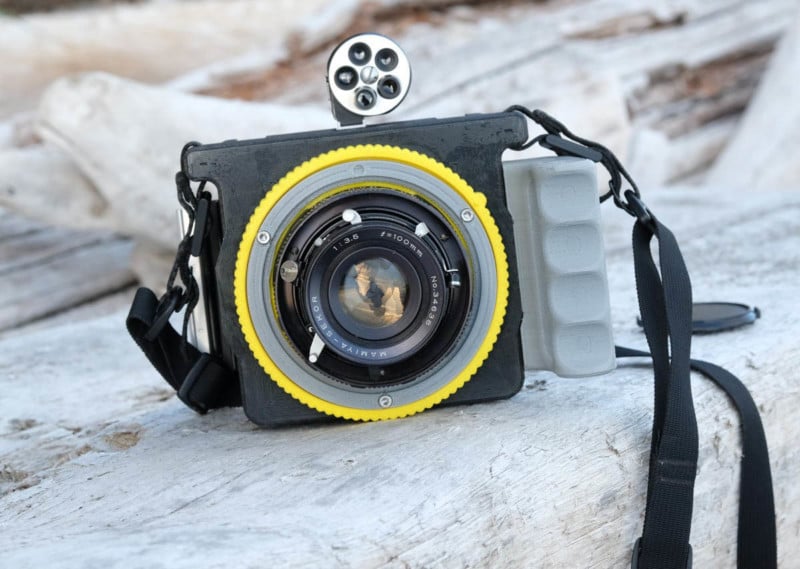

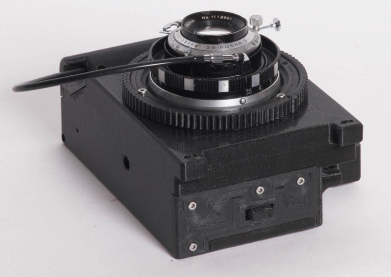

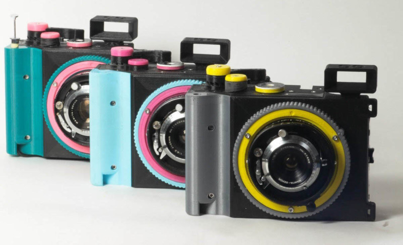

The camera takes 35mm film, in any standard 135 cassette using a standard film leader. It takes Mamiya Press lenses, which are available in focal lengths ranging from 50mm to 250mm. I love the 90mm on the HOMONCULUS, but for the Brancopan I really like the 65mm. It’s an f/6.3 as it comes, but there’s a little plastic tab that limits the aperture, which you can pry off. If you remove the tab, the lens becomes an f/4. I wouldn’t point it at any point light sources like the sun or a bulb at apertures below f/6.3 though, as it will flare unreasonably.
The camera shoots 24x58mm size images, which is 1:2.4 or Cinema Anamorphic aspect ratio, a really common cinema format. I really hope that the camera will be adopted by cinematic panorama shooters. I’m really waiting for someone to make some great use out of it with a color cine film like Cinestill 800T, I have visions of neon alleyways and trenchcoated detectives at dusk…
The camera has a frame counter and a lock at every frame. It also counts in both directions due to its unique design.
There are 2 cold shoes, one tripod mount (3/8″ standard large tripod screw, which can be adapted with a metal adapter to 1/4″), and two super heavy duty strap lugs.
The camera can be printed in an uncountable number of colors and uses only 1 size (M3) cap head hex screws in a few lengths. It can be assembled and adjusted with just 1 Allen key. I keep one in my wallet, I’ve only needed it once. The camera requires 1 to 2 BIC pen springs, depending on model (some are long enough to cut two springs out of, some are too short)
There is 1 laser-cut part, the film counter dial, which is not necessary, but I think it makes the camera look much cleaner and easier to read. The full spec is as follows:
