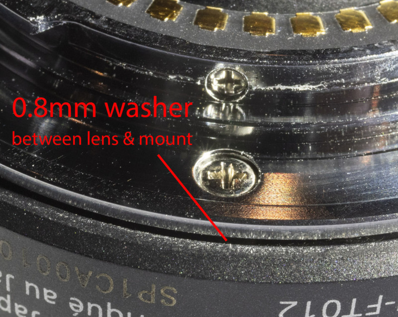

If you want a ready-made solution and are a Micro Four Thirds shooter, Panasonic produced (now discontinued but widely available on eBay) a 12.5mm f/12 3D lens for their cameras. It’s not great at photographing human-scale subjects because the lenses are so close together and the depth isn’t dramatic, but the lens can be easily modified by placing washers between the lens body and lens mount screws to act like an extension tube.
In fact, you can find lenses already modified for sale on eBay. This shifts the lens into a macro lens where the smaller separation is more applicable. This lens is capable of images like the following:

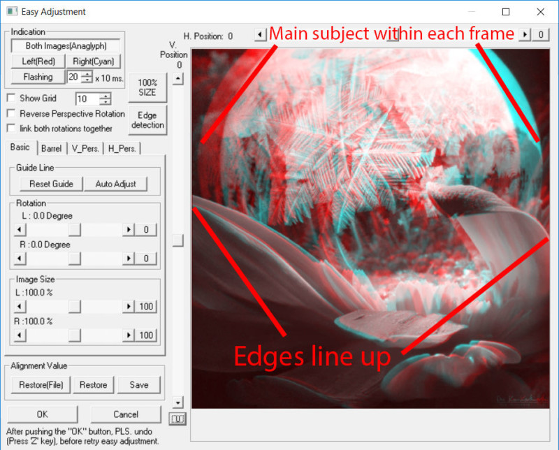

These images are all processed for proper alignment and framing in a free piece of software called Stereo Photo Maker that is still actively maintained with the latest beta released a month ago. Under the “Adjust” menu, auto alignment usually does an exceptional job at setting things up, and “easy adjustment” can help you fine tune the stereo window. The hardest part for me was understanding exactly what the “stereo window” is and how to define it properly.
It’s best to avoid something on the edge of one frame that is missing entirely from the frame associated with the other eye. This creates a ghosting effect that pulls you out of the 3D experience because that object is only visible to one eye. A proper “stereo window” tries to minimize these as much as possible. It’s not always possible to get it perfect, but trying to align the image such that the left and right details of the composition is what the “easy adjustment” tool is for. The software can then save in any 3D format.
